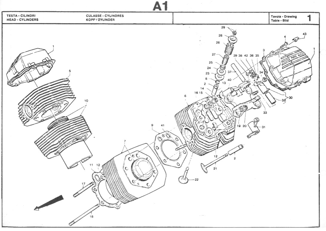

Here is the application.
Lower right in pic
Here you go. Hope it helpes
TOMB
« Last Edit: May 29, 2019, 05:35:47 PM by TOMB »

I've never seen square-fin rocker covers with vents, only vents in the heads that served the same purpose. FWIW, the early Cal II engine I bought for my "Ambovert" project had no vents, just a bump where they would have been.
The images that Hunter and TOMB are referring to are oil feed lines I believe, not vent lines. Guzziology refers to the bosses/bumps on the Cal 2 heads that Charlie refers to, and mentions that this is where a vent SHOULD be added. I did not read this section of Guzziology until AFTER I had re-installed my heads, and I don't want to pull them off now.
So again: Would an open-air vent in the rocker covers (thanks, Charlie!) help at all in venting some of the condensate in the covers, if the bike is used routinely for short-ish trips?

Offline TOMB
  • Posts: 1518
Re: Another vented-valvecover thread, Cal 2 version
« Reply #8 on: May 29, 2019, 08:10:26 PM »
No they are not oil feed lines what I am referring to they are the vent lines ,which are on the head ,the oil feed lines are also on the head in the middle either directly behind the spark plug closest to the tank ,or if you're facing the cylinder the top bolt that is buried down inside the cylinder head, those are the oil feed lines that works very similar to all the big block see the vent lines are behind those towards the rear of the head take another look at the middle of the heads.
Eariler round heads oil line is attached to the front of the head.
Oil feed in middle ,vent nipple to the right,(rear of head). Other side similar
Tomb

Online brider
  • Posts: 1588
« Reply #10 on: May 29, 2019, 09:32:11 PM »
Got it, I saw the oil feed lines in your image from the parts catalogue and didn't see the vent line next to it.
My heads do not have the vent nipples. Oil lines only.
