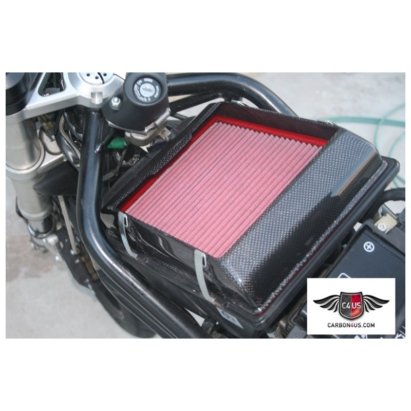

Hi There! try removing the K&N filter and installing an original Flat slide carbs react poorly if there isn't enough "draw" in the airbox. A GSXR suzuki with the airbox lid removed will not come off idle it will just backfire from the lean condition created. Ducati engineers spent a lot of time balancing the air intake to the carbs, the K&N may be causing issues. As previously stated if you can add fuel with the enrichner / choke circuit and it doesn't starve it isn't a fuel delivery issue. Shimming the Needles will only change the mixture at one point on the needles taper, CV carb slides are only fully open at high vacuum at roll on they drop to maintain constant airspeed in the venturi and return to approx mid way once the air speed has stabilized (hence the name constant velocity) The wearing needle jet is fairly common Dyna Jet needles cause the same condition they are harder than the jet so the jet becomes the sacrificial part. If you can't or won't replace the K&N a quick and dirty test is to tape off the air inlet 30% and see if things improve. As with all testing make some careful notes of "everything" you do lots of odd problems drag on because of details missed in the early stages of trouble shooting. FWIW

  These things will run with aftermarket airfilters... This is my 96 Monster 900....This engine runs flawlessly from idle to over 8000 rpm. There is no hesitation or flatspots.. The engine runs cleany for a Ducati at low rpm and you can cruise through town at 2500 rpm in third gear with almost no  lope...about 42 MPG...
   The hose in the middle of the air filters is the common carb vent...Around the battery you can see a steel/rubber line, there is one on each side from the carb vacuum chamber vents to the rear of the battery, dead air space...Performance Pro needle and nickle plated needle jets, stock #40 pilot jet, #150 main jet. most important, the float is set to 14mm on the rectangular shaped float half...5/16 fuel line with manual petcock,, stock vacuum fuel pump....

Thanks again everyone for your kind assistance in try to resolve my problem.To answer the last few questions,there is no charcoal canister on the bike it was removed by a previous owner.
   That's an interesting notion about getting to much air flowing to the carburetors ,Here's a picture of my air box as you can see a opened space with a K+N filter verses what  I assume is a normal stock, air box with much of the area is closed off except for those snorkels,I took this picture off of the internet.I will definitely try duck taping a good portion of the air box off to see if it makes a difference.I've got nothing to lose.

Randy, at the time the instructions I remember from Factory Pro were to remove the snorkels only from the lid of the box with the K&N.  But I recall others having the lid removal set up without having issues.  Its worth a try, but I doubt that taping a portion off will make a difference.

Hallelujah It's fixed!!!just got back from a 40 mile ride ,2 lane ,twisties and interstate,Wow! what a difference,it runs beautiful. Thankyou,Thankyou  To one and all, who helped me figure this crazy problem out .
  Today mcmuck provided the final piece to this puzzle I needed, with his posting,here is part of it;  Posted by: mcmuck
« on: Today at 08:53:31 AM » Insert Quote
(Hi There! try removing the K&N filter and installing an original Flat slide carbs react poorly if there isn't enough "draw" in the airbox. A GSXR suzuki with the airbox lid removed will not come off idle it will just backfire from the lean condition created.)
   My bike didn't have a cover over the air cleaner at all when I got it,I suppose I thought they all came that way.But after reading his post I researched the innerweb and found out different, they did in stock mode use those covers ,so  I copied the design of an original cover for a 900ss ,took me all of 10 minutes to make.The bike runs flawlessly right through the rpm range.It's scary fast,no hick ups anywhere.Blows right up to red line with no problem.(To be honest I have lost some of that wonderful low end grunt,It gets there, but not as quickly as before.(probably needs a little more air, ha ha )I know I can live with that trade off.Man was that a bugger to figure out,I knew there wasn't a fuel delivery problem,and the carbs were squeaky clean,the ignition system checked out fine,I had the carbs adjusted and balanced to perfection,they were in specs as far as jetting and all,I just couldn't figure it out,but now its all good.
I do have a couple questions though ,
  1) someone who knows, needs to explain how this is possible,shrinking down the intake volume of air can help an engine run better?
  2)does anyone have a Ducati 900 air box cover with snorkels ,that is unmolested they will sell me ,I doubt my card board version will hold up for very long.
What a great resources this forum is.Thanks again Randy

 This is interesting , my bike and the OP's bike with the same engine  I believe,mine has the V2 stamped heads .His needs the stock airbox to get it running sharp...My runs sharp with no air box..  Something to think about...
In my experience jetting another ‘97 SS-CR, identical to this one, removing the snorkels has a noticeable leaning effect and removing the airbox lid has a big jetting effect.  If the bike isn’t jetted to suit, it won’t run well.

I would look to getting bigger jets and a exhaust to unleash more power. I have had 4 ducati's, including a 2 valve air cooled bike with carbs and all have had either Ducati Performance open airbox lid that came with the full termi system or a aftermarket jet kit and instructions to drill a bunch of holes in the factory airbox lid. All ran great - no issues revving out.
looks like this but not carbon -
« Last Edit: July 03, 2019, 03:12:48 PM by Rusnak_322 »

  • Posts: 28798
Re: carburated Ducati 900ss starving for fuel at 5000 rpm -FIXED- !!!
« Reply #59 on: July 03, 2019, 03:33:58 PM »
Randy.....fiberglas s your cardboard lid and spray paint it black.  Glass matting, resin & activator w/black paint has to be less than the used Ebay one.  Guzzi content.
