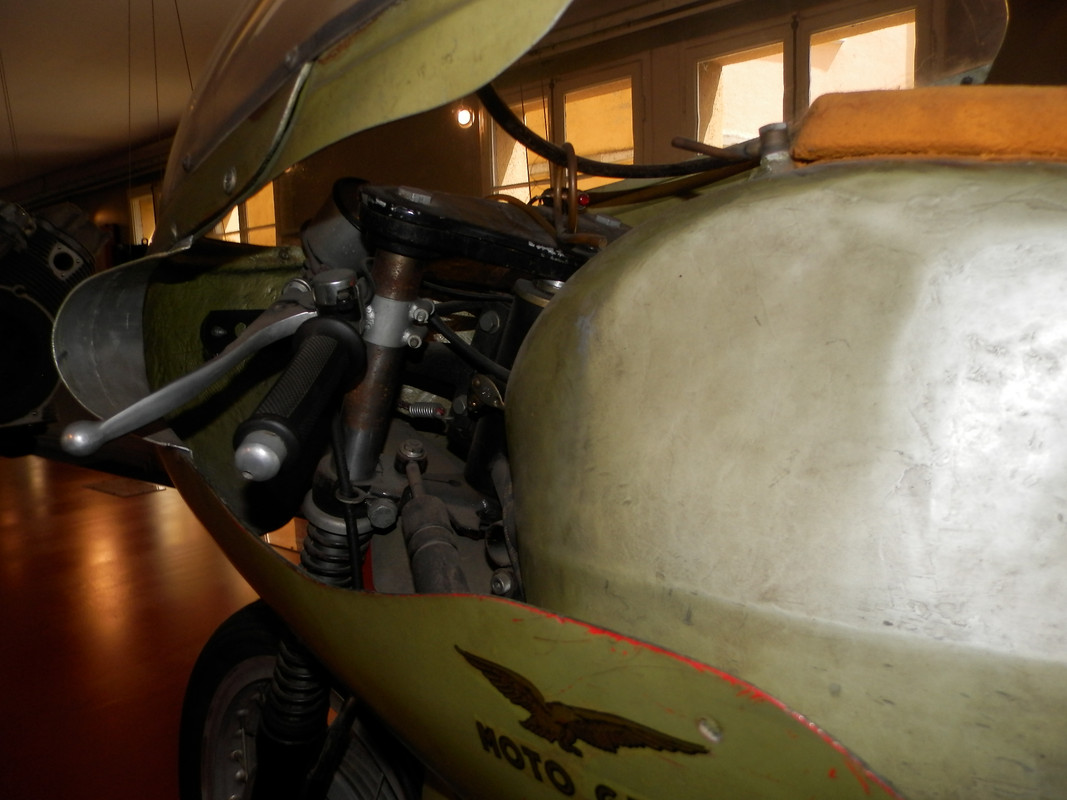

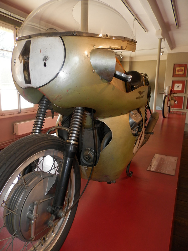

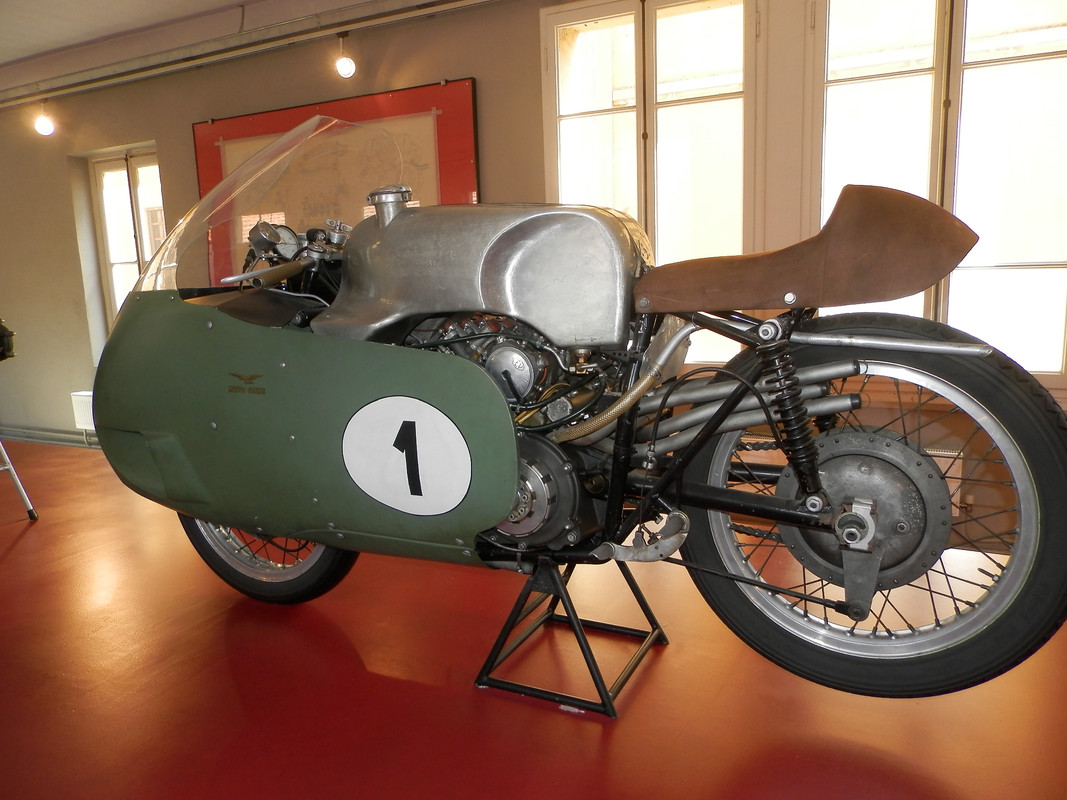

Nice work Clint, cominga long real nice :thumb:
are you going to make the fairing to match?
I can hardly believe I took this picture back in 2013, where does the time go?

I'm not sure.  We were talking about it today.  Fairings on a bike in a small shop are a drag, but i do like the fairing.  will probably make one eventually.  There are a lot of other things needing address first.
Edit- I didn't realize those were YOUR pictures, Jim.  Thank you for taking them and letting them get out into the Internet realm. They have been a significant resource for this project.

I hope you can make the fairing one day, it would be great.
I kick myself for not taking many, many more pictures of the museum bikes, I took a lot of pictures of the V7 Sport because that was the bike I was restoring at the time but I sure wish I had taken a couple hundred pictures of the various bacon slicers and race bikes, I need to get back to Italy and the Guzzi museum, hopefuly next year....
Italian panel beating is ART in itself

I’m not happy with the tank top, in terms of comparison to the World Record bikes.  I’ve taken some artistic liberty, but now it’s not what I want it to represent.  The spontaneous character of the original bikes is what I want to capture, but. It’s hard to be accurately spontaneous on purpose….  I also want to add some baffles to benefit handing, which would be difficult with the current one piece top.  Mad Genius Allen Millyard did a similarly-shaped tank for his replica Honda RC 250-6 build, which he fabricated & assembled in a different order to facilitate the installation of baffles.  So a full rework had become the plan.
This morning, I was surprised with a large group of pics from Canuck750 Jim Carey in my email inbox.  He generously took time during his current Mandello Anniversary trip to get many new pics of the existing original World Record bike in the factory museum, including many details I had yet to clearly see.   One shows the rear of the tank being much more narrow than I previously understood it to be.  So a serious rework of the tank is now even more palatable.
These pics will be indispensable to the project and are sincerely appreciated.  Thank you for being a friend, Jim.
