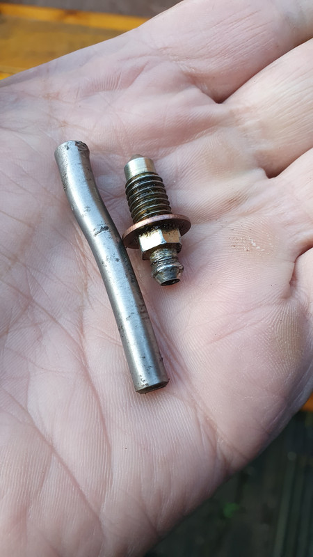

 Well, I thought I was ready and I read every post I could find on stator removal and decided to just make the pin that is inserted into the center shaft, then reinsert the allen head stator bolt to put pressure on the taper and rap it. It comes right off, right?
Well mine won't come off and I can't get the home made extractor pin out.
 I think the steel of the pin may be too soft and it may be bent in there, but I hope not.
 What next, now that I have screwed it up?

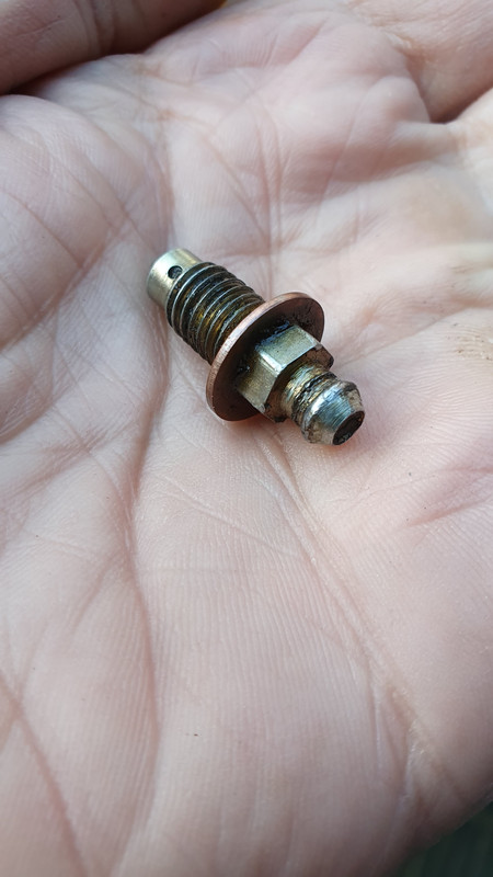

I am a bit confused. Stator = stands still. Is the outside parts which is hold in position by 3 M5 screws. Easy to remove.
Rotor is the rotating inner part, which is removed by extracting it out using a HARDENED STEEL pin + the original bolt. Screw the bolt fully in and apply a hammer blow on the head(of the screw).
If you have used SOFT STEEL, then sorry for you. You might have big trouble to remove the soft steel part.
The gold long hardened special M8 screw fully left in the picture), is made by me for this work.

I think everyone has tried that approach, very few succeeded. If all mention of it could be erased from history, I'd do it.
The pin is now jammed in the end of the threaded crankshaft. Hope the threads are ok.
The rotor is held on mostly by the taper - it's a taper fit and requires a good blow usually to break loose, but a puller will do it too. That's what the proper tool is all about. But a regular gear puller at this point won't work since there's no way to push on the crankshaft end. The only solution now is the slide puller.

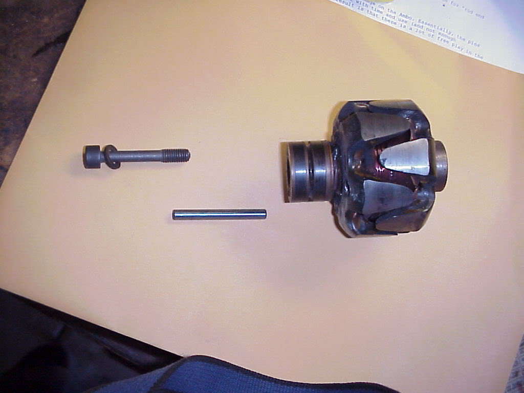

OK, here's the tool.  An original rotor bolt welded to a threaded shaft that fits my slap hammer.  Screw this into the rotor.  Get the wheel and fender out of the way.  Use the slap hammer to yank the rotor off the nose of the crankshaft.  The residual piece inside the hollow crank will likely come out easily unless you have really done some bad damage.
Now you know why the factory pin tool is made from a hardened shaft.
Give me a PM with your postal address so I can send it along.  Find a slap hammer that fits the pulling thread.

I sent this as a PM to the OP but then I thought there might be some others who are new to Guzzi and need to know how this alternator system is attached.
You made an extractor 'removal pin' of soft metal.  What dimensions did you use for that tool?  The length is critical.  Here are the dimensions of my factory tool:
5.97mm or 0.235" diameter by 52.57 mm or 2.0695" length
Are  you certain you know how the factory pin tool works?
Look at my photo above again.  See the length or number of turns of thread on the business end?  Important number of threads.  I think about 10-12 turns.
For a NORMAL INSTALL of the rotor:
Look inside the rotor body itself and you will see it has about 8 turns of internal thread.
Look inside the nose of the crankshaft and you will see about 8 turns of internal thread.
Put the rotor onto the tapered crank.
Realize that you now have TWO sections of internal threading but they are not continuous.  There is a significant blank, unthreaded internal space between the rotor's internal thread and the crank's internal thread.  That blank space is longer than the threaded portion of the central bolt.
Insert the central bolt and it impacts the internal threads of the rotor.
Spin the bolt in until ALL of the bolt's threads pass through the rotor and they now reach into the above described empty space.
The bolt is now free to spin and free to move slightly fore and aft.
Push the bolt in further until it impacts the internal threads of the crank.
Turn until the head of the bolt sets in the recess at the front of the rotor and tighten appropriately.
For REMOVAL of the rotor:
Note the internal threading descriptions as above.
Insert a properly dimensioned factory extractor 'pin' tool or a suitably HARD substitute.
The extractor pin tool must be long enough that its outer tip is outboard of the crankshaft internal threads and thus prevents the central bolt from ever reaching into the crankshaft internal threads.
Insert the central bolt and turn it in until it abuts the end of the extractor pin tool.
Tighten substantially to set up an internal pushing force to force the rotor to 'pop' off the crankshaft.  It is held only by taper friction, but that can be quite substantial.
Most have found that the rotor will not pop and thus a judicious hammer whack on the rotor body or central bolt may be the extra vibration needed to release the rotor.
The rotor will fall, so be prepared with a soft place to fall.
If your extractor pin was not sufficient length, that might allow the central bolt threads to reach in and grab the first few internal threads of the crankshaft.  Doing so would create a crushing force against the extractor pin tool but never apply any outward force to release the rotor.  Bad juju!
If your extractor pin was not HARD enough, it might bend or 'mushroom' inside the crank before providing enough force to pop the rotor off of the crank taper.
Someone makes and sells an extractor tool with bolt threads and the proper length extractor pin all in one piece.  I don't recall who.
Rotor, bolt, and factory tool in one pic:

Offline theoneandonlymin
  • Posts: 60
  • Location: Norf Landan
Re: V1000 G5 Stator Removal (again))
« Reply #27 on: January 17, 2020, 04:40:08 AM »
Here you are from my special tools tin.......
8mm x 1.25 grease nipple.
Wind it in , pump it up, off it comes.
Hopefully.
Cheers
Min

Offline Groover
  • Posts: 2914
    • Scooteropolis
  • Location: Columbus, Ohio
« Reply #29 on: January 17, 2020, 07:46:00 AM »
hydraulics.. who would've thunk - great tip!
