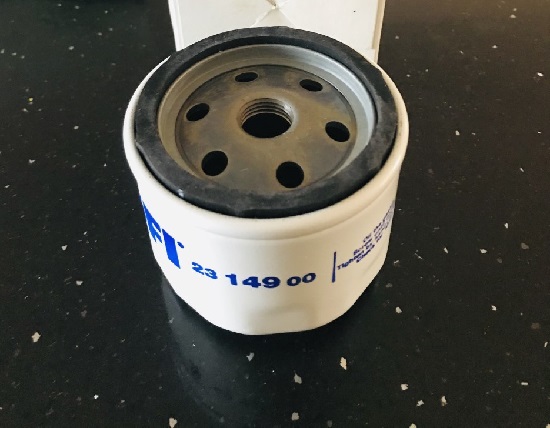

I read about the oil filters loosening or some such thing and a hose clamp was recommended to stop it doing so by putting the head of it up against the pressure relief body.
I ended up with two oil filter pans, the first thing noted on both was the threaded spigot that holds the oil filter in place was well down in the cavity it resides in, that in turn mean't the oil filter all but spun on a turn or so until the rubber seal touched down on the outer pad ring of the sump.
No wonder there is a risk they can unwind in use and the clamp is recommended.
What I did was face the surfaces for the pressure relief, oil filter threaded inner spigot and plastic filter screen, after that I lowered the outer ring for the filter until it actually screwed on (About 7 mm with seal compression)
I had tried the new screen with the stock M6 bolt and it crushed it so it was milled lower so a upside down top hat could be used with a custom M6 stud, top washer and Nyloc.
Of course being a non oil filter engine it needed custom M8 to M6 step studs which makes gasket fitment easy as a bonus.
The cheap seal on the HMB pressure relief was binned and a new one made with a thread to match to maximise the ID.
After all that I still used a new hose clamp on the filter...  I can't see it falling off.
If the pans I had are the normal a hose clamp is probably a good idea.

Re: Hose clamp on oil filter?
« Reply #27 on: April 17, 2020, 04:40:38 PM »
Wayne - are you saying you don't use the hose clamp? That it's really not necessary?
LesP - Seems to me a new fitting with longer reach would be the answer. Then three or four turns and tighten down like we do for the car. I've never had an automotive filter come loose.
Wirespokes, thank you, finally someone who gets it, if the oil filter actually screws on it will not come loose.
In my case it might have gone on a turn and a half as I got both sumps/pans, on a 2 mm pitch thread (iirc) that is only 3 mm thread engagement.
The threaded spigot is simply to short unless there was once an oil filter as standard fitment that had a lowered threaded section to engage the deeper to the spigot.
I had considered machining a longer spigot but the sealing pad surfaces needed facing anyway so just removed more (maybe 4 mm)
The filter goes on at least 3 turns like any other automotive filter now after modification.
Here is the UNI filter as recieved from MG Cycle.
The inner threaded porting is recessed compared to the outer sealing ring, that means to engage the threads of the sup spigot, the thread would need to be some 12 mm (1/2") above the outer sealing ring.
Either I got sent the wrong oil filter from multiple venders or the stock fixing arrangement from the factory was floored.
There is no way I am the only person (Who has never ridden a Moto Guzzi ) to have seen or come across this.
What part of the filter does not screw on enough and risks loosening is being missed ?

Well, this was kinda my thought. I suppose gravity would cause it to just slide to the base, but still the thought of the clamp coming loose inside the sump isn’t a pleasant thought to me. I will be flinging the bike around up in the mountains.
But having read about the short threads on the fitting as noticed by LesP gives me enough pause to fit it back on there. I may take it by the machine shop if I have enough time. There’s a great one here in Carrollton.
I’ve just never had a filter work itself loose on any vehicle I’ve owned. Not even a drop. And I never tighten down more than recommend. Hence why I was wondering.
Great insight guys, thanks!
I would be very curious to from the point the oil filter catches on the spigot thread does it take to seat in full turns.
I am not suggesting everyone should go out and machine the sump or get a longer spigot machined but this being my first Moto Guzzi and stripping it down to the last nut and bolt (let alone cutting the breather box open) I have no preconceived notions........ I work on it, I see things ??? this short thread engagement did not seem right and it (in what I found with a new UNI filter) pretty much explained why people were fitting a hose clamp.
Was the oil filter for these bikes different back in the 1970's when the oil filter pan was added to the range ?
(The difference with the bike I have is being a 1973 El Dorado it had no oil filter as standard but the un-drilled galleries were in the engine case/block casting so Moto Guzzi was obviously thinking about it before adding it)
I did the usual machining to those passages, added a oil filter front bearing etc etc but probably looked at things closer based on that modification.
