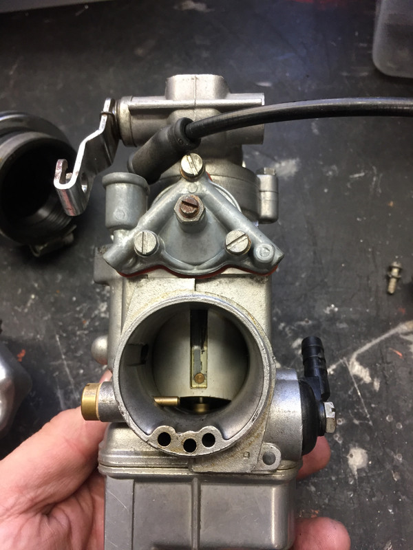

I have been trying to get this newly rebuilt engine running for a few days now and I'm at a cross road.  Just for background, rebuilt engine with new Raceco P3 cam, original 36mm carbs that I rebuilt and I'm running points because the Dyna black box was a problem, which has been sent back to Dyna.  I have checked the flywheel timing marks with a degree wheel and the retard mark was slightly off so I relocated the distributor based on that new mark.
This is what happens, the bike will start with starter fluid and immediately go to redline, and restarting will happen if I cover a carb mouth.  I have disconnected the chokes and both accelerator cables with the same result and the slides are not hung up and it is both carbs as I've pulled a plug on one one side then the next with the same race to redline. This race is like seconds and then I kill the engine.
Tomorrow I'm just going to pull the carbs from the 1000S and see if that solves the problem. I haven't pulled the carbs to look at what is going on inside but I just want to narrow my problem by installing a known non-problem set of carbs.
Any suggestions?

Re: Lemans I Starting Issues
« Reply #12 on: May 11, 2020, 08:35:01 PM »
Hmmm, sounds some what like to problem I had with the similar carbs used on my Laverda 750 SF, this picture from my LeMans rebuild
The LeMans carbs gave the bell crank tops, the Laverda do not but the placement pf the slides with the plastic guild tang, the spring location etc, is a bit finicky.
I messed with the Laverda carbs for a year, installed all new internals including the dreaded new slides with the small ramps and finally fist installed a brand new pair of Dellorto carbs. I would seriously consider just installing a new pair, the Dellorto's just wear out but that should not be the problem you are having. To be at full throttle the slides would need to be wide open. Have you visually confirmed the slides are at fully shut position (less a tiny opening for idle) ?
I don't think this has anything to do with full throttle but have you set the float height with the carb mouth on a flat surface, floats vertical?

“To be at full throttle the slides would need to be wide open. Have you visually confirmed the slides are at fully shut position (less a tiny opening for idle) ?”
I don’t have filters or the velocity stacks on the carbs and at rest they look just like the ones above.   If the carbs on the 1000S work, then I’ll play with the existing carbs some more but I’m sort of resolved to getting a new set of carbs which I really don’t want to do but it has to run right.

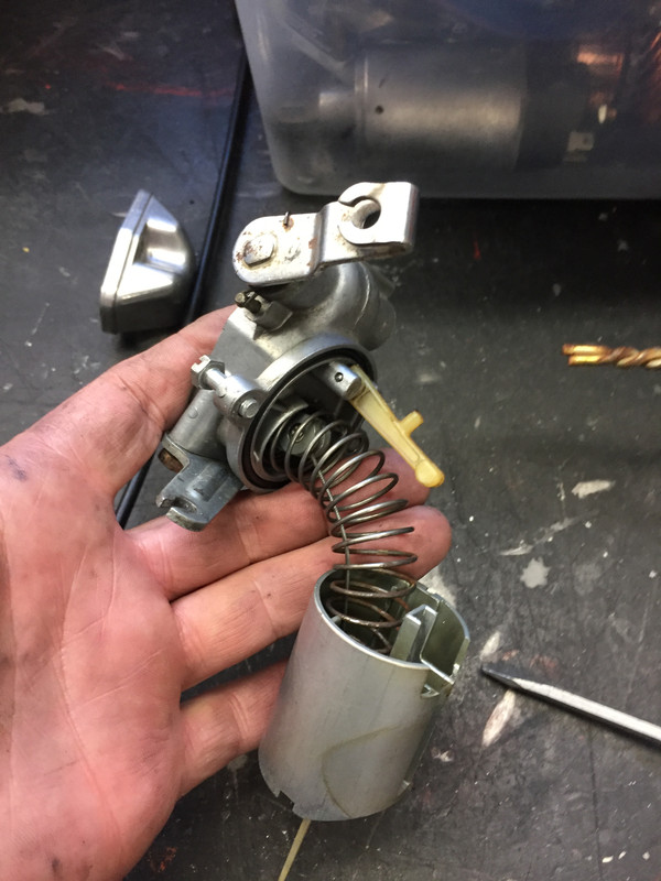

OK, I pulled the slides and the ones in there are not modified as they sit about 12mm above the tunnel whereas the ones in the 1000S are 6mm above the tunnel at rest.  I’ll modify the slides and that should address the high RPM but will that cover the entire problem?

 A picture they say , this is from my Le Mans 2 with 40 mm dellortos . This is a picture of the throttle slide
position at idle ( it idles well ) . If yours is more than a hair higher than this , it MAY be part of the trouble .
