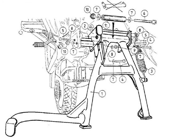

I do not have central stand in my bike (I know that those can be found, not being cheap). Would that be still wise purchase? When you'll use/need central stand?

Arctic Fox -- I'm going to recommend you spend your "lift" money on something for the garage and on a SPOT Gen4 for the road, not on a center stand.
First the road.  My experience with a center stand on the unpaved surfaces for which you are buying ADV tires is the two legs sink below the surface, typically at differing rates.  A side stand with a block of wood, etc works much better for keeping the motorcycle upright.  So the center stand would be unneeded weight as well as making the underside of the motorcycle more complex to support.  And if you get a tire puncture or something significant that's what the SPOT is for.
Next the garage.  Something that keeps the motorcycle upright when changing fluids, removing the gas tank, adding accessories (of which you have plenty), and similar activities is very useful.  The basic choice is whether or not you need to remove the wheels.  My understanding is you are limited to the motorcycle dealer or tire specialist for mounting tires.  If you are required to take the motorcycle to the dealer or specialist, you don't need a fancy stand.  If you are allowed and prefer to take just the wheels to the dealer or specialist (like I do) then a more capable stand is needed.
Beyond that I have no recommendations.
