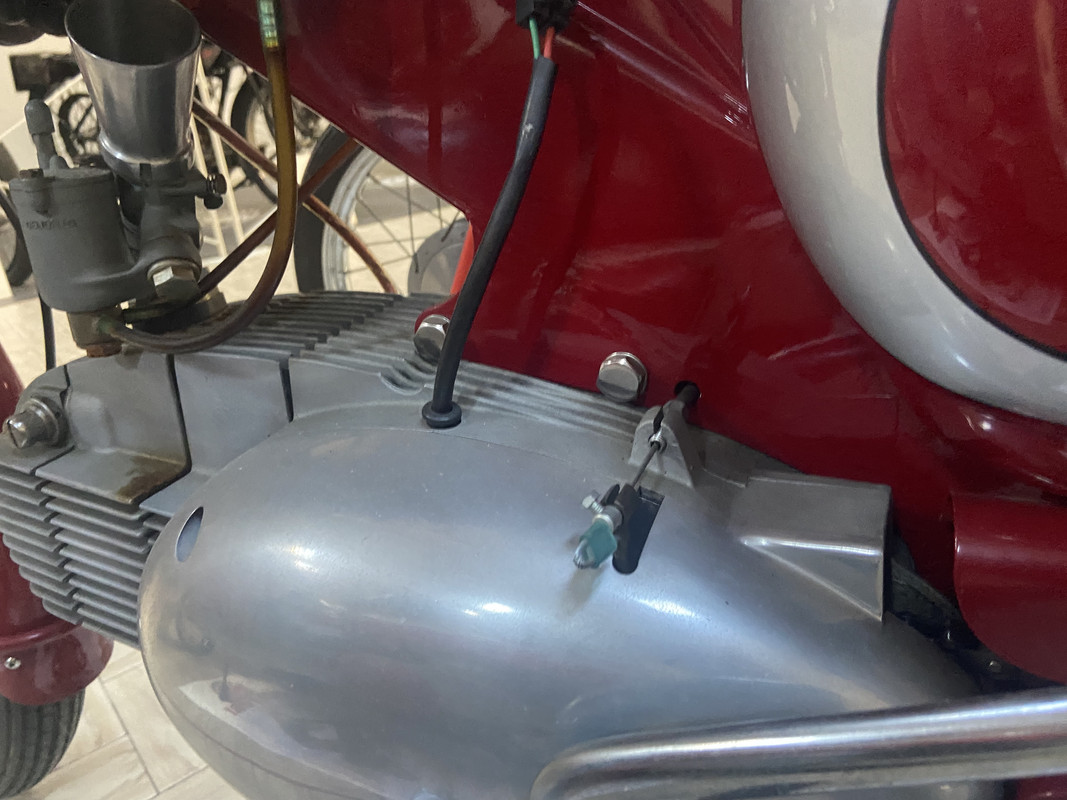

Very cool- I like them, Jim.  That’s the whole point of having the machines in the first place.
On Sat, I did similar work making a couple of spacers for the slightly long throttle cables on my CX.  Eventually, I’ll shorten the cables but didn’t feel like that much fiddling work at the time.

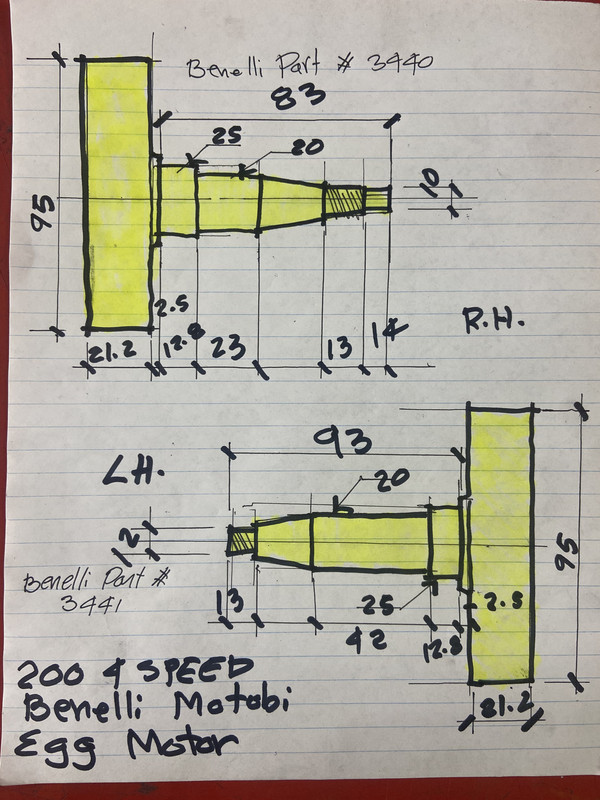

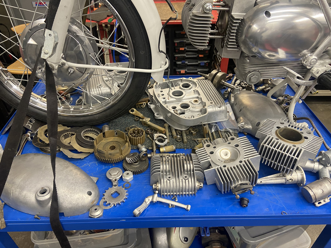

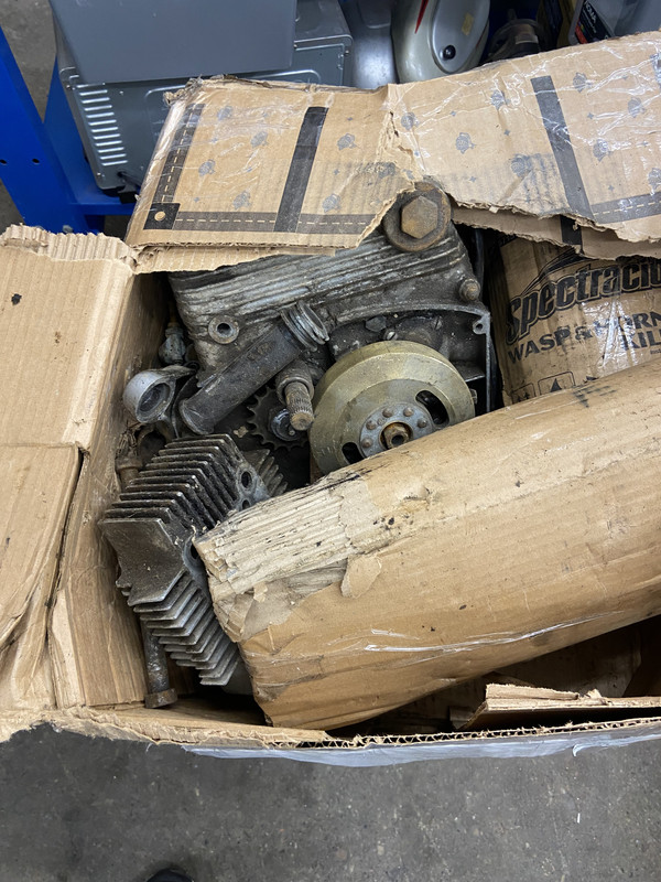

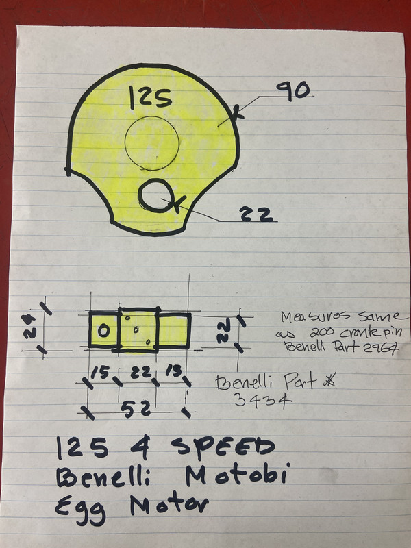

The 'before' picture, a big box of joy arrived via UPS this week, a box only a gear head could love
The engine sat in the ultrasonic cleaner overnight in Evaporust, it was pretty clean this morning but neither the crank pinion gear or the magneto were in the mood to leave the engine behind despite my best coaching with pullers and a big impact.

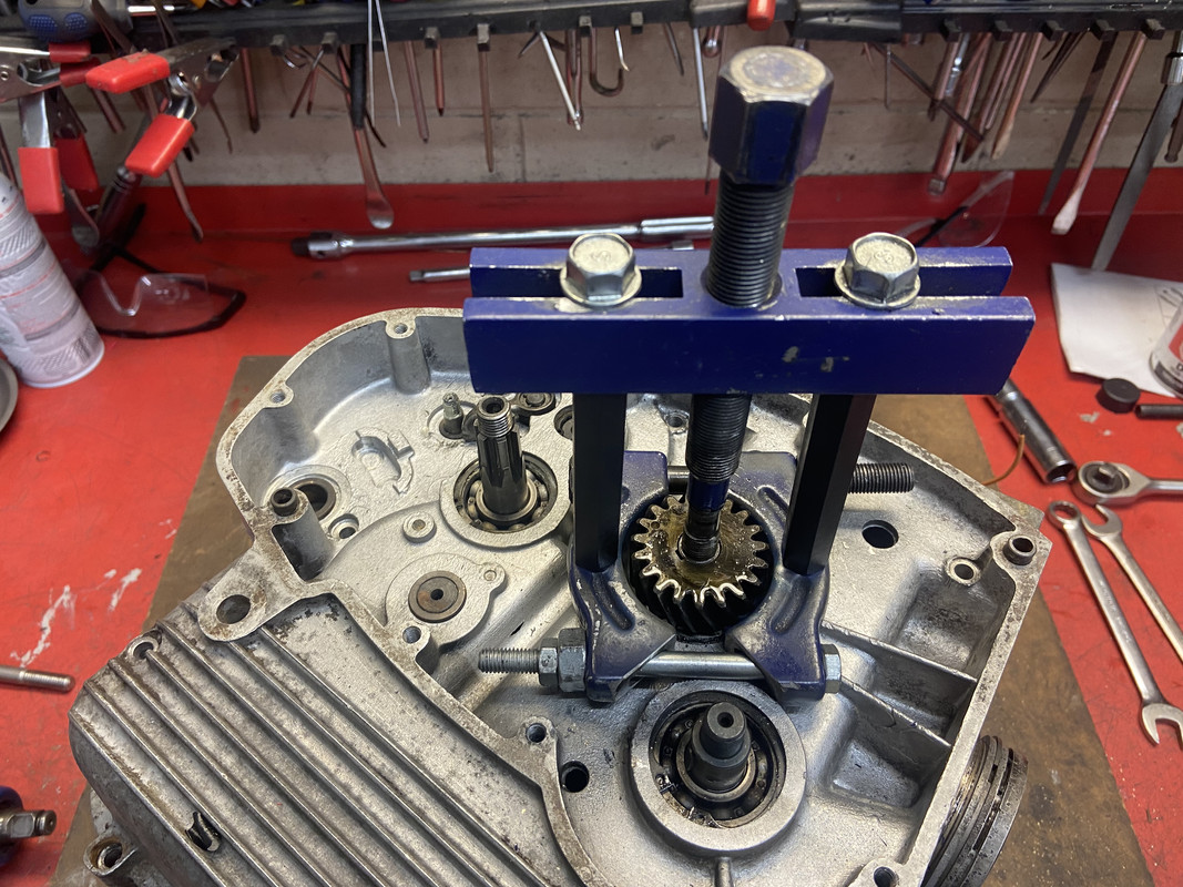

The magneto did eventually come free with a lot of small taps with a brass hammer on the end of the puller bolt torqued down as much as the impact would deliver, it came free with a thud, shot up a couple inches and gave up.
The crank pinion was another beast, one of the puller leg threaded studs snapped clean off from the pressure but the pinion did not budge.
After replacing the puller leg I took the block to the welding table, crossed my fingers and struck up the oxy/acet, a slightly carbon flame and with the puller cranked to the nines I touched some heat on the gear, bang, almost immediately the puller and gear literally flew off the crank shaft end and fell to the floor. Success!

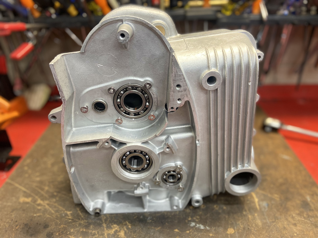

The crank feels real good, it was the crank I needed most for another engine, stator and magneto and some gears and hopefully I will finally have a complete 200cc motor for my Beneli / Motobi build.
Everything stripped and vapour blasted, lots of parts to now sort through and pick the best between two motors

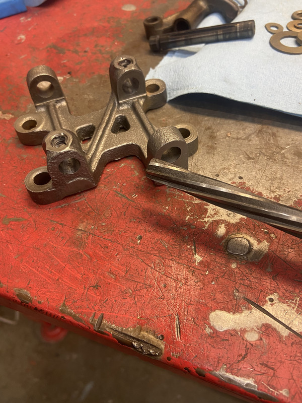

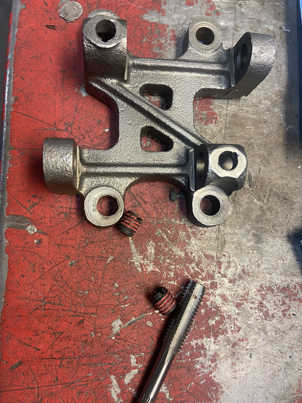

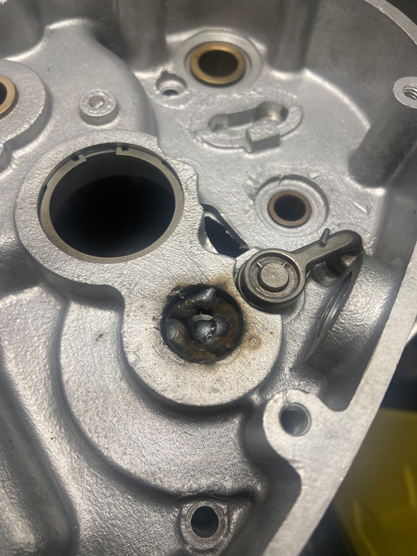

Another stuck part, the rocker pins are secured into the cast body with set screws, these small ( M 5) set screws have a pointed end which mate to a groove in the dowels. The dowels are not moving smoothly, probably rusted and full of gritty oil.
The set screws are stuck, really stuck, I drilled out the staked edges of the screws, tried tapping, tapping ... and more trapping, penetrating fluids and finally heat, no way they would budge. I clamped the casting in my mill vice and drilled out the set screws, I used an 8 mm diameter end mill, it will work with the 6 mm steel inserts I have.
tapped the cast body to take the new steel inserts
screwed the inserts in, then using a 10 mm end mill cut out the section of the insert that fell below the 11 mm dowel pin opening, then used a 11 mm reamer to get the correct finished opening
I made new 6 mm set pins from a 6 mm x 1.0 stainless steel bolt with the end turned down to a point
marked the depth with blue marker, then cut off the bolt and saw cut a flat slot into the stub
red locktight to secure the new set pins, pre-oiled the pins and reassembled the rockers and sprung washers
One more part ready to reassemble.

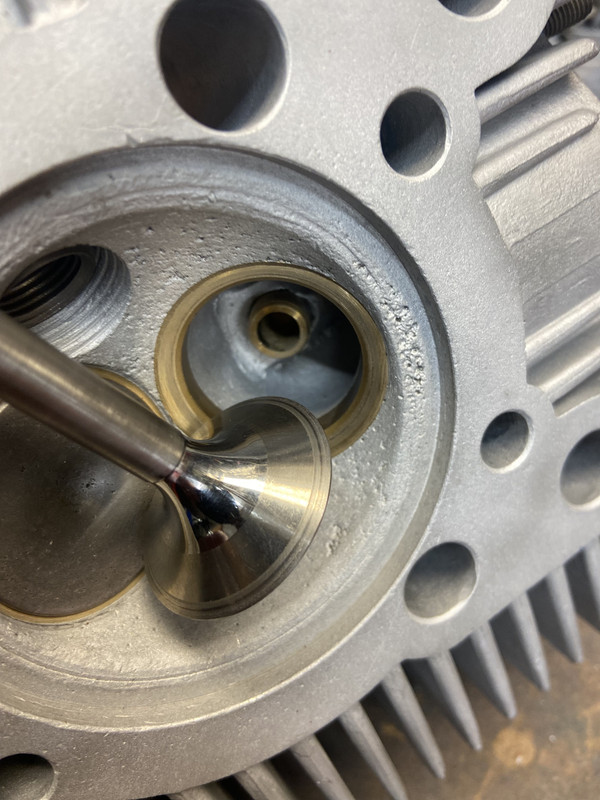

I am going to try and make up new bronze valve guides, the guides are so badly worn, the motor must have smoked like crazy when it last ran.

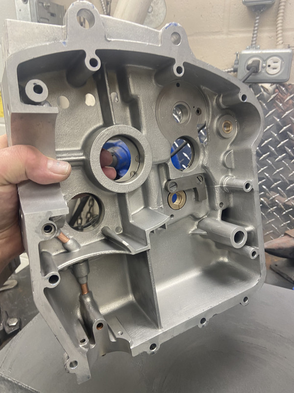

One last bit of work on the replacement crankcases, Benelli used a couple roller bearings in steel cases for the cam support, earlier versions of the motor I have used caged rollers open on the inner and outer faces. These steel cases seize to the steel bearing supports, not an ideal design but I am sure Benelli never thought these old nails would be brought back to live some 55 years on.
The steel cases would not budge so I poked the rollers out and used my MIG to weld a healthy bead along the circumference of the roller case and across a face to knock it out.
Let it cool and it pokes free with little effort
I found a listing on eBay for a company in the UK that will make any valve guide, I ordered four, they will run me about $40 a pop all in. I can barely buy the stock guide material for that price. I sent them this sketch to make up new guides. I found a 7.5 and 7.48 mm reamer on eBay from China for cheap to finish the guides to my used valves. Based upon factory tolerance I should finish to 7.48 based upon the slight stem wear of the valves.

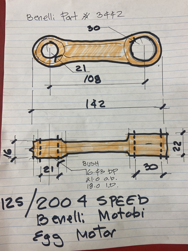

I pressed the con rod small end bush out of the replacement crankshaft I picked up. Glad I did, not only is the fit to the piston pin sloppy but the bush is cracked.

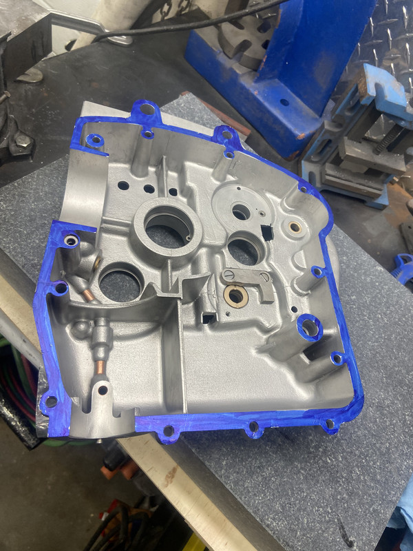

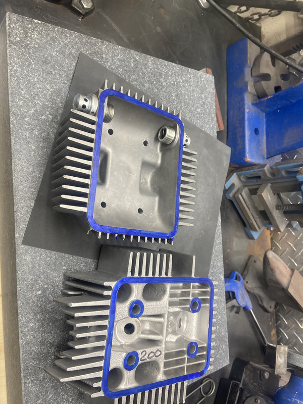

I found a big surface plate, new at Busy Bee Tools in Canada for under $90! 3" thick X 12" x 18", a bargain. I had been waiting for over a year for one to come in, all the others were apparently scoped up by a company that makes headstones for pets, I guess a nice big piece of granite is not cheap, no idea how they can sell these for so cheap.
I coated the surface with valve lapping paste and a couple of minutes of vigorous figure eights and back and forth and the surface is smooth, I did all the gasket surfaces and lapped the head top cylinder as well.
I surfaced smaller parts with a sheet of 400 wet and dry paper

I can finally say with confidence I understand the differences between the Benelli 4 Speed 'egg' motors; 125, 200 and 250 cc.
The rumor I have been told a couple times is that all three share very similar bottom ends, this is only partially true to the extent of the transmission parts, even the cases are slightly different across the range. For example a 125 and 200 4 speed motor share the same frame mounting bolts, the 250 has a different lower frame location point.
125 and 200 cases are very close but there are differences in the type of small diameter needle bearings used between the two, including the depth and bearing covers.
My point, which I have now learned the hard way, is that not much actually interchanges with the bottom ends other than a 125 and 200 share the same con rod but the crank webs are not interchangeable.
When Its all said and done I have accumulated a 125, 200 and 250 motor for a 200 bike! One day the 'other' engines may find a home in a chassis.
Nerding out here but for the recorded here are the measurements and diagrams I did to catalog the bottom end differences in my quest to find ONE good crank.

My friend George, retired professional welder TIG welded replacement aluminum fins on my Benelli 200 engine case and rocker cover. This outer long fin was almost completely broken off, I have just a little bit of cleanup to do and the repair will be almost invisible
Four fins were broken off the rocker, again just finishing to do

I picked up the reconditioned head today from the machine shop, new guides pressed in and reamed to size and the valves reground.
I dropped the crankshaft off with a NOS crank pin and a new caged needle roller bearing I purchased from 123 Bearing in the UK - 30 mm O.D. x 24 mm I.D, x 15 mm width. I asked the machinist about the suitability of the bearing and he told me he uses similar bearings all the time rebuilding dirt bike cranks so I think I am good to go. Dry fitting the bearing ion the con rod with the pin felt great, almost no play whatsoever.
The 'new to me' pair of crankcases have been cleaned and all new bearings fitted, double row close fit ball bearings, standard ball bearings and cup needle bearings all purchased from 123 Bearing in the U.K.
I have sent the cylinder studs and misc bearing covers out to be bright zinc plated, I will hopefully have the bottom end back together in a couple weeks at the latest.
