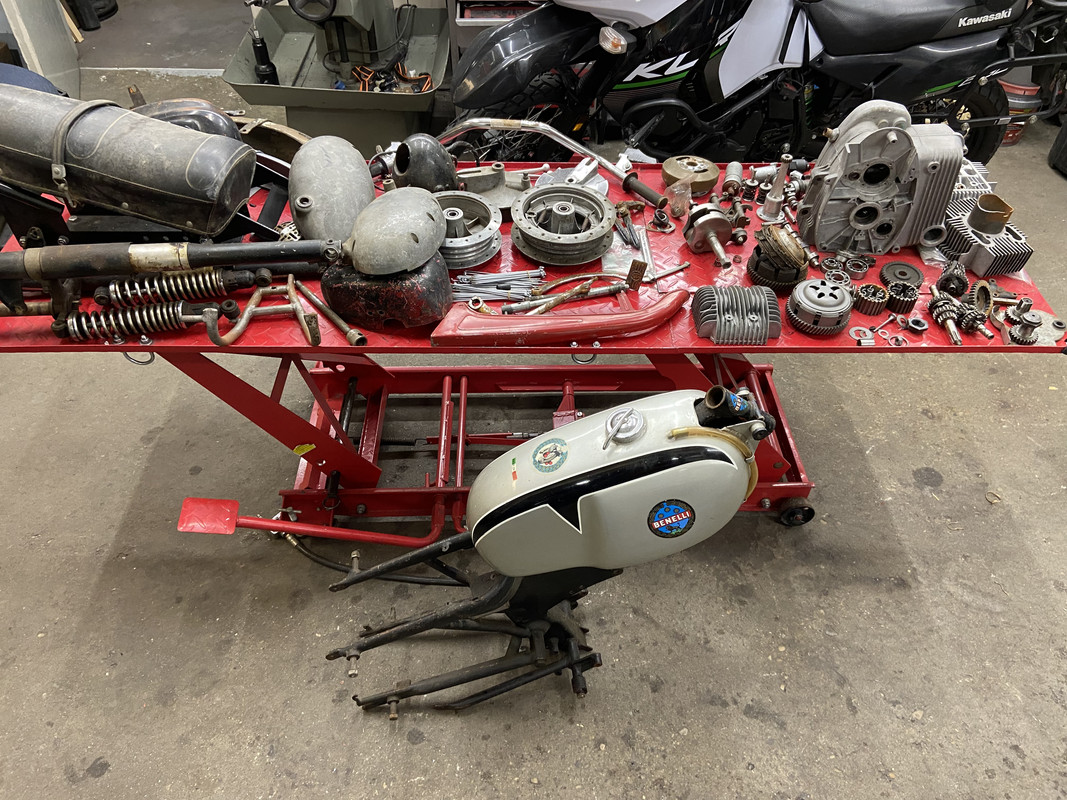

I am slowly gathering up enough parts to build a 200 Sprite, I plan on using the Motobi decals and rubber bits rather than the Benelli markings, all of the Sprite frames are actually stamped MOTOBI and in Europe I think the egg motor bikes were sold as Motobi's whereas Cosmopolitan had the bikes they imported marked as Benelli.
This is a Benelli Sprite, a 200 I think, a 4 speed 4 stroke single (5 speeds were also available)
In a typical moment of weakness I fell for an Ebay add listing an 'almost complete' Benelli 250 Baraccuda, after a lot of back and forth a crate came in the summer
After sorting and cleaning I found that quite a bit is missing or not correct and the bike is not a 250 Barrcuda, it is a 4 speed 200 Sprite.
Missing from the engine was the transmission shift drum and related bits, the rocker cover was damaged, the cylinder appears to be for a 250 but is overbored beyond spec. The front fender is wrong, the left side cover and chain guard are from different models. Missing a piston, exhaust and tail light, headlamp and trim ring and much more.
I sent the frame and metal parts off to get blasted and coated with powder primer. I found what I think is the correct front fender
I am starting to put it together as a dry build to determine what I have to find
I had a complete rear tail light bracket and made up a tail light form parts I had on hand
I found a seat cover in Italy (I think) and I have rounded up the MOTOBI stamped foot peg rubbers, my box of parts had a headlight and a
The head spark plug hole is stripped, used a steel rod to set up the compound angle on the milling machine, I drilled out the hole and fittd a new steel threaded insert
123 Bearings in the UK has provided all the ball bearings for the engine cases, great service, very fast shipping!
Mac Dennis in the USA has been a great help tracking down parts for me!
The rear hub is missmatched, I think some of it is for a 5 speed model and some for a 4 seed model, Mac is looking for the correct parts for me
Ebay has been a great source of NOS Benelli / Motobi parts, Santo-Di Moto-Cicli has a lot of the smaller parts, all NOS
Tracking down parts, especialy from Italy is a long slow process so I have multiple 'projects' on the go, all waiting for parts, I hope to track down the rest of the pieces over the winter and plan on getting it running then strip it down and get the painting and plating done.

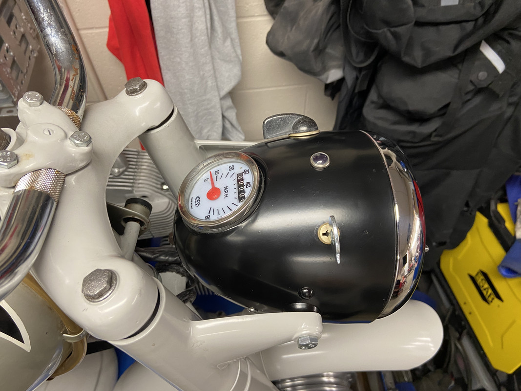

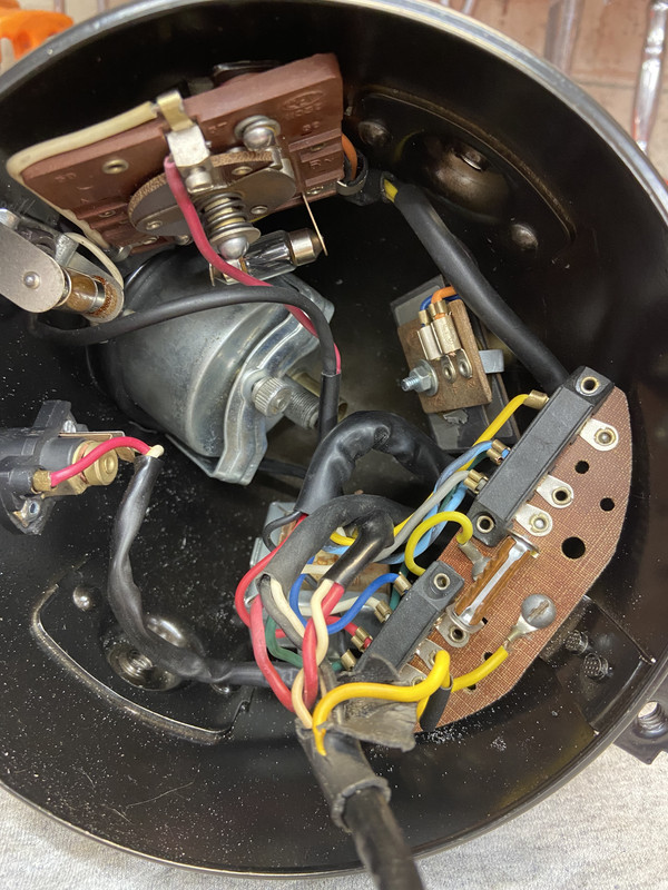

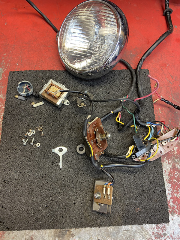

I stripped down the headlight bucket that came with the project, its a typical CEV all in one unit, 6 volts; headlight, ignition cut out key, headlight switch, headlight running light, speedometer, and inside the shell the electrical junction panel, regulator and rectifier. I had a NOS headlight trim ring and headlight in my parts stash to fit this shell.
Vapour blasted the shell, wiped it down with metal etch, then a wipe of acetone and powder coated it satin black.
I stripped down all of the components, the cut out switch was seized, its a very simple design, inserting the key and twisting it depresses a plunger that meets a contact that completes the circuit. By soaking the bucket with the switch intact in muriatic acid the rust bubbled out of the components and I was able to unscrew the switch from the shell then get the plunger freed up.
I had new plated screws in my stash that secures the regulator and rectifier, the light switch bakelight handle polished up a bit, same for the running light plastic lens
I bought a trio of small size speedometers a couple years back thinking one day they would come in handy, one of them is a perfect match
all done, I had to trim down the inner flange of the headlight trim ring to fit properly over the shell lip
back on the forks for now

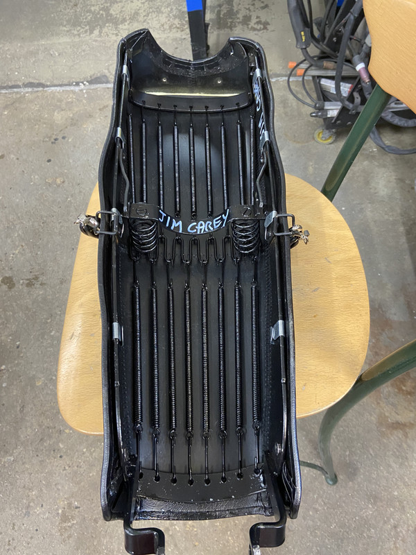

I also stripped down the seat and vapour balsted the sprung seat frame
painted it with POR-15 satin black, this stuff is sprayed direct to metal and once cured is almost as tough as powder coat (my oven is too small to fit the seat frame in)
I found a supplier in Italy for reproduction seat covers, they have none in stock for this particular seat but told me to ship him my seat frame and original cover and they will make a reproduction for me. I have bought seat covers for other small displacement Italian bikes in the past and the quality is excellent

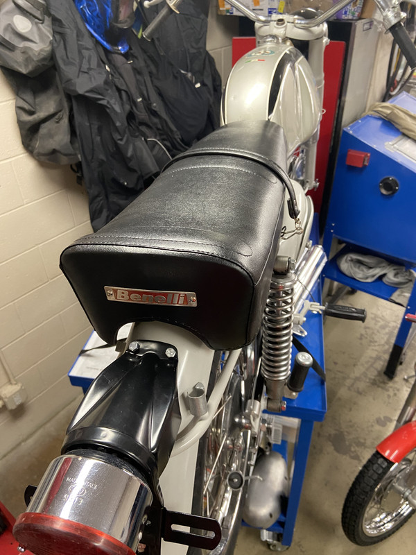

I got my Benelli / Motobi seat back from Italy today, less then three months turn around, even though I had cheaped out and shipped the frame and old cover by surface to the upholstery shop.
They did a fantastic job copying the old seat pattern, mounting to the frame and adding the grab strap.
they remounted the original name plate, I had asked if they could find a Motobi emblem but no luck, cocst me just over 100 Euro plus shipping there and back

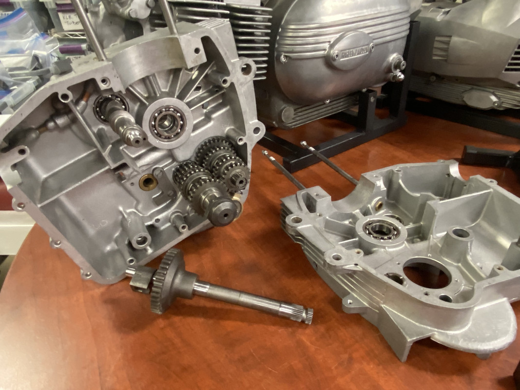

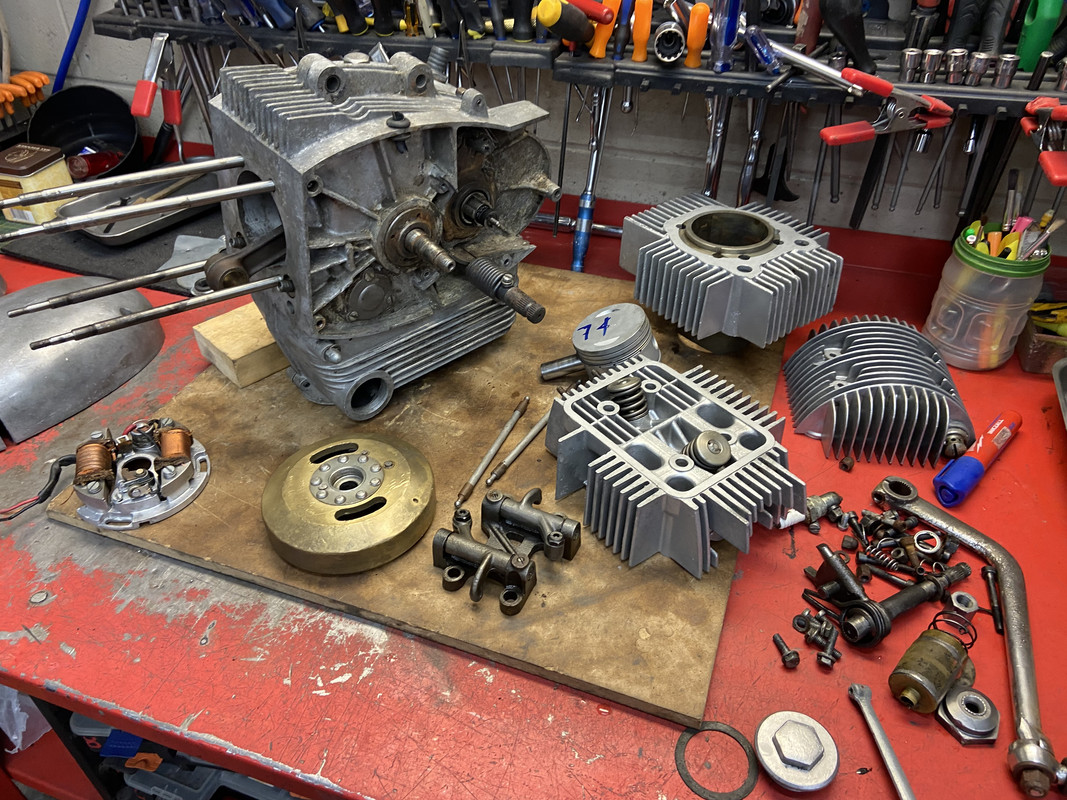

I have been making slow progress on my Benelli 200 Sprite, its been a long search to find a good sued crank shaft and a bunch of the small pieces of hardware, bearings, seals and gaskets, I had to make up some spacers and shims on the lathe but I am close to having a running motor, I hope.
The cases have been rebuilt with new bearings and seals, replacement crank, new oversize piston and the head is off to get new guides and a valve grind.

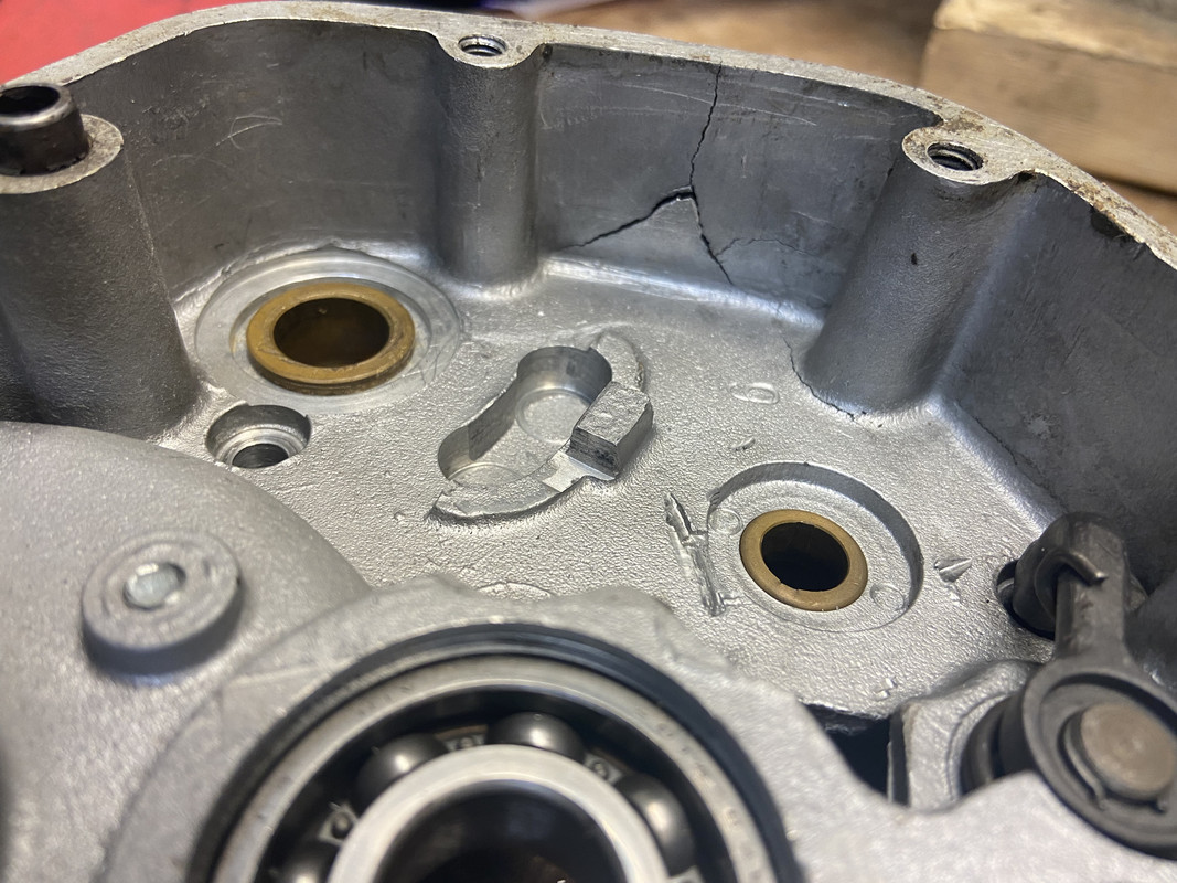

Found a crack in the case from where the bike probably went down on the right hand side and the kick start shaft pressed against the retaining bush, my welder friend touched it up and it will be solid
Benelli does not call for a center case gasket but I fond the shafts bine without one so I made up a gasket and now the gears and shafts spin free
unique clutch pressure plate attachment and the basket springs actually tread into the basket, the spring pitch is M12 x 2
The stator plate and coils are a mess, will probably need to have thrm rewound

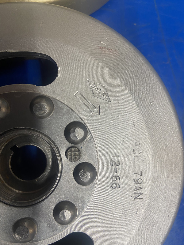

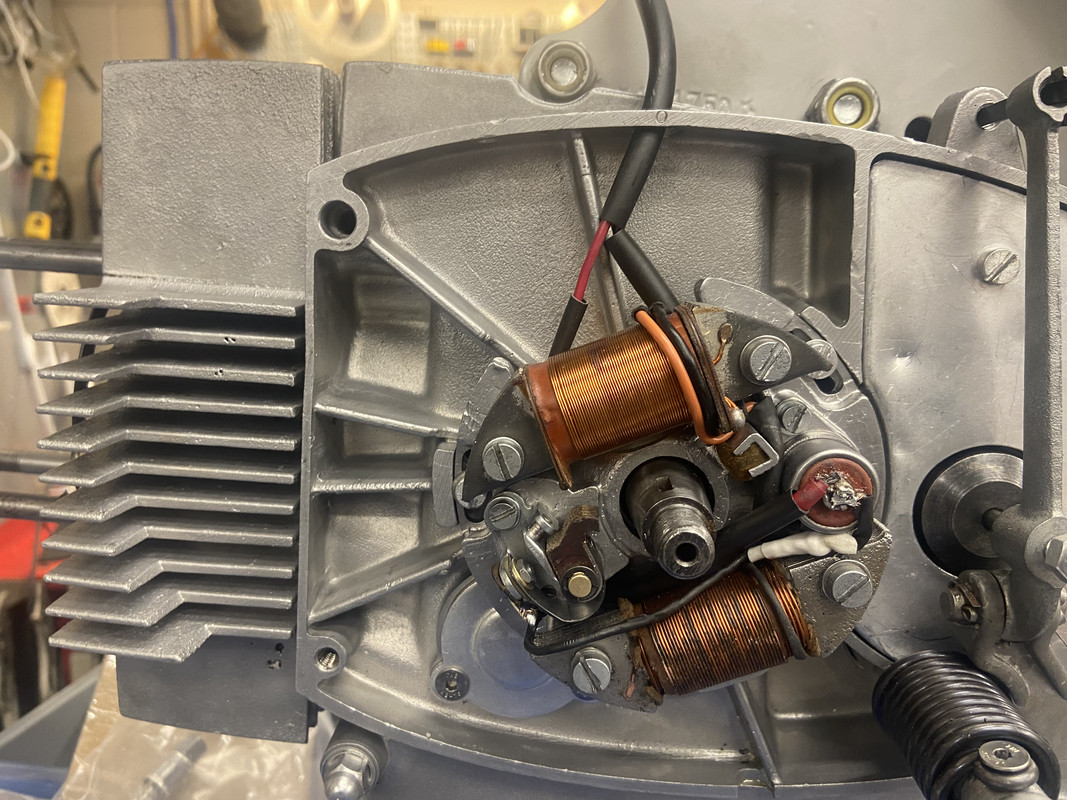

I cleaned up the stator plate and fitted a NOS lighting coil
fitted the stator

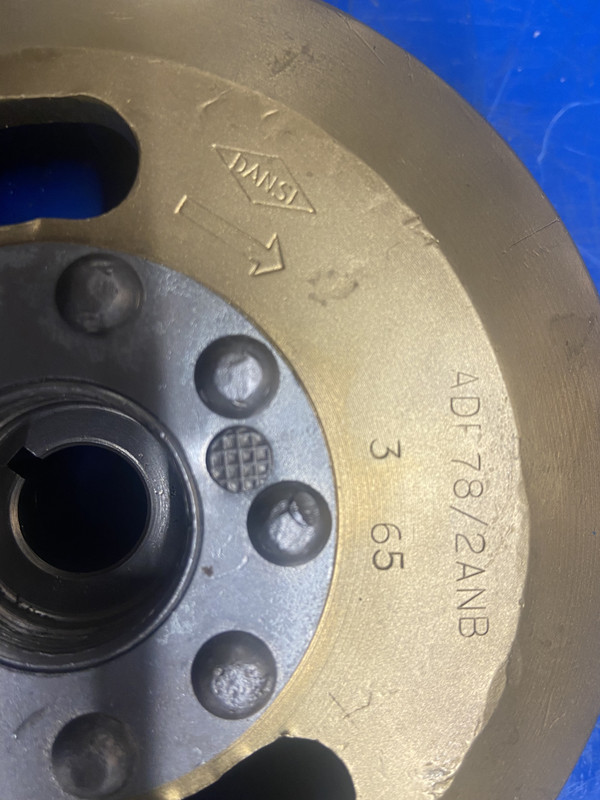

The parts manuals for the  125, 200 and 250 list different rotors for each bike but I think the stators are the same, all use the same lighting and ignition coil part numbers
Al of the rotors are the same dimensions but each as a unique weight. Regardless I don't think the rotors are sitting deep enough on the crank shaft taper, not a lot of threads sticking out. The manuals have unique part numbers but the numbers stamped on the rotors donlt seem to have any correlation to the parts numbers.
If anyone knows these motors I would sure like to hear from you  :undecided:

I think I may have solved the Rotor, I took the worst one as a test and chucked it in the lathe then with a small boring bar cut back the outer surface around where the retaining nut seats, took of about 6mm so now the nut has plenty of threads. The position of rotor to Stator appears to be ok.
I got into Rome today and plan on getting to the big Imola swap meet on the weekend of September 10, hopefully I can spot some Benelli/ Motobi things amongst the 3000+ vendors that are expected. I would like to find a NOS ignition coil for the Stator and a bunch of bits for my 61 Aermacchi Ala Verde tribute. Friends have sent me a list of obscure parts needed for restorations.

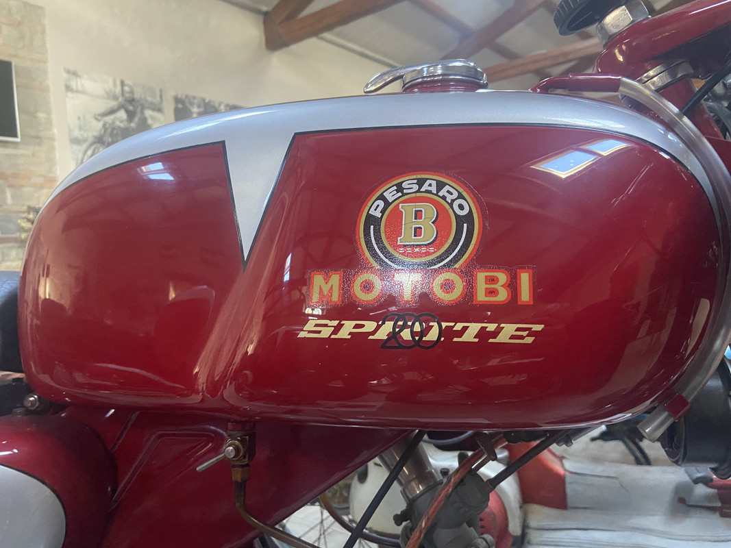

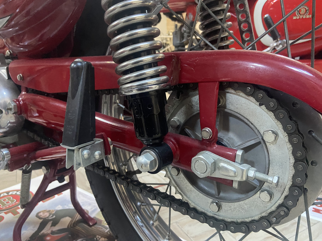

I was fortunate to visit the Benelli / MotoBi museum in Pesaro Italy, in September, located in what remains of the once large Benelli / MotoBi factory in the center of town. On the display floor amongst many other fantastic machines is this MotoBi Sprite 200, I took many pictures of the machine for reference purposes. I think I will go ahead and paint it this colour and label it as a MotoBi.
Unfortunately I don't have the European style triple clamps / fork ears and clip-ons that are on this bike, Cosmopolitan imported these labeled as "Benelli" and they came with typical American style hi-rise type handle bars clamped to the top triple, I will fit some flat or clubman style bars.
Offline huub
  • Posts: 792
Re: 1965 Benelli / Motobi 200 Sprite
« Reply #28 on: September 30, 2022, 06:24:39 AM »
for the dansi ignition ,
my MV 350 was fitted with a dansi ignition , of course the stator coil had failed.
i fittedd a new guzzi TS 250 coil  ( they also had dansi ignition. )
apparently lambretta scooters has the same coils,  aftermarket lambretta parts are easy to find.
« Reply #29 on: September 30, 2022, 10:31:01 AM »
That is great information!!
Thank you so much
