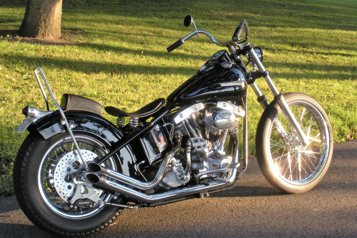

My 2015 V7 had the worst rear suspension I had ever experienced.  I purchased a set of Progressive shocks from Moto International that Dave Richardson recommend I try.  They were a huge improvement.   I never felt compelled to upgrade the front forks, but the rear shocks was a different story.
I thought my rigid HD bob/chop had better compliance than those stock shocks.  They had to go ASAP!   :laugh:
« Last Edit: March 03, 2022, 09:14:35 AM by Dave Swanson »
