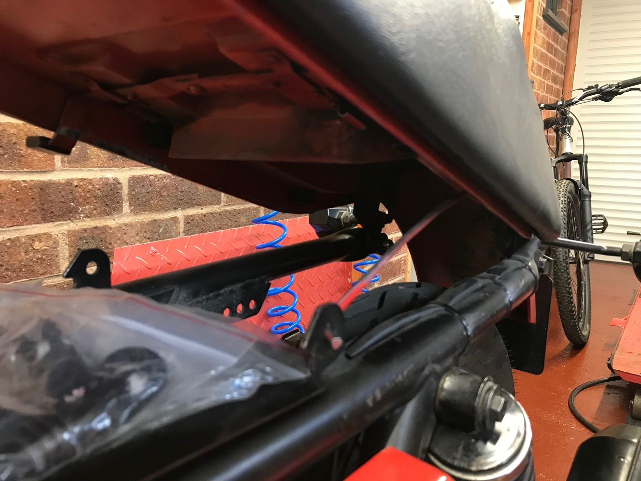

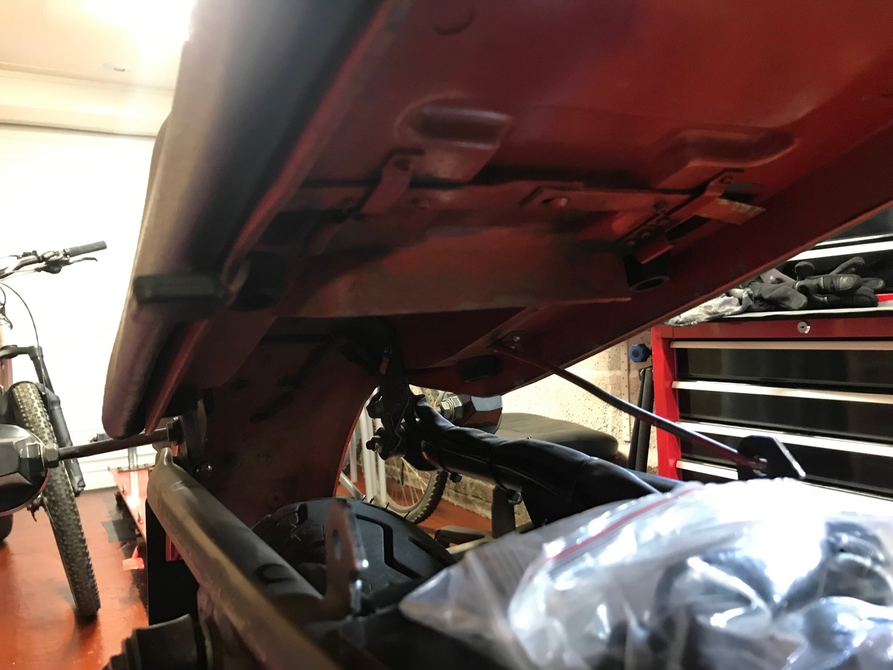

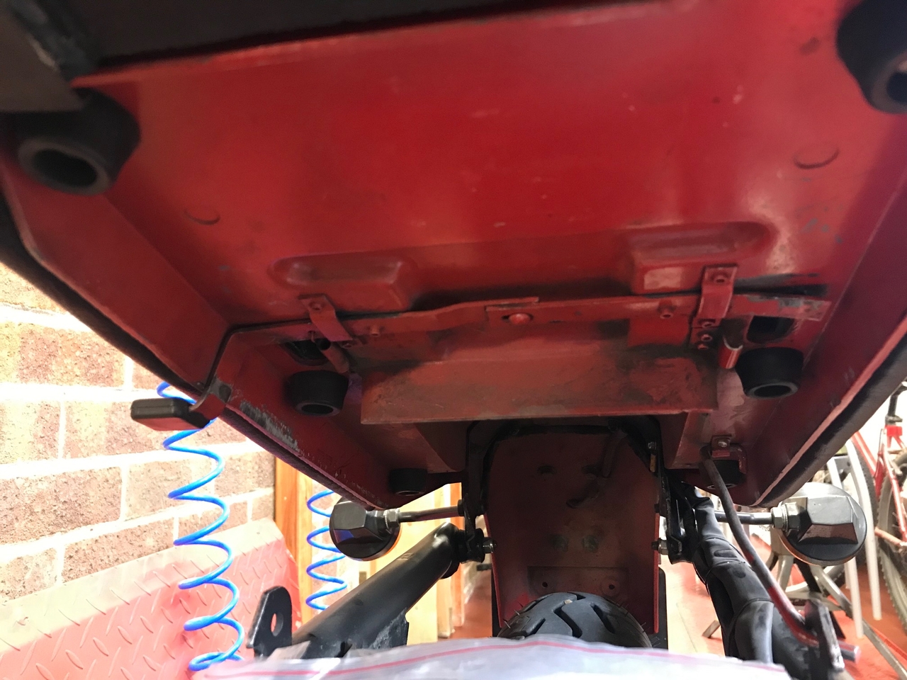

Re: Le Mans 1 Seat Prop/Support Rod
« Reply #8 on: July 04, 2022, 10:11:54 AM »
Any help?
Will only just slot into the hole right before the seat won't lift any higher.

Offline OregonAl
  • Posts: 294
« Reply #14 on: July 06, 2022, 07:29:25 PM »
Any help?
Very helpful, I had no idea it functioned in this way.. looks like I've got a longer way to go than I thought. Yours looks great!
