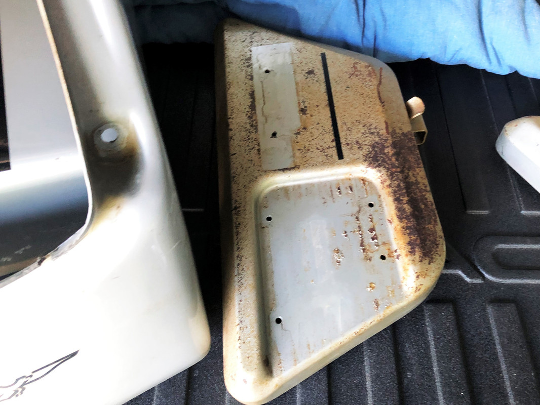

« on: August 05, 2022, 09:23:34 AM »
June of 2007 my daughter accompanied me on a drive to Michigan to pick up this 76 Convert.
 I had no idea that it would sit this long waiting, and waiting, but now the gears are slowly starting to turn.
I have been picking up parts here and there and have quite a few stashed now.  A NOS u-joint just in case, Gilardoni set just in case, and many other parts.
The restoration took a big step in the right direction when I dropped the tins and saddlebags off for paint.  It will be a slow moving restoration as I have 3 bikes ahead of it, but thought I would start a thread.  They always help me keep track.
