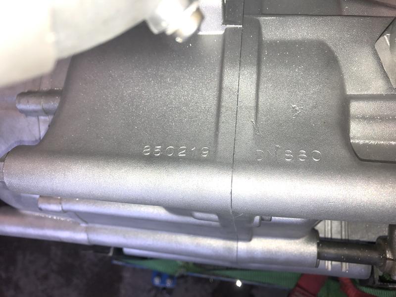

A Ducati 860 Bevel motor taken out of the frame and every opening sealed with plugs and silicone, before
after glass bead blasted outside on the driveway, glass bead blast will shine up the surface but you have to really seal up the motor carefully

Looks good, Jim.
Soda blasting polished parts is an easy first step to polishing with solvent and 1500+ grit & finer sandpaper.  It can eliminate any small bits of hard grit caught on the surface so they don’t inadvertently cause deep scratches..
Whenever I blast with a hard grit (glass bead, etc) outside, I do it over a large tarp. It helps with clean-up, but more importantly it captures the fractured media that is too heavy to be carried away by wind as dust.  This media will still cut so it is sifted and saved to be used for lighter duty blasting like producing a finer finish on metal.  Sometimes even the dust is kept and used to blow the job, depending upon the project.  Learned this doing monument s/b work to produce a different finish on the stone.  Guzzi people aren’t the only ones who are cheap….

Really like that glass bead texture. What will it look like with just the soda treatment?
I think I’ll stop by Harbor Freight in the next couple days and grab a gun and some Armex extra large media. I have a pancake compressor, and figure if it’s not big enough for the job, I can rent one.
Soda alone will look like the rim in the picture I posted. Soda is non reusable where as the glass bead can be recycled. Use a fine glass bead like #7. You don’t need a big compressor if your patient and give the compressor time to recharge.

Just a follow up now that I have pictures to share, I ended up getting the motor and swingarm Stripped professionally. They used plastic material so that it wouldn’t potentially harm any internals. 98% of the exterior has been stripped, only a few minor areas still have black powder coat on. Would’ve liked to have gotten the surfaces bead blasted, but I’m happy enough with the results to throw it on.l as-is.

The raw aluminum casting will get blotchy and gray as the surface oxidizes.
It'll still run fine, but look aged. My T3 is proof of this.
But if you spray it down often with ACF-50 (or WD-40) and blow off the excess the finish will maintain a reasonably  even grey color.
More detailed cleanup can follow with an occasional bath with WD-40 and a scrubbing brush.
Thanks, Ron. As mentioned earlier, I was aware of the chalky corrosion that’s inevitable if I leave it dry. I don’t have any ACF-50 at the moment, so I was considering a silicone spray or WD-50.
I failed to mention early on that one of the reasons I decided to go with the bare look was because shortly after buying it, I followed someone’s bad advice and attempted to clean the engine with oven cleaner, not realizing what havoc that would wreak on the painted finish. Since then I’ve had an ugly alternator cover and a few other areas that stuck out. Instead of repainting it, I thought I’d take the opportunity to be unique, and give it an old school look, which may or may not additionally prove beneficial when I take it off the beaten path as I do.
