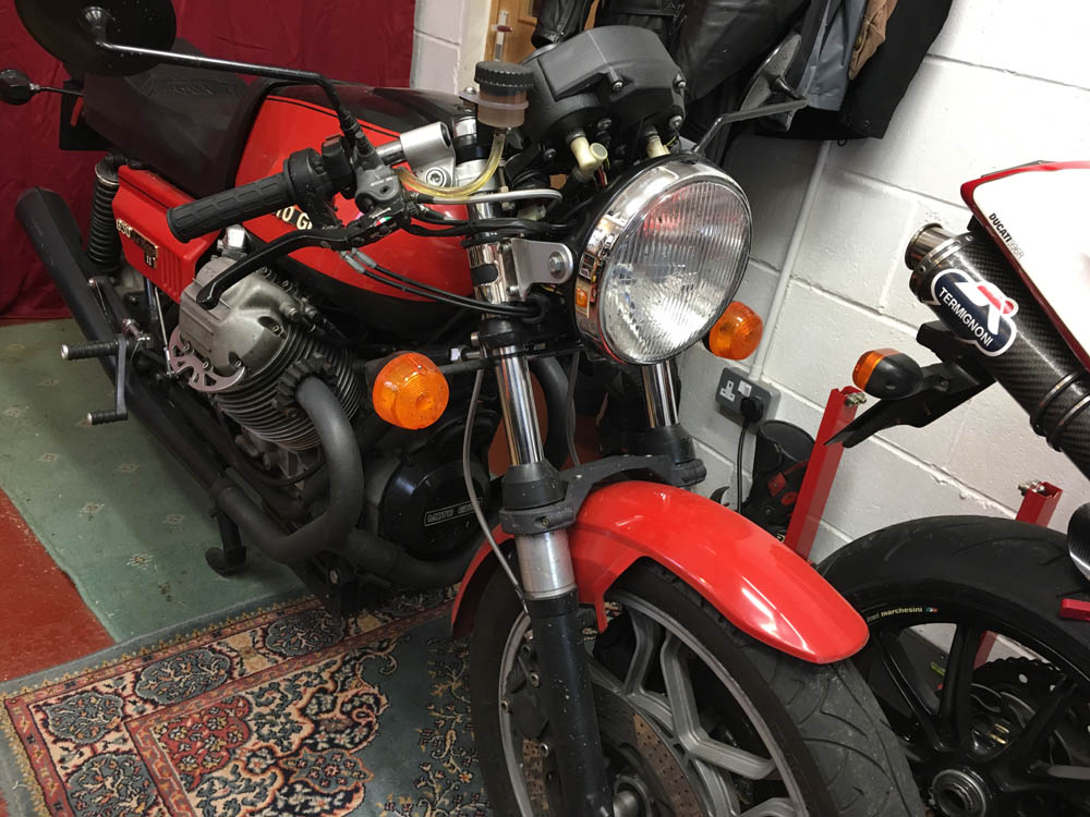

Fits nicely too, as you can see in this pic without the fairing;
Nice, progressive action and doesn't 'bottom out' against the twistgrip. It's never going to lift the rear wheel but that's probably more to do with the weight & length of the bike than brake power? but it can certainly stop quickly enough.
