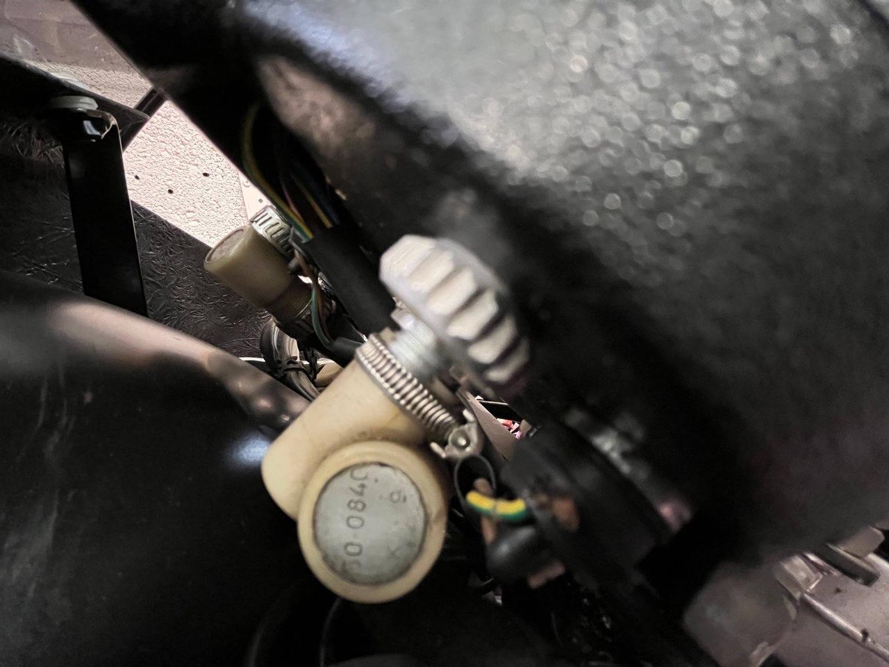

Yesterday on a VERY hot 240 mile day in flyover country, the speedo cable on the G5 gave up. Tach is fine. No Speedometer and more importantly, no odometer. Haven't taken a look yet. Wondering from those who have done more than maintain these old machines: which end of the cable is more likely the culprit: Inside the instrument cluster, or back in front of the U-joint where it enters the housing?
This is the dash of the bike, for reference:
'79 G5      (Gina)

I never owned a G5, but an SP, which is equipped with 90-degree cable drives under the Speedo and Tach gages.
If the G-5 has the same 90-degree drive, it is possible that the coupling to the gage, made of plastic, cracked, and the drive backed off, so the inner cable no longer engages the instrument. Both of my drives cracked and disconnected. I installed hose clamps to prevent them coming off.

You could also try to flush it out the oil fill hole,it's a big hole.
Hard time thinking-------------------
I completely understand.  :boozing:
Thanks gents. Time to get busy
