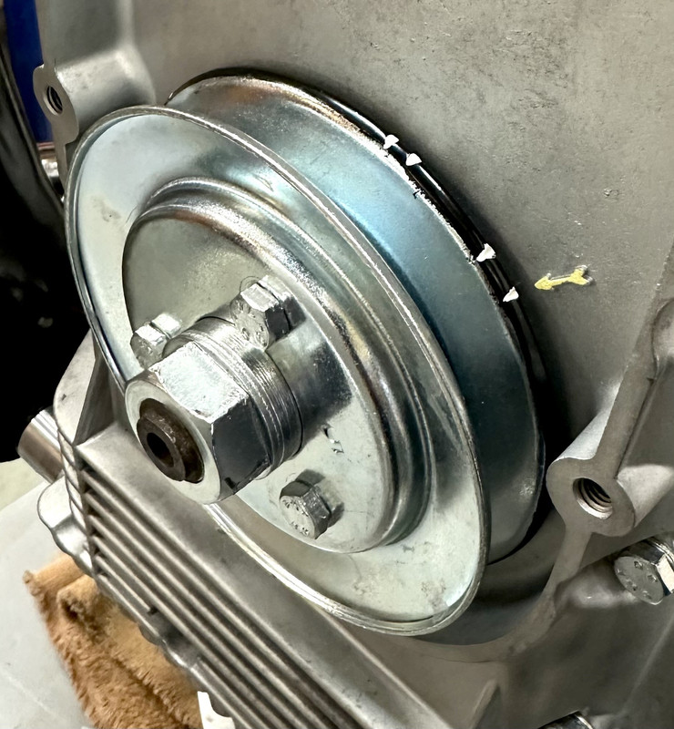

The timer had the typical "cratering" so I chucked it in the lathe and cleaned up the surface.  I am fabricating a better clamp for it.
A freshly plated pulley will make it tough to discern the timing marks with a strobe light so I painted the circumference of the inward pulley black and painted the hash marks white.
Looking good under the cover.
