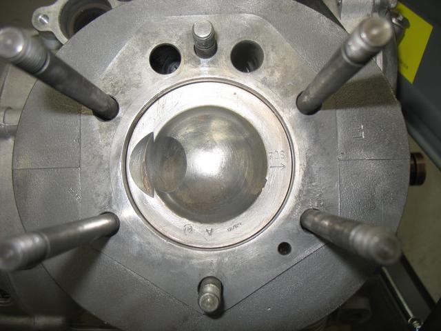

Continuing the teardown and cleaning of 1972 V7 Sport.  Aside from the Woodruff key issue, posted previously, I found another puzzle.  The piston and cylinder sizes are both marked "CC" (see pictures).  The manual lists sizes A, B and C, but not "CC".  Has anyone heard of "CC" and know what it represents?  Is it possibly unique to only the V7 Sport?  I'm ordering standard sized rings, and I assume they'll fit, but maybe this is an odd duck (or goose....).  Otherwise, pistons are shaped as they should be.  My digital vernier isn't calibrated and isn't accurate enough to get a good reading at these increments.  Thanks for your input.

Seen a lot of Guzzi pistons but never CC, I would mic it for sure & the cyl.
I will bet Joe W knows, he's seen more Sports than anyone I know. GuzziDoctor.com or similar.

2nd edit- that “notch” or relief on the piston is not present on 73 V7 Sport pistons.  I can’t claim to be an expert & to have seen many different v7 sport pistons, but all the ones I’ve seen were like mine- round dome with concentric flat top around it.  My opinion- that CC may denote the cut-out version piston, which would lower compression versus the more typical complete round dome and flat concentric top.

The piston with the cut-away for the intake valve is a stock piston, and it shows on the parts diagram and workshop manual.  There could have been other variations, but this is definitely a standard item.  The later Tontis had a flat piston dome with smaller intake cut-away.

I've rebuilt six V7 Sport engines, years '72, '73 and '74, and every one has had pistons that look like those in the original post. The relief is for clearance with the intake valve. Ambassador pistons are shaped the same, but with no relief, and are .5 mm larger diameter.

I was mistaken- just checked my original pistons (marked C) and they do have the relief.  Must have been thinking of the V700 pistons of current projects.  I replaced my original V7 sport parts with upgrade nikasil cylinder kits from Moto Guzzi, long since obsolete.  Part number is on the old box, just in case it helps someone-
What the CC means-?  It may be special or a simple mistake resulting in a double stamp.

I found a picture I took years ago of a 73 V7 Sport engine I was tearing down. I would bet the double C stamp was just a manufacturer miss stamp.

The "CC" could be a double stamp, but maybe "intentional".  It's on both pistons and both jugs.  Don't think that would be just a random error.
