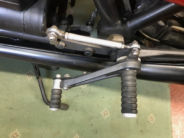

I've got aftermarket (Tarozzi) levers on my LM2 but I found the gear lever too short to comfortably get my toe under it so I extended it by removing the toe-peg and making an extension that bolts through the hole with the peg positioned flush with the front of the lever, gives about 1 inch extension, making it much better and a more positive feel due to the extra leverage.
I only had to do this after buying new boots that are bigger/bulkier than my previous pair but it is an improvement even when riding in other shoes/boots.
