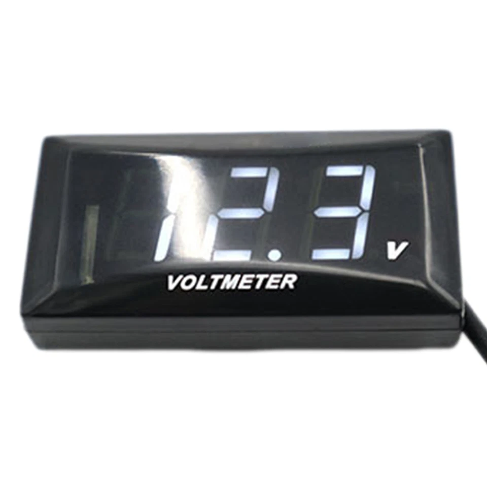

I bought this LED one from ebay after reading this thread:
https://www.ebay.com/itm/126740001066?var=427799754119
My 2 admittedly cheapo multimeters read my Bassa's battery as the same 13.23 volts after it was just taken off a battery charger. The ebay voltmeter read 12.5 volts. These measurements were taken directly from the battery's positive terminal and the grounds to the bracket for the seat release. The cheap voltmeter's wires weren't long enough to reach both battery terminals. Assuming the multimeters are accurate, the voltmeter seems so inaccurate as to be useless. I've contacted the seller. Will see what they say. In the meantime I'm off to buy a decent multimeter.
Has anyone done a direct comparison like this to see if their cheap volt meters are accurate? How far off is acceptable for you?
Always - though cheap multimeters can't be assumed to be accurate either. 0.2V variation is acceptable and within usual specifications, for non-calibrated/certified devices.

They are cheap junk, all over the map sometimes. I used them on my Triumph, connected to switched battery voltage. would be more stable at normal RPMS, but at idle would be off and blinking.

I bough ten volmeters like the one in the photo, but for 12Volt, that cost not more than a dollar a piece a decade ago. They are fairly accurate.

I replied to the seller with these pictures after buying a Klein multimeter yesterday:

that is way off :embarrassed:

« Reply #46 on: July 15, 2025, 08:47:39 AM »
Doing quick head math.....
The first three meters are all within about 1%.
That bottom meter is off by almost 10%.
To me even 5% is too far off. I would prefer even my cheap meters to be within 2%.

« Reply #47 on: July 15, 2025, 09:52:44 AM »
That is my opinion too. I did that math.
I did this with the engine off. Was only concerned with the meter's accuracy.
Seller's initial response:
hello,Our products are accurate.
Then:
Could you provide some picture or video to show the details?
Please do not worry, we will give you reasonable solutions after check it.
Waiting for your reply.
Have a nice day.
Now this morning:
Dear friend,
We are so sorry to see this issue.
I have received the picture you sent,
I need a little time to verify it,
and then I will report the problem to the relevant person in charge,
please wait a moment.
We will notify you as soon as we receive a reply.
Best wishes
« Last Edit: July 15, 2025, 09:55:32 AM by nwguy »

Re: Voltmeter
« Reply #48 on: July 15, 2025, 04:50:00 PM »
Then:
Have a nice day.
Now this morning:
Dear friend,
Best wishes
In other words bugger off, we have your money
The small round meter I have lines up with my+$400 Fluke 87
11.8 Volts that's indicating the battery is flat, what's the good in that?

« Reply #53 on: July 18, 2025, 12:13:03 PM »
 OK, about to install same Volt meter as Roy showed onto my 07 Norge.  Planning to tap into left hand flat side up of fairing above the ABS switch to view while Riding.  I am assuming any HOT and a ground will do.  Perhaps the Starter Yellow?  Or the ABS hot connected wire close by?   Where did some of you tap into?
Thanks.
https://www.amazon.ca/Waterproof-Voltage-Digital-Voltmeter-Motorcycle/dp/B09MZHJQJX/ref=asc_df_B09MZHJQJX?th=1
« Last Edit: July 18, 2025, 12:14:20 PM by SemperVee »

« Reply #54 on: July 18, 2025, 12:48:56 PM »
Fused, direct to battery (both terminals, my preference), or from regulator output (monitor performance/faults). Alternatively switched output from ignition switch.

« Reply #55 on: July 18, 2025, 02:37:42 PM »
Thanks.
That will draw enough power, that it should be switched off with the ignition. (or your own switch)
Then you get into the fact that many switched wires have something on them loading them down. For example, the headlight wiring may read 13 volts even though the battery has 14 volts. You have a one volt drop in the headlight wiring, maybe, which may be normal.
Not a problem, just something to keep in mind.
Try to find a circuit that is switched (like the dashboard maybe), without a heavy load.

« Reply #56 on: July 18, 2025, 05:39:13 PM »
   Could not find the factory Aux gps wiring  to use like I had on my previous 07 Norge so I end up running a fused connection from the +battery to under the tank and will with hole saw tomorrow install the volt meter just above the ABS switch on the flat open area above it.   I like the digital blue color. Hope is shows up better than the barely readable dim dash. (yes I have them turned all the way up via dash controls).  Thanks for the info.
56 years of Street Riding - All Brands

  • Posts: 14119
Re: Voltmeter
« Reply #57 on: July 18, 2025, 05:49:43 PM »
So on full time?

Re: Voltmeter
« Reply #58 on: July 18, 2025, 06:09:36 PM »
So on full time?
I like mine on full time: can monitor status when out & about, as well as when parked up for Winter. I use automatic battery tenders/chargers most of the time (especially the colder seasons) but it's good to know the battery state anyway. Nothing to stop one adding an inline switch - with its inherent (usually minimal) resistance i.e a small/tiny voltage drop.
