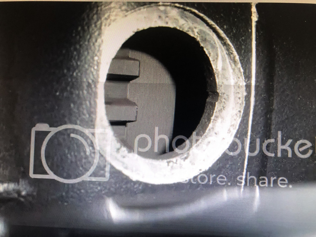

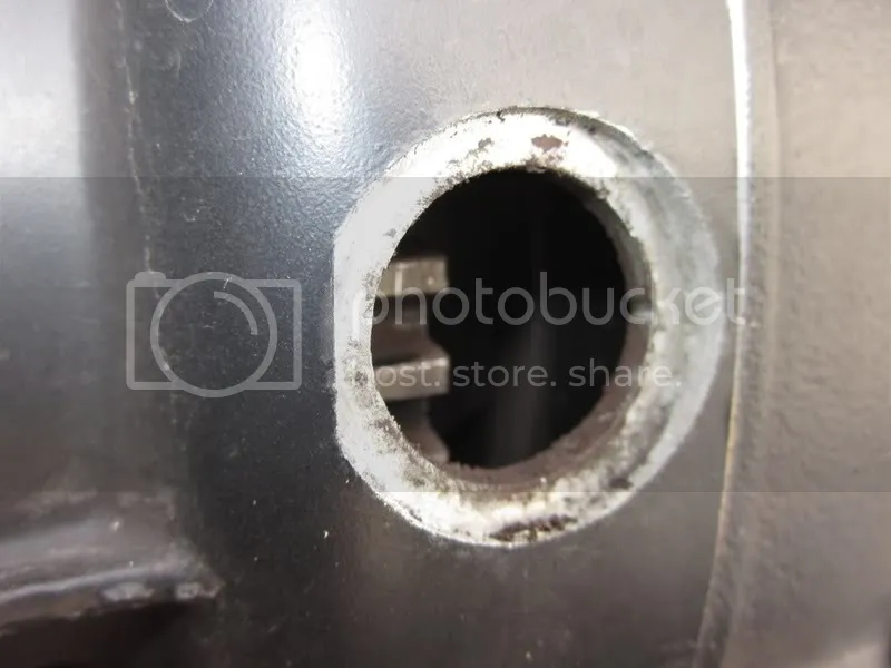

You will be checking for the presence of a 2 plate clutch (good) vs. a single plate (bad) which will fail.
Single plate looks like this.
2 plate looks like this.

« Reply #4 on: July 01, 2025, 09:07:46 AM »
Thanks much, Dave!
I think you've helped me conclude that "a photo of the flywheel gear area" and "a photo into the timing inspection hole" are the same? Just two different ways to confirm the presence of a two-plate clutch, correct?
« Last Edit: July 01, 2025, 09:08:30 AM by Mwether »
  • Posts: 4458
Re: Used Hydro checklist?
« Reply #5 on: July 01, 2025, 09:19:56 AM »
Thanks much, Dave!
Yes, "timing inspection hole" is the common nomenclature

« Reply #7 on: July 01, 2025, 10:45:30 AM »
From my photo stash.

And because I'm a clueless noob, this hole is on the right side of the engine? So the rear wheel is to the left (ring gear side) in Dave's and your photos??
« Last Edit: July 01, 2025, 12:36:22 PM by Mwether »
Online elrealistico
  • Posts: 196
  • Location: Central Florida USA
« Reply #9 on: July 01, 2025, 12:35:48 PM »
Right side of bellhousing, rubber plug, easy to see.
