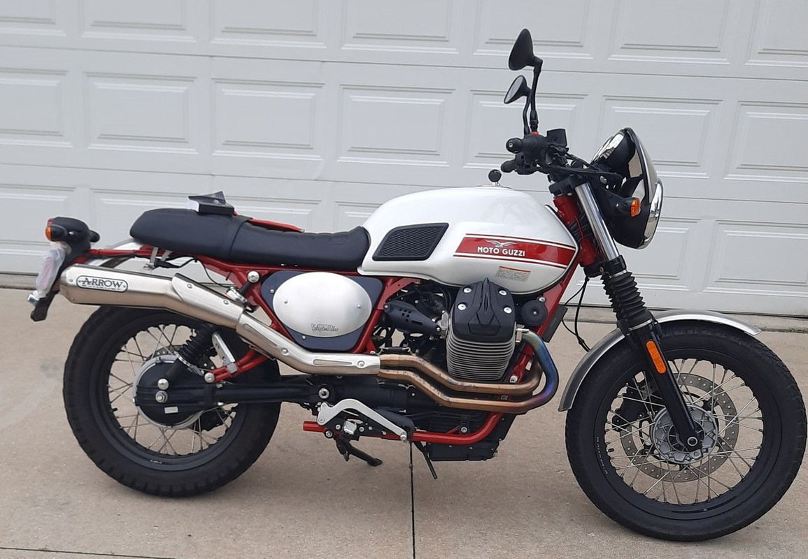

My Grandson is on the hunt for a motorcycle,  he has been riding one of my Hawk GTs and his Dad's F3 Honda so he is getting  good riding experience in.
A 2015 V7 Special happened to pop up at a reasonable price and I will go have a look at it.
Wondering if any of you know of Any issues with these Guzzis...?
Thanks,
Rob
Image from the web

Well, turns out that the V7 is a Stornello.   I went over for a peek at it today and noticed the high pipe, meaty rear tire, bash plate and headlight screen...  Rear case, double adjustable windscreen.
Cool.
Long story short, we bought it.
My Grandson is now a third generation Guzzi owner in our family.  Does a guy proud.   :grin:
Thanks again, all.

They only had the Stonello in 2016. Somebody just converted a Stone to one.
Certainly nothing wrong with that other than the now tube tires.
« Last Edit: July 09, 2025, 03:44:13 PM by Vagrant »
L-196, L-197
  • Posts: 4500
Re: Any issues with the 2015 V7 Special...?
« Reply #11 on: July 09, 2025, 04:06:20 PM »
Correct.  This is a Stornello.  A one year only 2016 V7II model.  Someone liked the Stornello exhaust system.
Offline radguzzi
  • Posts: 7353
« Reply #12 on: July 09, 2025, 05:02:58 PM »
Ahh, ok, well, a wanna be it is...  I was told that it was a V7 Special.  Check the rider's pegs, are those aftermarket...?

  • Posts: 31196
« Reply #13 on: July 09, 2025, 05:16:31 PM »
Thanks
"A rose by any other name would smell as sweet" - Billy Shakes
  • Posts: 4500
« Reply #14 on: July 09, 2025, 05:42:56 PM »
Thanks
It is a V7 Special.  The pegs are a minimalist aftermarket design of some sort.  They don't look to be long distance comfy.
« Last Edit: July 09, 2025, 05:43:42 PM by Dave Swanson »

« Reply #15 on: July 09, 2025, 06:41:38 PM »
For me, that double screen would have to go! :puke:
Nearly natural progression..
Past: SS50, Z200, Z250B, Z400J, (H100), GT750, K100, ZR1100, 900 Trident, 955 Sprint ST, (ZR550, M600), 900 ST. Present: (B750), V7III CS, (V50II).
Offline radguzzi
  • Posts: 7353
« Reply #16 on: July 10, 2025, 11:12:42 AM »
Well, that is odd given your handle...  :grin:
The top one is adjustable for wind buffeting I would guess.   It will be up to Jackson to decide whether he likes it or not.
rad__
