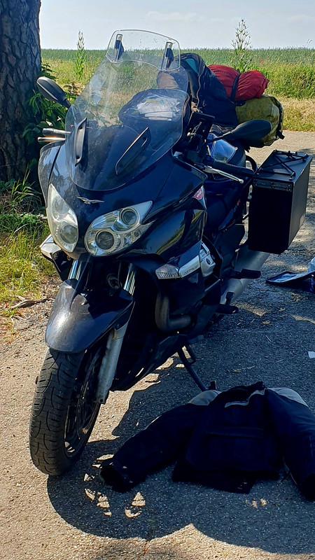

I just bought a Paraballum from Harpers for my 1400, they only have one of those left.  If they offer it for your model, it would be worth considering as it really does for me exactly what you said you wanted.  They were big in Beemerland for a long time.

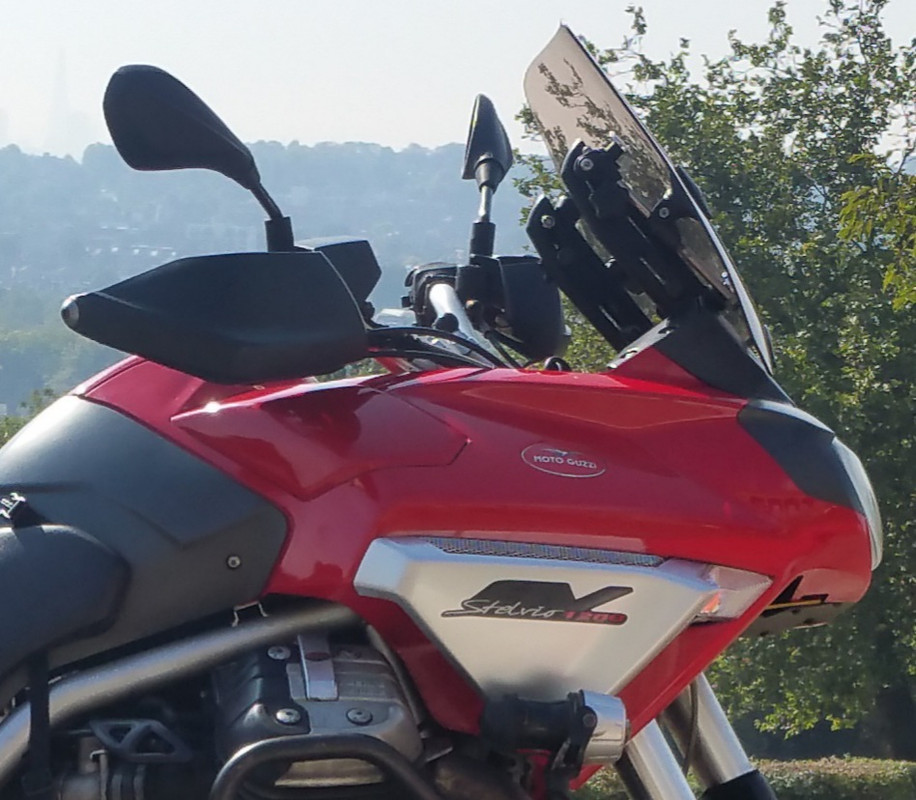

I use a small Givi screen on my Stelvio. Very adjustable so with experimentation you can hit a sweetspot.
