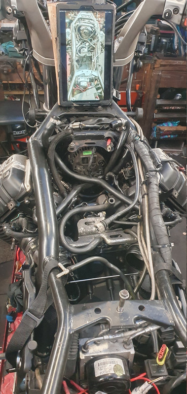

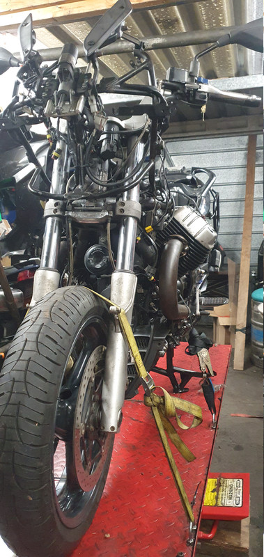

Popped the front wheel in so now it's off the engine stand and on the main stand. No longer attached to the scaffolding frame and down a notch on the bench height. Think today I'll get the throttle bodies on and start tying in the loose wiring and hoses.
Offline theoneandonlymin
  • Posts: 108
  • Location: Norf Landan
Re: NorgeGT clutch replacement.
« Reply #38 on: January 18, 2026, 02:41:12 PM »
Good day's work today.
Throttle bodies, starter and associated cables wiring and hoses back to where they were.

« Reply #41 on: March 15, 2026, 12:39:01 PM »
Sorry folks I've been doing other stuff.
Anyway, threw in an extra cable this morning from alternator straight to the battery. Time for the airbox to go in and we're nearly ready to roll.
Well, I'll have to wait for my replacement inlet rubber to arrive from Stein in Germany.

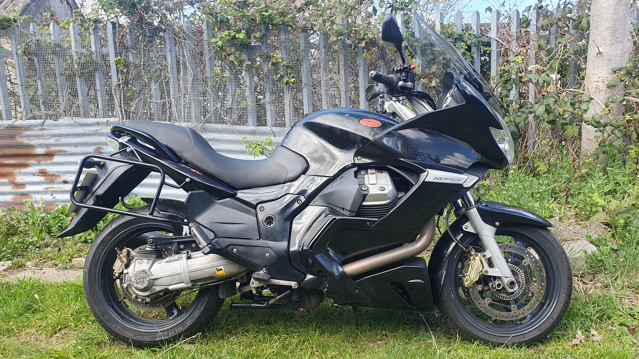

« Reply #44 on: April 07, 2026, 09:25:25 AM »
So, we're rocking again.
First ride out  ABS light came on, hmmmm, then speedo stopped, ah, must be the wheel sensor.Then it started running really bad. Luckily I wasn't far from home.
Quick Internet search...loose battery terminals or not charging.
Sure enough it wasn't charging.
Replaced headlight fuse as it was/ wasn't consistent. As if it was broken not fused.
Cleaned up the rest of the fuses and we're back in business.
50 mile test ride this morning and all is well.
