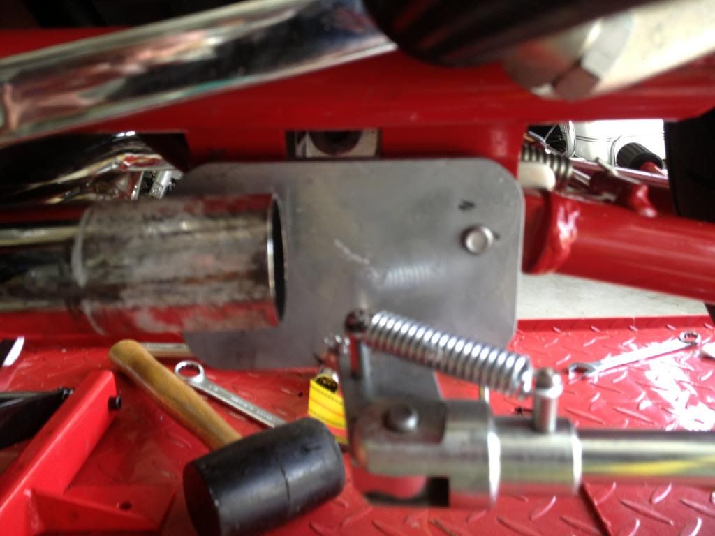

I've been working with the guys at Boxerworks as they modify a Brown sidestand to fit a Tonti framed Guzzi. Brown's were developed as an answer to BMW's crappy stock stand, so why not modify one to replace Guzzi's crappy stock spring activated stand? Specifically I was looking for one to install on my V7 Sport. I've had one on my R75/5 for years and love it. Gotta give credit to Alex of 20th Century Cycles for doing this first. So here's the prototype, and some photos showing the installation.
The modified stand with new mounting plate -
The mufflers and crossover had to come off the V7 Sport.  The long rear engine mount that runs through the back of the tranny had to be reversed with the head to the right side of the bike. The left centerstand pivot bolt also has to be reversed as both screw into threaded holes on the mounting plate. I put a dab of blue loctite on the threads as the nuts are no longer necessary - there isn't enough room.
I then realized I had to install the crossover BEFORE the stand was bolted on, so off it came. Once the crossover was back on, the stand was mounted back up. Less room to work, but couldn't do it any other way. Other models may vary depending on type of exhaust, crossover, etc.
The pipes went back on, and the mounting plate pretty much dissappeared.  My suggestion is to trim down the bottom corners of the mounting plate to make an even more low profile.  The stand now sits below the muffler, just to the rear of the foot peg.  The sidestand has to be depolyed before the centerstand can come down. That is the natural order of things for me anyway. Bike on sidestand, dismount, then on centerstand (if needed). Or, feel confident leaving the bike on the sidestand. What a concept!
Anyone interested in purchasing one of these modified stands can contact Boxerworks direct. Nathan Mende at 706-310-0699, or cell at 706-614-4698. email: nathan@boxerworks-service.com. Be patient, the supply of Brown sidestands isn't what they want it to be. They buy in bulk, but availability isn't always there.  Ask Nathan about pricing.  Big thanks to Scott Miller for making this happen.
Cam

Thanks for that. I'm going to go out  the shop right now to eyeball the Brown on my /5, and see about making one of these up for my T3.

Since my Cafe' doesn't have a center stand, do you see any issues with mounting this stand? On my stock stand, there's a little lug that sticks out of the frame and acts as a rest for the current kickstand.
Does this stand need a rest? Will it lay against the muffler, or does it have its own stop?

Doug,
Look behind the rear engine/tranny mount. Does your bike have a tab where the center stand would bolt up?  If so, it should work. The stand its own stop, and hangs below and outboard of the muffler.  If interested, work with the guy at Boxerworks.  The design is still evolving.

It looks great! Nice and clean. Could maybe use a flat plate on the bottom for sand, gravel and hot asphalt parking lots.  ;-T

Looks like it tucks under the muffler nicely but is it easy to deploy? I assume you use the toe of the boot. Any concern about hitting the hot muffler with your boot?
Would have really liked that on the LMIV, which had a precarious sidestand that I rarely used.

Mark,
The sidestand tucks under and is almost inboard of the muffler, possibly more so than the perspective in Cam's photo shows.  Its deployed from the saddle by 1) partially pushing down the center stand via the center stand tang which 2) catches the sidestand and swings it out at which point 3) you slide your foot off of the center stand tang and onto the partially deployed sidestand and complete deployment while the centerstand returns to its resting position.  With minimal practice this movement becomes fluid and is less complicated than I am making it sound.
Thinking about Doug from above, without a center stand tang to catch and partially deploy the sidestand, the sidestand would be difficult to deploy from the saddle.  Also, the sidestand has a stop built in and does not contact the muffler.

Here's a shot looking down on the muffler and stand.  It is mounted beneath, but angles outboard just enough to grab hold of the foot and deploy it.  Again, this may vary depending on type of pipes, etc.  I have the Repro Selentium Shark Gills on the Sport. The pivot point is directly underneath, then the length of the stand slightly angles outward. IMO, this is the perfect position.  Pressing down on the centerstand tang does not move the Brown - Just snag the foot and swing it out.  Anything is better than the stock stand's position up front.  I need to dismount the bike to fight with that.
I stand corrected.  What I wrote above regarding deployment goes for my SPNT and LM-3, the bikes on which we built the prototype.    But clearly, that is not the case with Cam's bike.  This now makes me think the stand may also work well on Doug's bike without a center stand.

Looking at it, I think it will work fine too. I still have the holes/tabs from the center stand on the frame, so it should be easy enough to mount it. I'm gonna give them a call.
That retracting sidestand on it now is sketchy at best.

Doug,
At most you'll need a spacer inside the center stand tab for the bolt to run through. Trust me, Jacquie will love it.

Hey Cam, any pictures of the bike sitting on the ground on the stand? I'd like to see the angle the bike leans at with this stand.

Finally got the V7 Sport off the lift to try out the new stand.  It's easily deployed with my left heel while sitting on the bike. The "lean angle" is just right, pretty much the same as my stock Brown on the BMW.
And the stock stand has found its new home - right where it belongs!
If you have been wanting to ditch the stock stand on you're early Tonti framed bike, TRUST me this is the ticket.

When you removed the stock stand, did you need any kind of spacer, bushing or washers to take up the space on the engine mounting bolt that was occupied by the stock stand bracket?  Or did were you able to bolt it back together as is?  Thanks.
Scott
Scott,
One more thick washer did the trick. I was also able to remove the front engine mount bolt without removing headers. The bolt head just clears.  I forgot to mention earlier, keep a scissor-jack under the sump while removing the long mount bolts. Easiest way.
