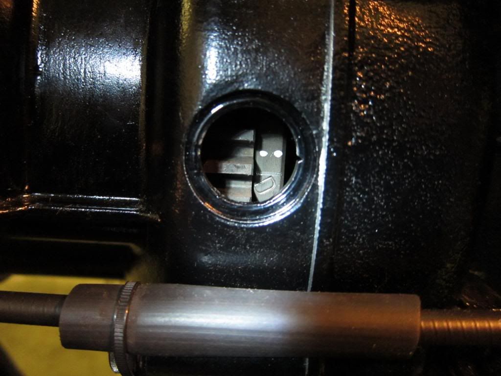

Well, I checked all my flywheel markings, TDC, initial advance and full advance. They were all 2-3° out. Nice to know that they're all spot on now that I've re marked them.
This is the rh pot's TDC markings, the double dot is the accurate one.
« Last Edit: March 12, 2014, 05:19:00 PM by Stevex »
