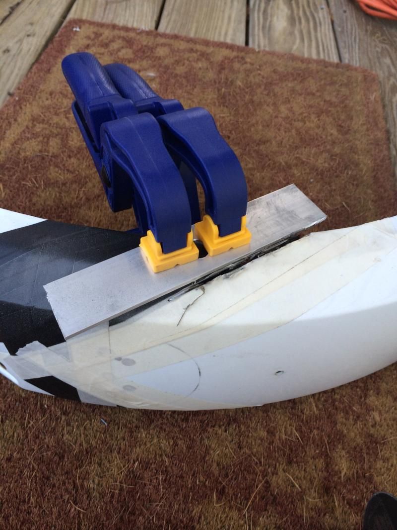

I got the fender chopped, sanded, and treated the cut edge with Toyota touch up paint

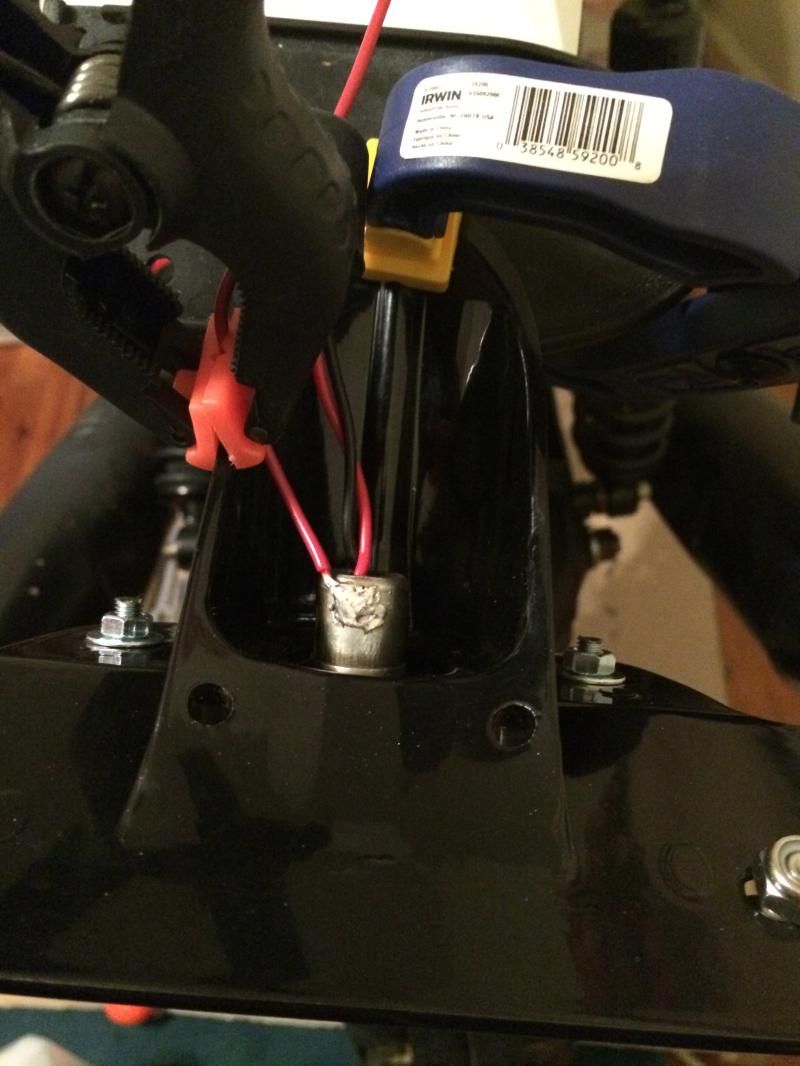

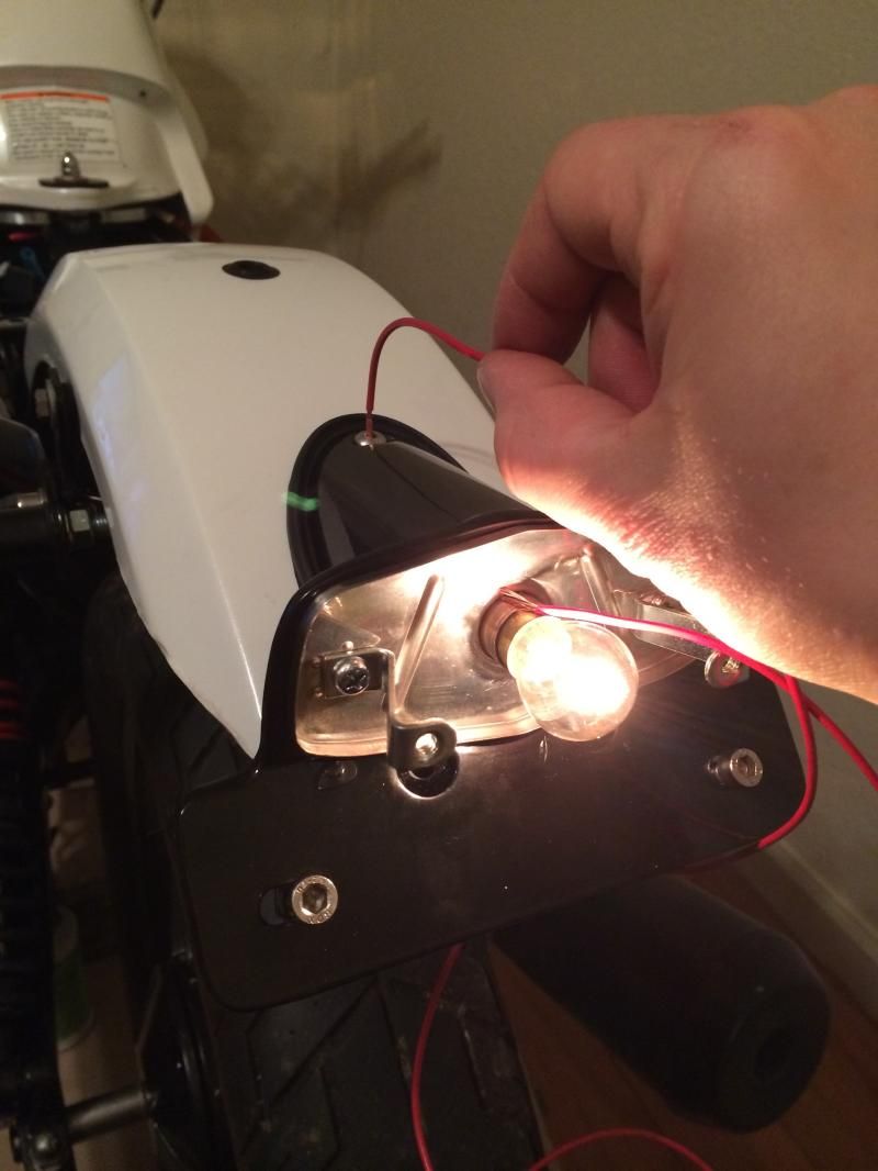

I am struggling with the light wiring now.. Turn signals work but the tail light doesn't at all.
Unfortunately I don't know how to work a multi-meter so time to google & youtube
The light I bought.. In the comments/reviews someone said they has to solder an extra ground wire to the light? It just has two wires.. Black & red..
The tail light I took off just had two wires so I figured it would be good..  Perhaps I mixed up those two.. More fiddling tonight

« Reply #100 on: December 29, 2014, 03:34:15 PM »
If the light is Stop & Tail it must rely on a ground return.
The tail light is normally off a different contact in the ignition switch, they do it that way so it can be on in the Park position. However if you don't plan on using Park you can run it from the headlight fuse.
Take the glass of the light and see if it works when you touch a grounded wire to the bulb socket.

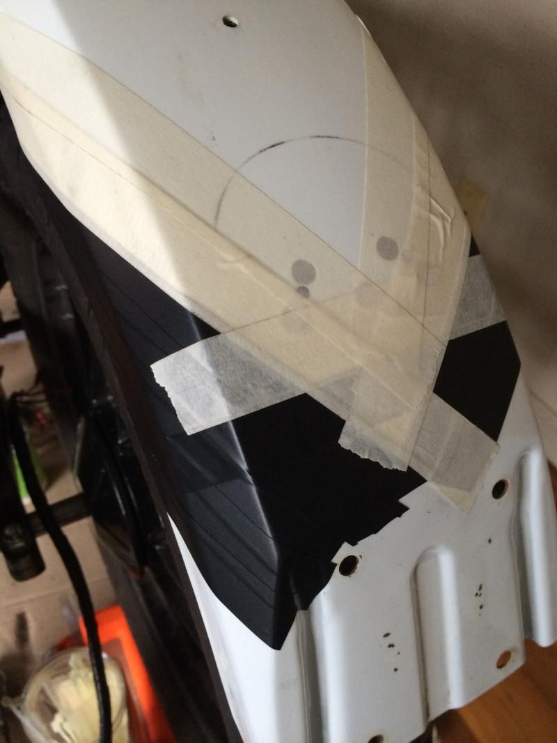

Ok when we last left I'd taped up the fender to get a feel for the new lines. I used electrical tape cause it goes off and on cleanly and it's pliable enough to curve the lines.
Once the shape was determined I went back and overlapped with a couple layers of masking tape.
Then I clamped some scrap to it to keep my lines straight
I had never used a die grinder before but I've had my uncle's in the toolbox for ages. It was pretty easy.
After KiwiRoy's advise I figured out grounding the socket made light worky
This shows the second time I soldered the extra ground to the bulb socket
I know it looks shite but I'm no soldering expert
The first time I used resin core solder with no flux.. Once I painstakingly bound all the wires up & bolted everything down.. The light didn't work. I don't really understand the various types of solder. I opened it back up and the soldered wire had popped off.  I sanded the contact point, and used regular solder with flux.. It's tight as a tick now and the light works

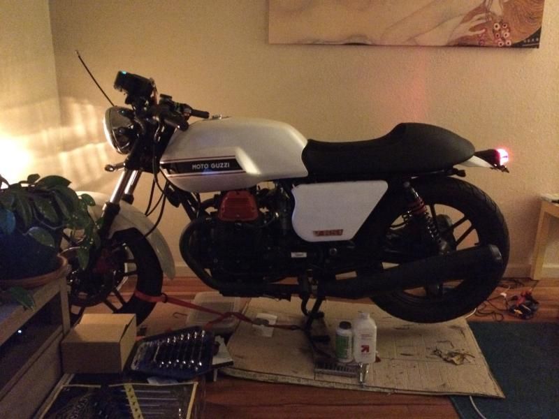

Well this week I got it all finally finished (for now!  :evil: )
I changed the main jet in the carb to a 125; that was a 10% bump for pod filters and 10% for ethanol gas (I got these numbers from guzziology). It took about 5 weeks to get the jets from Moto Int..  the first jets they sent were 6mm but supposed to be 5mm. They were mismarked somewhere along the way and it took a couple send-backs and calls to get it sorted.
I torqued the heads & set the valves.. I synced the throttle cables as close as I could.
The bike went to Jake Hall at Hall's Custom Vintage here in Asheville where he synched and adjusted the carbs (I dont have sticks). He was also able to get the tach working, and he perfected the adjustment on my clutch with the homemade cable.
I got the seat mounted securely
http://wildguzzi.com/forum/index.php?topic=77831.0
I have ridden it three times now, a couple short jaunts around the neighborhood... Yesterday I took it up the BRP and all through the mountains, about 200mi.  It's awesome! the best it has ever run! Back in love!  :grin: :bike-037:

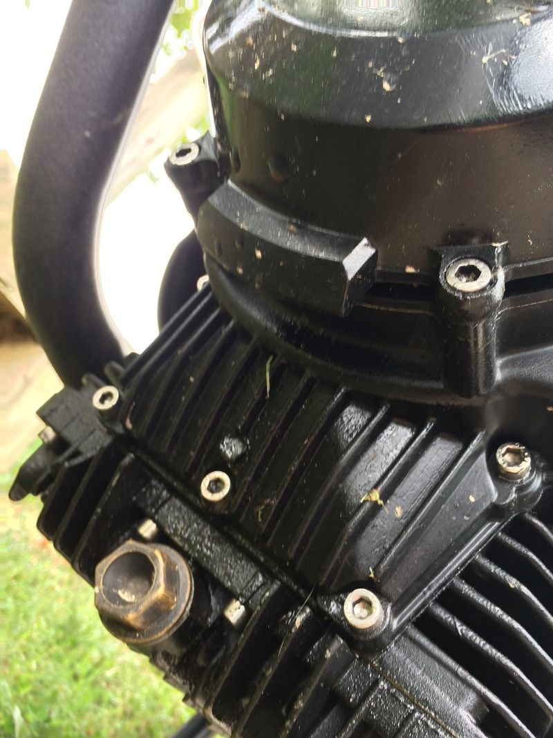

My homemade breather is functioning great, but I need to lengthen the exhaust hose, or route it out back instead of under the tank. I have just the slightest mist of oil on the top of the block from the breather
the only issue I still need to resolve is an oil leak from under the timing cover

Great job!  Sounds like you have that thing pretty darned sorted.  Sounds like a front seal.  I don't have any experience with that.  Keep an eye on it.  Ride it and enjoy it.   :thumb:
