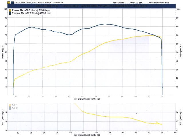

The question is whether the Guzzi Big Block is a much lower-revving engine in the V11 California application as opposed to, say, the V11 LeMans application.
THE ANSWER IS: NO!
Convert is an odd duck and the exception to the rule.  Citing it is only muddying the waters.
Maybe just the slightest difference between them, like chalk and cheese
Cali 100 torque from 2000 to 7000, actually more at 2500 than 4000 !!!!
From here http://wildguzzi.com/forum/index.php?topic=28424.0
very different opinion from owner of that bike,
Can't find V11 sheet on web or here, here is 1100Sport, close enough in spirit at least, good torque from 5000 tp 7000, poxy at 4500
http://www.gpperformance.co.uk/small_page.php?function=gallery_viewer&img_id=16
Sorry can't post it, have to click link
Note you are looking for torque not bhp,
« Last Edit: March 01, 2015, 10:38:34 PM by rocker59 »

^^^^  Chalk and cheese?  Are we looking at the same graphs?
Cal Vin (not the best comparator, but oh well):  Torque peaks at 5,400 rpm and hp climbs significantly after 4,000 rpm (with climbing hp and strong torque all the way to redline).  That is NOT a slow (or, low) revving engine.
Sport 1100:  (not even from the same era as the above bike, but again, oh well): Graph shows nearly identical torque (why three lines?) shifted slightly to the right (higher rpm by about 500).  Not much of a difference, and certainly no explanation for what the OP is trying to tell us.  (That's putting aside that if the 1100 Sport figures are from a carbed bike, it's not even close to a valid comparison.)
Find exact sheets if you can, but opinion varies, some seem to have joy from low revving Guzzi engines, esp Cali with high gearing to make use of it, others gear them down, c'est la vie. To each his own, not a bad thing to short shift and ride the torque, I do but don't care if anyone thrashes theirs through gears, not my concern at all, I'm not paying for fuel .
From the owner of that Cali sheet
Now that all the “teething problems” are solved (and forgotten! ;D ) and with already 5,000Km on the clock (in 7 weeks!  :) ) I took my California Vintage for a Dyno check at C.M.B. Verdeyen.
Taking into account that the typical loss of power between shaft and rear wheel is approximately 15% these figures are very close to the factory claimed values (slightly better).
It is amazing indeed! At 2,500rpm it already gives almost 80Nm!  8)
It looks like a Diesel engine!  ;)
