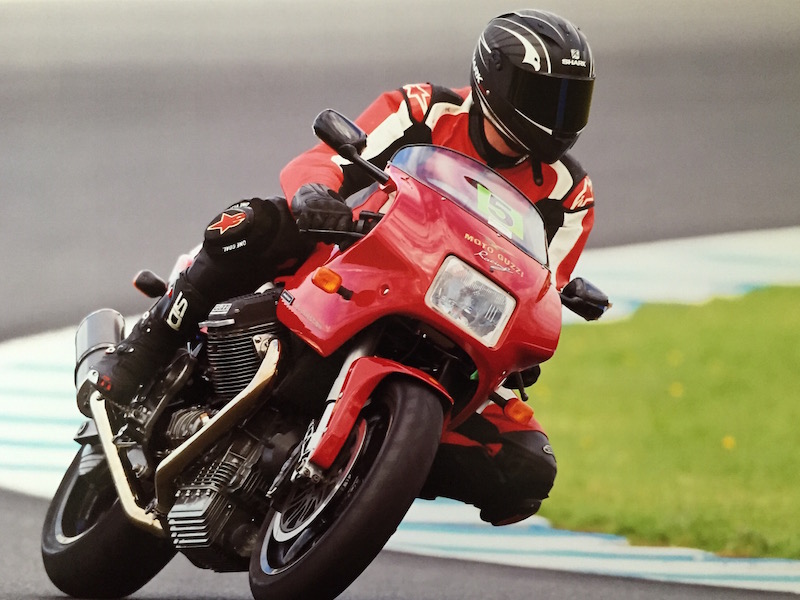

« Reply #15 on: March 02, 2015, 07:22:53 PM »
Hi Tobit,
of course I'll sing out if I get a trouble free run. When it's running well it's way smoother than my V11's and has a lot of punch up top. I can cover some of my favorite roads cruising in 4th and rarely push near redline.
Couple of pics from the other day:
