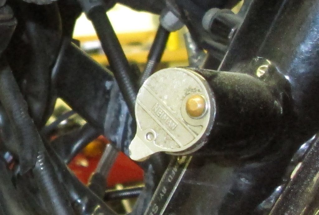

With the triple clamps out I decided to remove the steering lock because I didn't have a key for it.  Pry the brass rivet out using a strong knife blade as a wedge, pull the cover, then use a large punch the diameter of the lock cylinder to drive the lock cylinder in about 3/8".  The pin that holds the lock cylinder will be sheared and the lock removed by pushing it out - not in (good info here: http://w6rec.com/duane/bmw/lock/)
After the lock cylinder was removed I used a dremel to cut a slot in the sheared pin and removed it.  It was easy to replace with a short length of 3mm bolt.  I also pulled the cover off the lock pins (tumblers?) - they are tiny!  Much smaller than household lock pins. And the springs are tiny and fly everywhere.  There are 5 pins (the BMW site says 4) and I removed one, filed one and made another and was able to rekey the lock so that it uses the same key as my LMIII but with 4 instead of 5 pins.  I now have a key!   ;-T

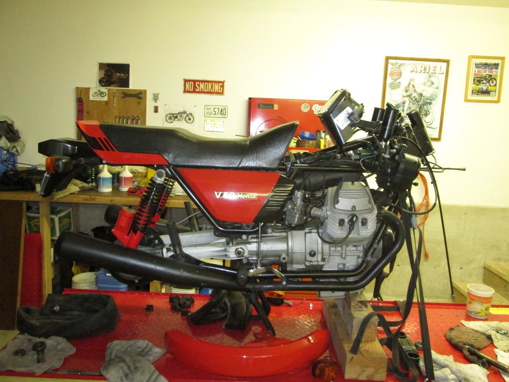

This started with wanting to put new tires on the Monza.  But first I had to get the wheels powder coated.
Picked them up Friday:
Tires on today:
The rear shocks were leaking so looked for a rebuild kit.  Marzocchi Stradas.  Got the rebuild kit here (for 12mm shafts only):
http://marzocchimoto.blogspot.com/p/ag-strada-kit-buy-it-now.html
Don't like having so many components in pieces.  Ugh!  It now looks like this:

Progress!  Rebuilt the 'zocchs today and installed the rear wheel and tire.
