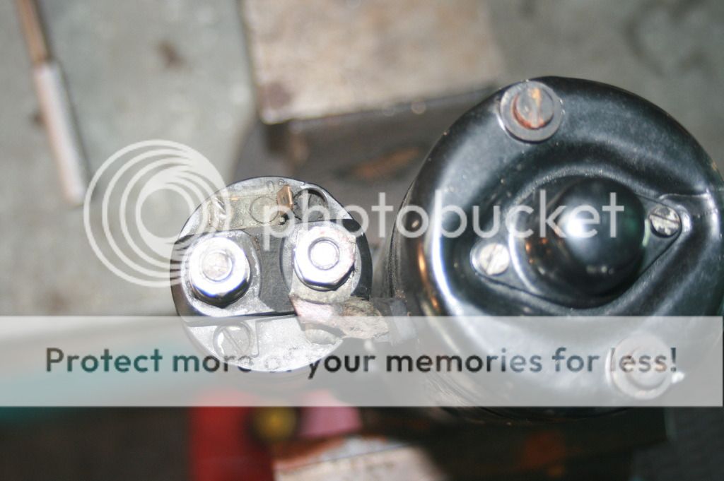

The first thing to do is to remove the starter motor from the bike. Disconnect the battery and then the two cables at the solenoid. One is a push on terminal and the other requires a spanner or socket. Undo the two bolts holding the starter to the flywheel housing. The top one screws into the housing, the bottom bolt has a nut on one end. Lift the starter clear. The rest of the work is done on the workbench or a table and a vice is some assistance although you can manage without if necessary. Clean every part as it comes off. Use only a cleaner which evaporates and leaves no residue behind.

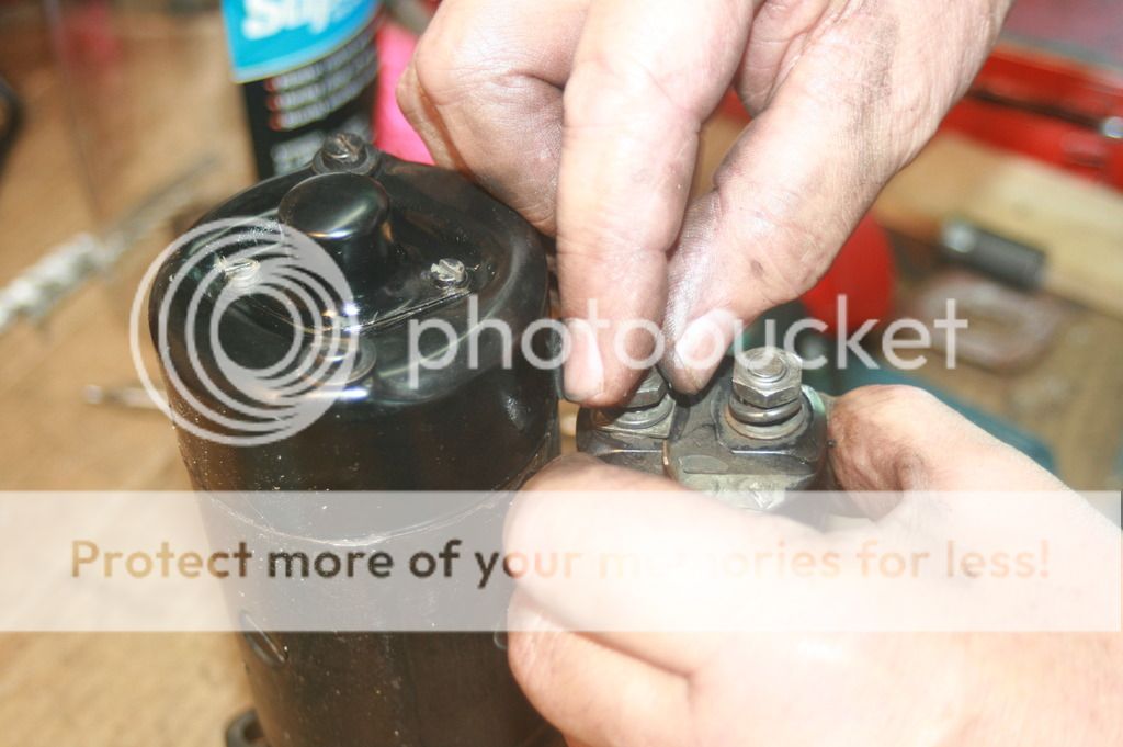

Remove the second cable from the solenoid (the one which disappears inside the starter motor) and note which way the solenoid is oriented. On mine the push on terminal is on the inside of the solenoid when mounted on the bike.

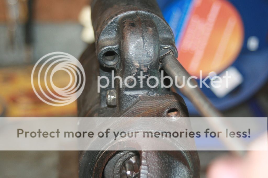

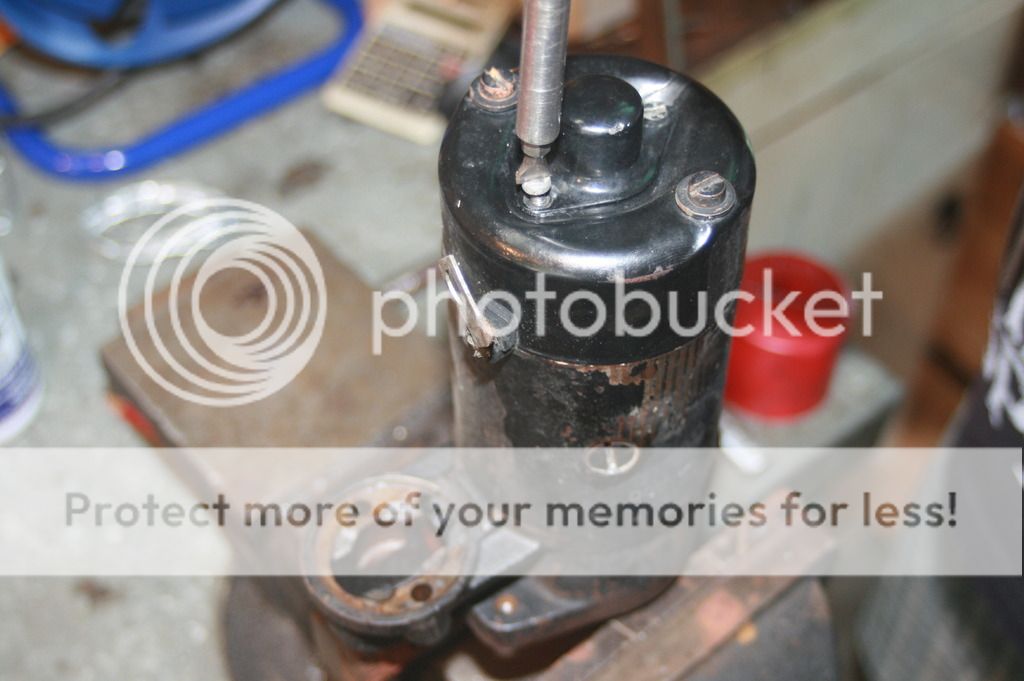

Remove the two countersunk screws holding the solenoid to the starter motor.

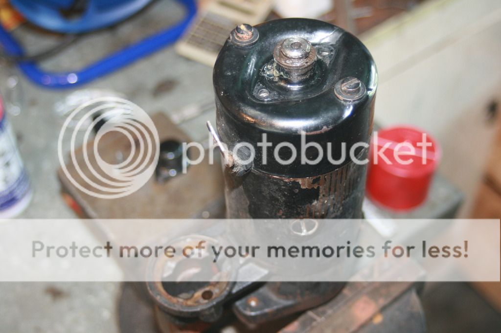

Remove the bolt and nut running through the solenoid holder of the starter motor. This screw locates the aforementioned lever.
With a bit of jiggling remove the solenoid and lift it clear of the end of the lever.

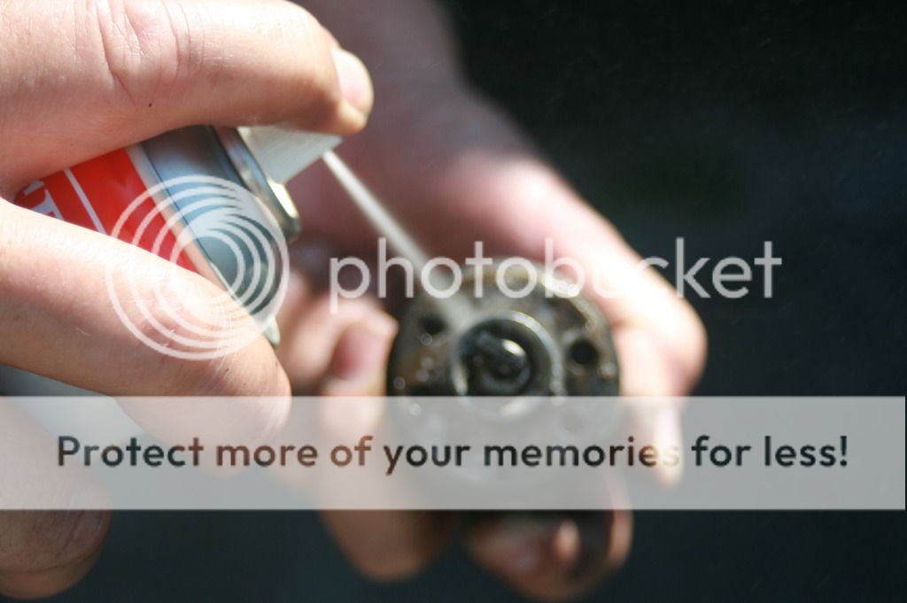

Clean the solenoid thoroughly using something like brake cleaner, which evaporates and leaves no residue. Then lubricate with a non-drying, spray on lubricant and work the solenoid plunger in and out against the spring to ensure the lubricant penetrates well.

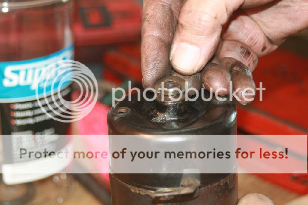

Set aside then remove the end cap,
the circlip and any spacers.

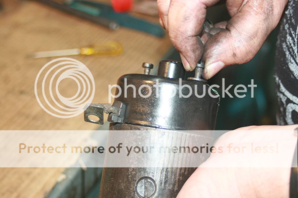

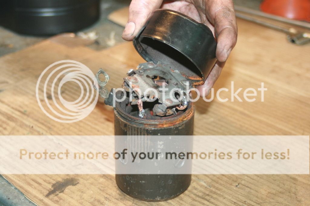

Remove the long screws holding the brush cover to the body and remove the cover.
Mine was stuck to the body so both came off together.
Remove the rubber bung

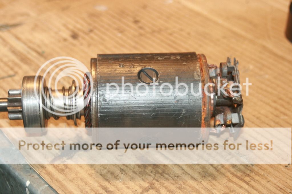

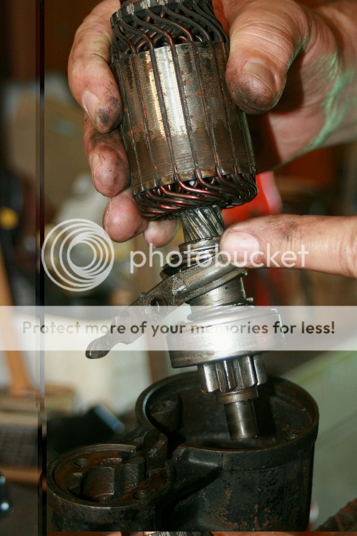

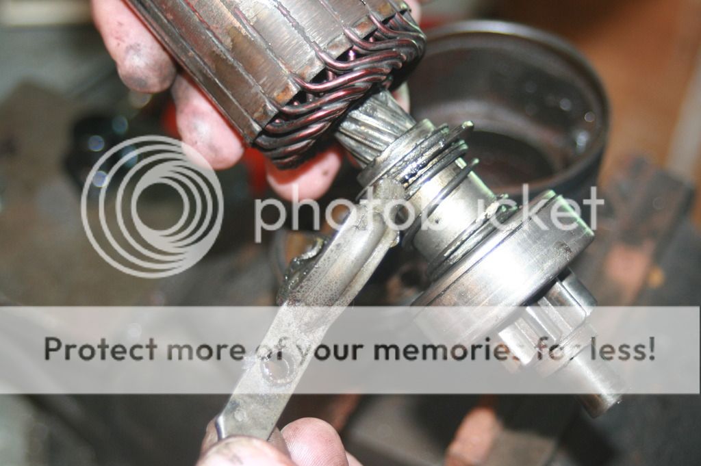

and withdraw the armature and lever.
Separate the two and clean thoroughly. Set the lever aside.

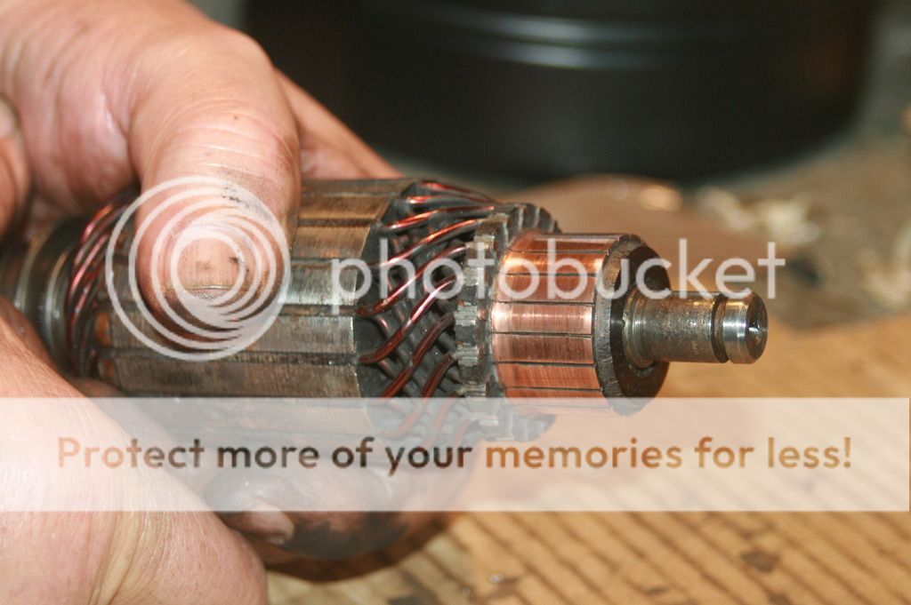

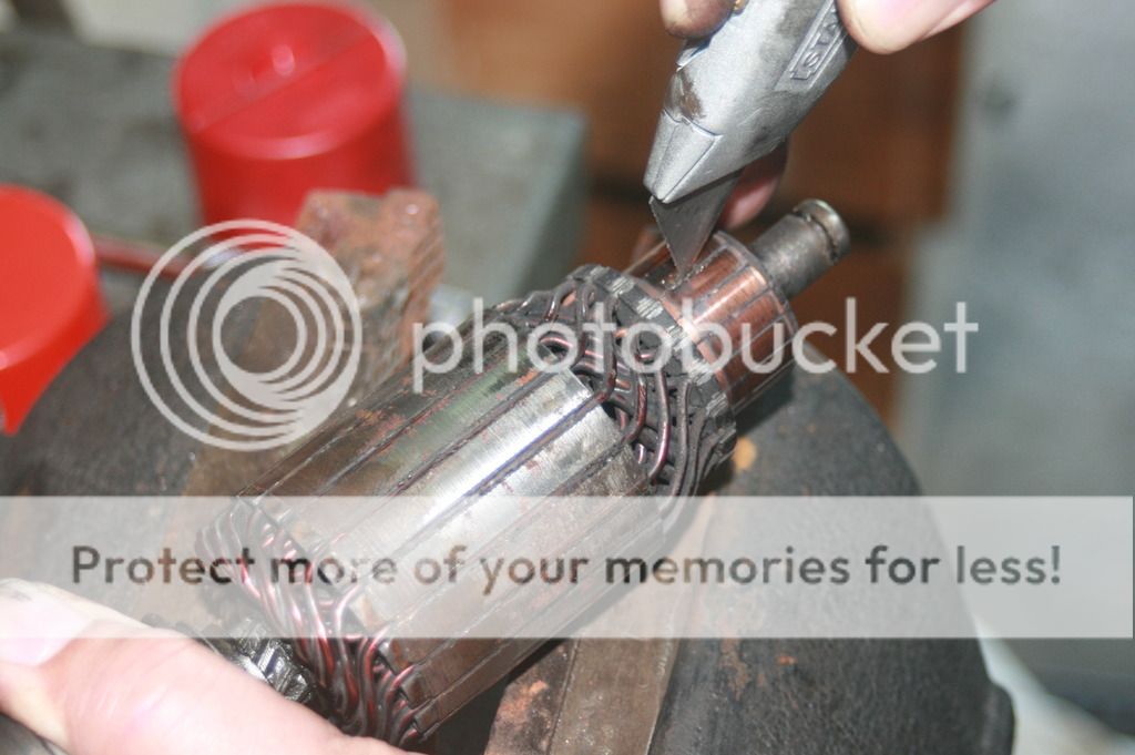

 Inspect the armature. The bit at one end, with a lot of copper segments, is called the commutator. If the small slots between the segments are clogged with dirt, use a thin blade to score gently, removing the dirt. If there is a groove worn into the segments they can be machined smooth in a lathe using a very sharp tool and  very light cuts. The slots will probably need to be scored again after this operation.
Clean thoroughly and wipe with a clean cloth.
Separate the brush cover from the body, if it has not already separated.

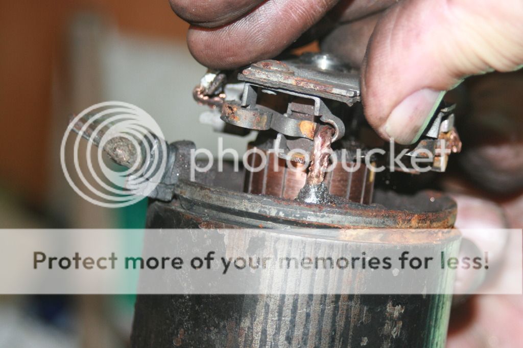

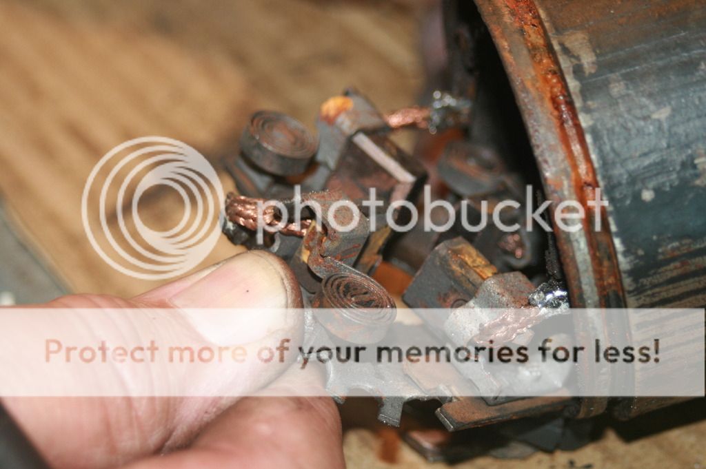

Inspect the brushes for wear. If they need to be replaced you will require a large soldering iron. If you are not confident doing this an auto electrician will do the job reasonably cheaply.

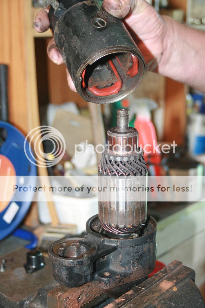

Insert the armature back into the body with the commutator at the end with the brushes.

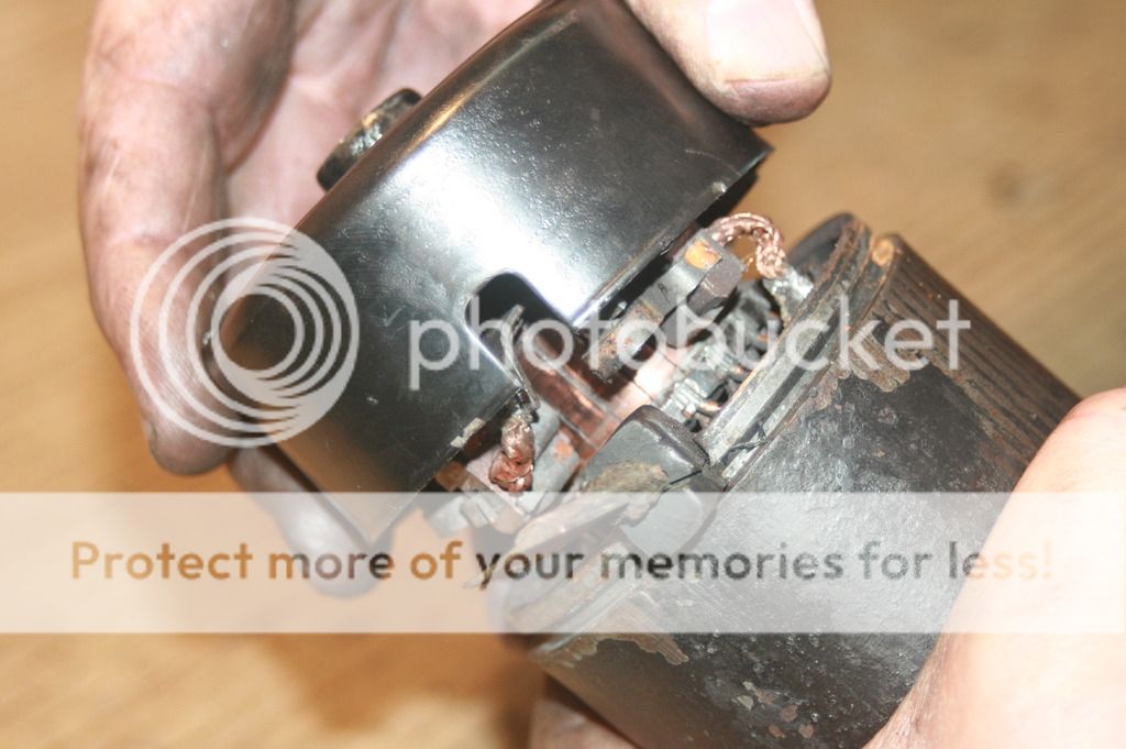

You can clearly see the springs which locate the brushes against the commutator in this shot. The easiest way to get them out of the way is to pull them out with needle-nose pliers and locate them against the metal brush holder, thus removing pressure from the brushes and making them easier to fit into place.
When you have them in place, replace the brush cover,
the spacer and circlip.

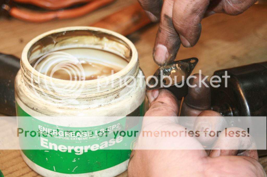

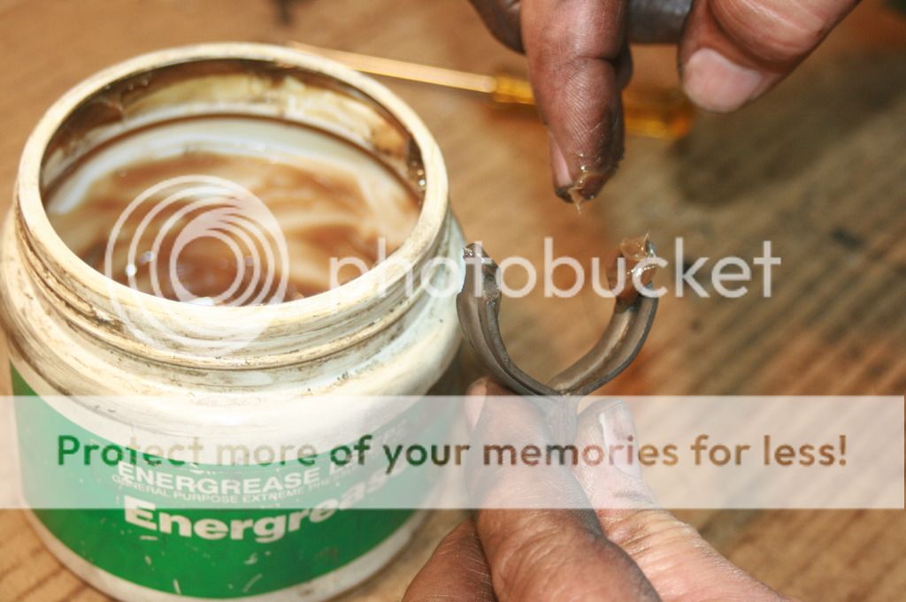

Place a blob of grease into the end cap and replace it also.

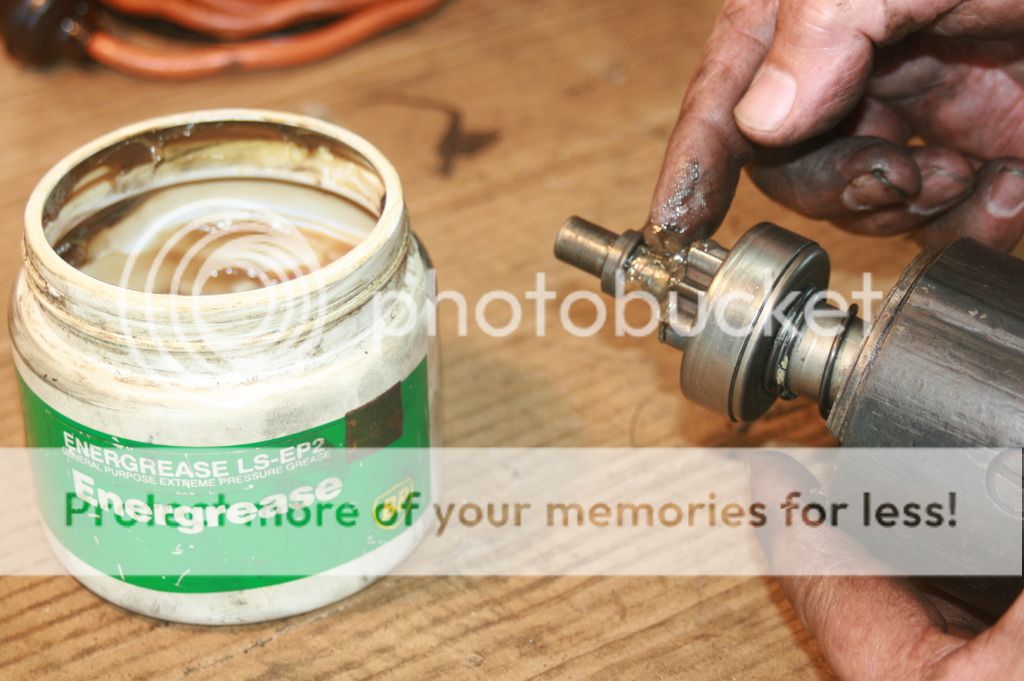

Also grease the following three places.

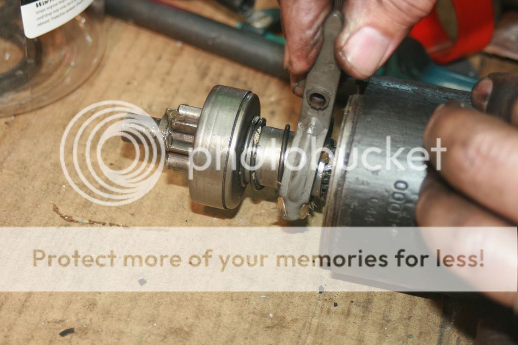

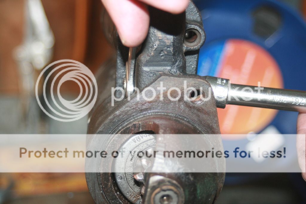

Reassemble the lever onto the armature

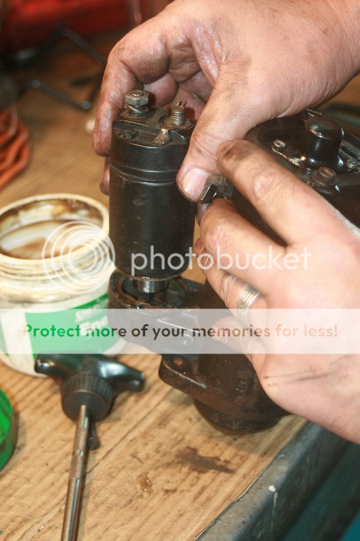

and grease the bush in the large solenoid mount.

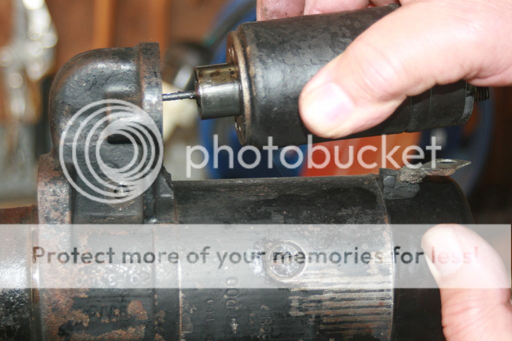

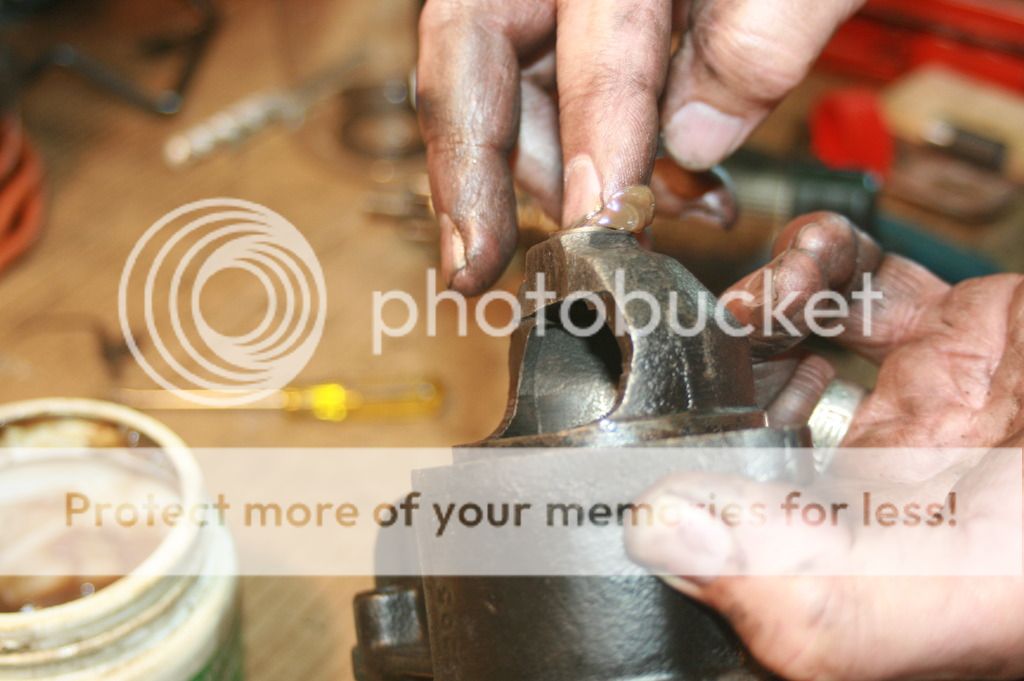

Place the solenoid mount onto the armature with the lever in place. Don't forget to replace the rubber bung. There is a small slot in the end of the body which locates the rubber bung so you can't do it wrong.

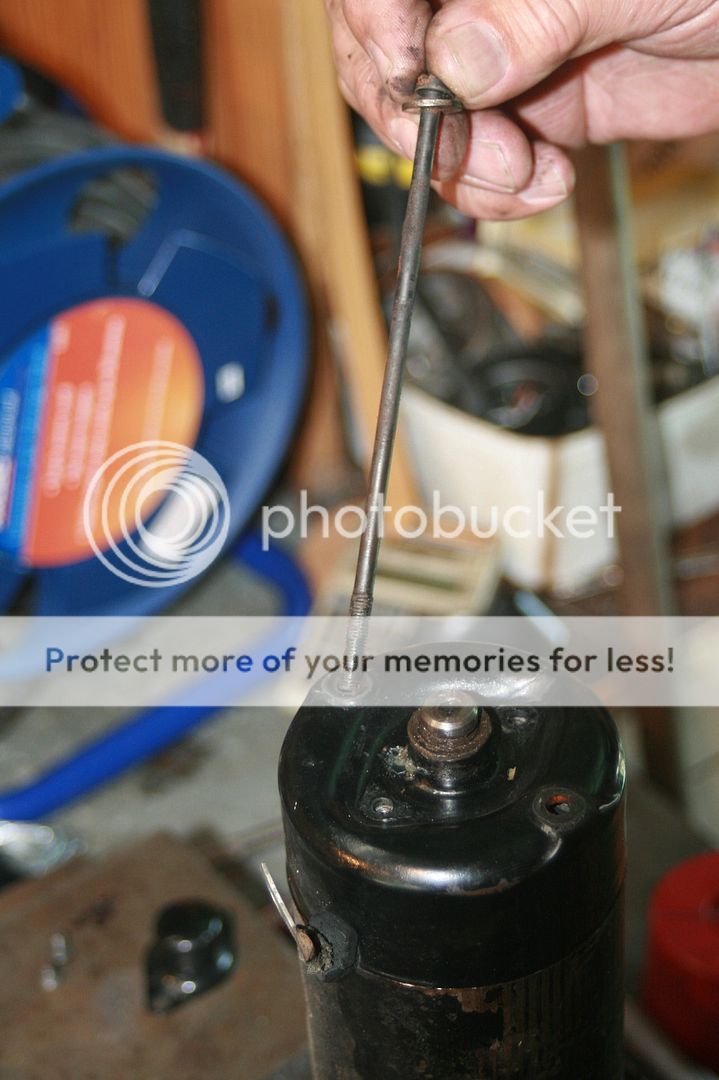

Insert the two long screws through the end cap, through the body and into the solenoid holder. If all is well everything will line up and you can tighten the screws.
Place the slot in the end of the solenoid plunger over the end of the lever and use it to line up the hole in the lever with the bolt hole in the solenoid holder. Replace the bolt and tighten as well as replacing the two countersunk screws holding the solenoid in place.

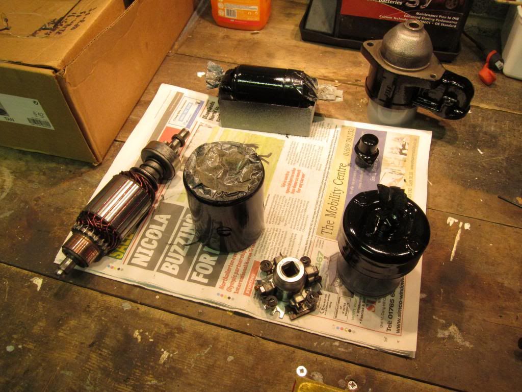

Had mine apart last year and gave it a lick of paint at the same time.

Or ceramic coat
did that in June 2012
Came up pretty good today
Worth the money IMHO

Re: T3 Bosch Starter Motor Overhaul
« Reply #13 on: March 29, 2015, 10:30:16 AM »

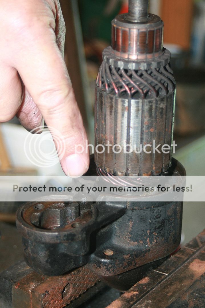

Am I the only one that noticed what was really wrong with the starter ???
  • Posts: 28887
« Reply #14 on: March 31, 2015, 07:46:49 PM »
Yeah....probably. ;)
« Reply #15 on: April 01, 2015, 01:31:41 AM »
Then take another look at the pictures, see who spots the problem ???

First guess. Carbon from the brushes packed into the segments of the commutator?
« Reply #19 on: April 01, 2015, 07:06:20 PM »
Look at the steel of the armature, see anything there?
How do you think it got so polished at one end?
« Last Edit: April 01, 2015, 07:07:42 PM by Kiwi_Roy »
Offline pete mcgee
  • Posts: 458
« Reply #20 on: April 01, 2015, 07:07:09 PM »
I see 2 issues.
1 its had water enter it and has a layer of surface rust on most surfaces.
2 the rotor has contacted the stator, one or both of the end bushes have worn allowing the contact.
Hows that?
« Reply #21 on: April 01, 2015, 07:10:03 PM »
I see 2 issues.
Hows that?
Right on, look how nasty the shaft looks at the armature.
The friction is stopping it from spinning
A good Kiwi fix would have been a strip of beer can between the shaft and bushing, it would go like that for ages  ;-T

Thanks for the great write up and pics.  I have two or three Bosch starters needing service and will get right on it.
KR, yep, I noticed the polished armature and chewed up shaft.  Good to know also that the bushings are available.  That's what both my worn starters need.

Roy was quite right, on closer inspection the bushes were flogged out. I ordered some new ones and, when they arrived, soaked them in oil for a few days prior to installation. I also polished both ends of the armature with some fine emery tape and got most of the scuff marks off.
The first time there was some minor hesitation then the (cold) engine fired up. The next time I tried, I touched the start button and the engine was running before I even heard the starter motor turn over. Fixed this time.
Thanks Roy for pointing out what should have been obvious.
