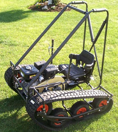

« Reply #22 on: April 18, 2015, 02:37:28 PM »
  In stores around here the aisles are too small to permit turning.
 BTW, I like the picture Avatar posted.  I will research that one.
 Or I could harness two strumpets to pull my wheelchair.
  Research show that it is an Italian prototype not in production, mores the pity.
« Last Edit: April 18, 2015, 03:08:37 PM by Sasquatch Jim »
