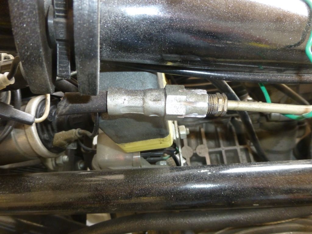

I decided it was time to replace the brake lines on my Convert as they're nearly 40 years old. This is not a job I enjoy doing largely because the joints are often hard to disassemble. Even with a flare wrench it is easy to round off the 10 mm fittings. I used the old trick of cutting slots in the female part of the fitting with a Dremel--that heats up the joint and also weakens the fitting. Cut the slots close to the threads to weaken the joint. After doing that, the thing unscrewed w/o rounding the bolt. (If you do end up rounding the 10 mm fitting on a hard to replace hard pipe, you can grind or file the flats to fit a 3/8 wrench)

Mine came apart with no hassle and the solid line now sits in a corner as I've de linked the brakes.
Can't see a problem as long as decent tools are used to do the job and even if I'd needed to take a dremel to that joint I'd have removed the solid and flexi pipe as one and done it on the bench, not covered my bike with swarf.

I think the "right tool" is the flare wrench I referred to, and it often doesn't work, even after soaking the joint with penetrating oil. If you try that, and it doesn't work, you've damaged the male fitting on the hard pipe. Not good for re-assembly.
If you're not de-linking the brakes, which I wouldn't want to do, you'd have to unscrew the (2 ft? long) hard pipe from the splitter in the back (which is hard enough to get to, let alone get a wrench on, and then you'd run the risk of compromising that connection), cut the front line, and wriggle the thing out--taking care not to drip brake fluid all over--to do this on a bench. Then you'd have to re-install the hard pipe and re-attach it to the splitter, or as Mike suggested get a longer braided line (but that would probably add $50+ dollars for a custom line).
A few blasts of compressed air should take care of most of the swarf.
