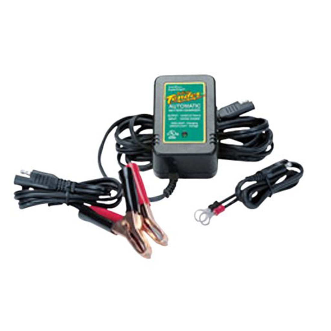

Two weeks of non use running a battery down is pretty normal for a vehicle with a computer.  If you use an isolator (disconnect switch) you will lose all your settings and and your computer will default every time you disconnect.
A much better solution is to get a battery maintainer.  You can get very decent ones on Amazon for less than you would spend putting in a disconnect switch properly and you will have a proper solution.
Here's one for $20 .  It will not charge a battery, that is not what it is intended for, but it will keep a battery charged.

A tiny bit of computer drain running down a battery in two weeks sounds about right to me.  i added a link to an example maintainer.

If your bike is parked where there are no outlets for a maintainer there are also solar versions for cheap.
