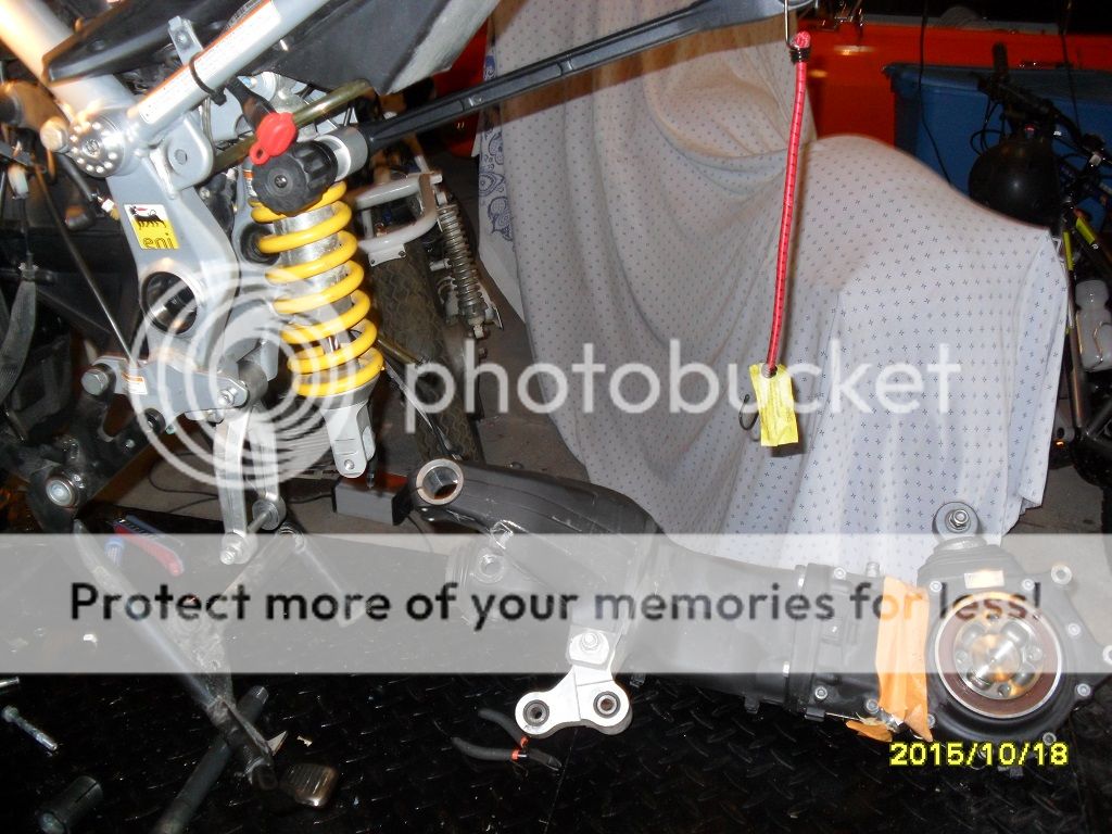

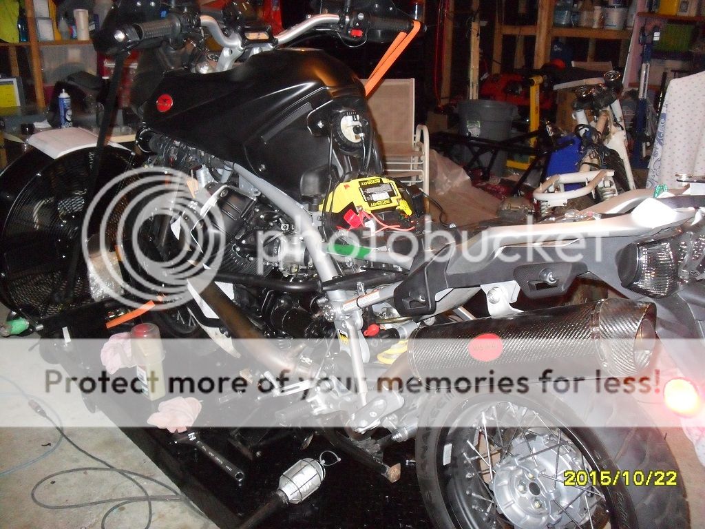

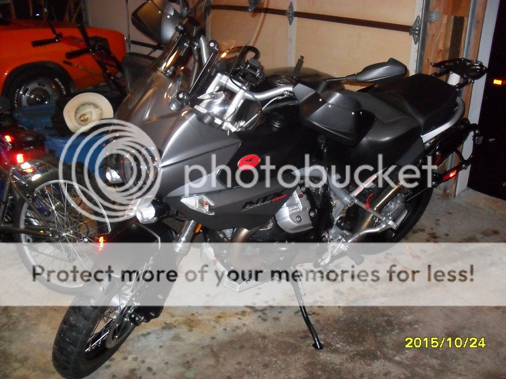

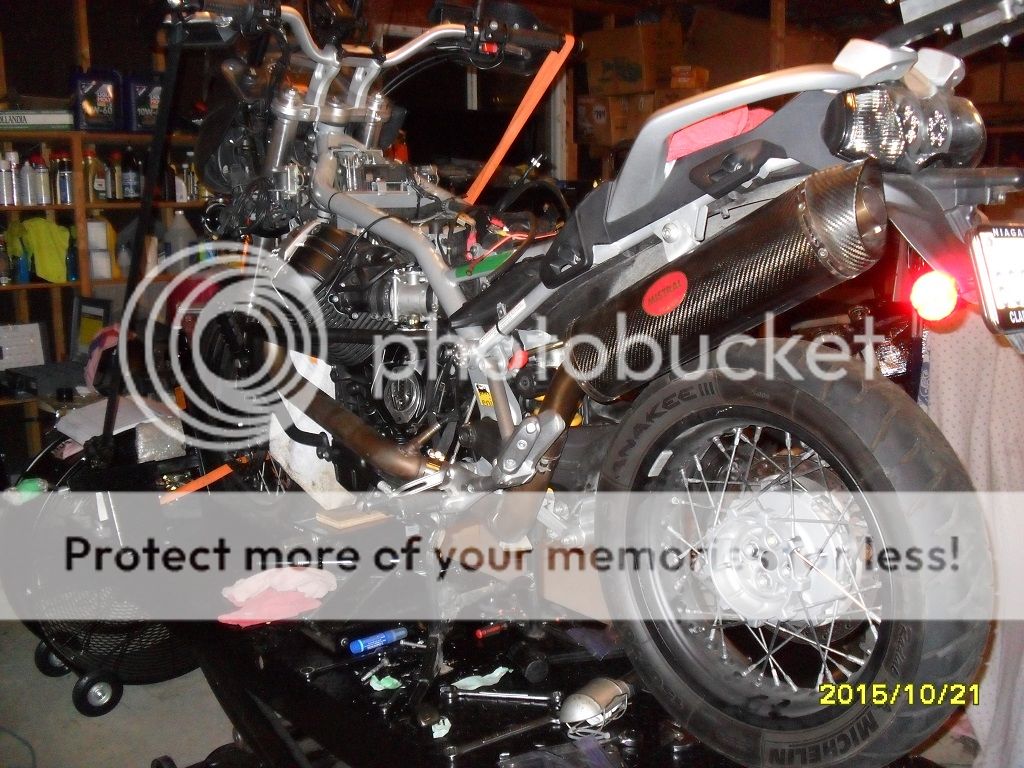

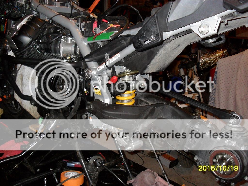

« Reply #181 on: October 23, 2015, 07:04:41 PM »
Okay, somewhat overdue for an update.
I spent a significant amount of time last weekend, and a bit of time each evening this week getting the bike back together.
Throttle bodies and engine sensors connected:
Oil cooler and I-don't-want-to-crash bars attached:
Shock and swingarm going in.  Sorry for the dirt -- I had just come back from a significant ride to/from the Western New York Rally when the clutch gave up and jammed the starter.
No cracks (yet).    :thumb: :
Exhaust on:
Tank on.  If you look carefully, you can see a CARC, a Loop, a Tonti and a spiney (covered) in this photo:
And (drum roll please), here we are after the successful test ride, this evening!
Once I got everything back together, and after getting fuel pressure back up, the bike fired immediately.  Everything seemed to work well, so I took it for a short ride this evening, and the only thing that wasn't expected was that the headlights wouldn't work.  All other lights work, as do the auxiliary units, so I am expecting something possibly with the headlight relay.  I'll check on that tomorrow, and go for a bit longer ride.  Once I get the lighting sorted, I'll put the rest of the bodywork and racks back on.
More to come!
