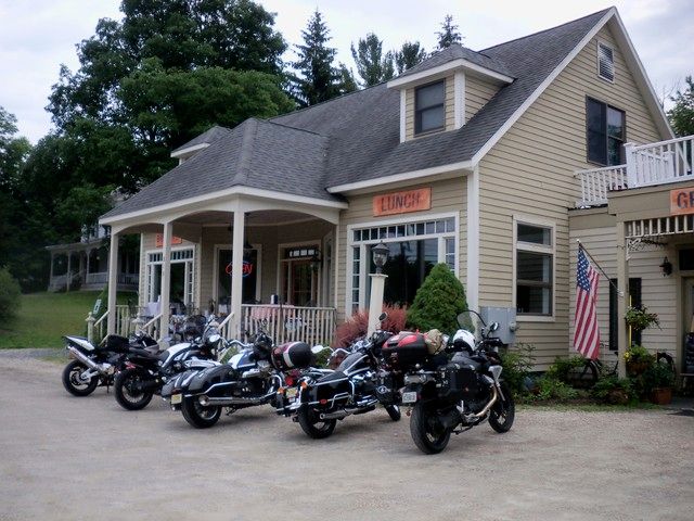

On the ride to the National, I hooked up with three Guzzi Guys, who had stopped for lunch in New York somewhere on the way …..

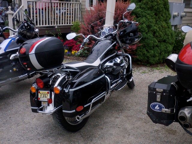

and a Cal 1400 …

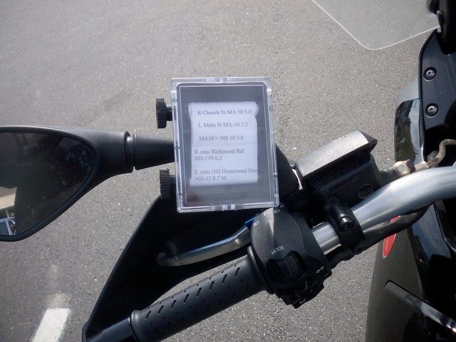

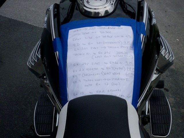

I happened to be carrying a piece of High Tech that day on my Stelvio …
It’s something that may not have gotten to everyone yet.   It’s an analog device, no battery required.   You preload it with the destination information that you desire (I understand you have to do that with so-called “GPS” systems too), and then you just turn a little knob, and the exact turn-by-turn directions to get you to your destination appear.
I felt a little bad about having this kind of advantage over my new riding partners, until I saw that the new 1400 had a system that didn’t even require turning a knob.
I may have to upgrade soon.
