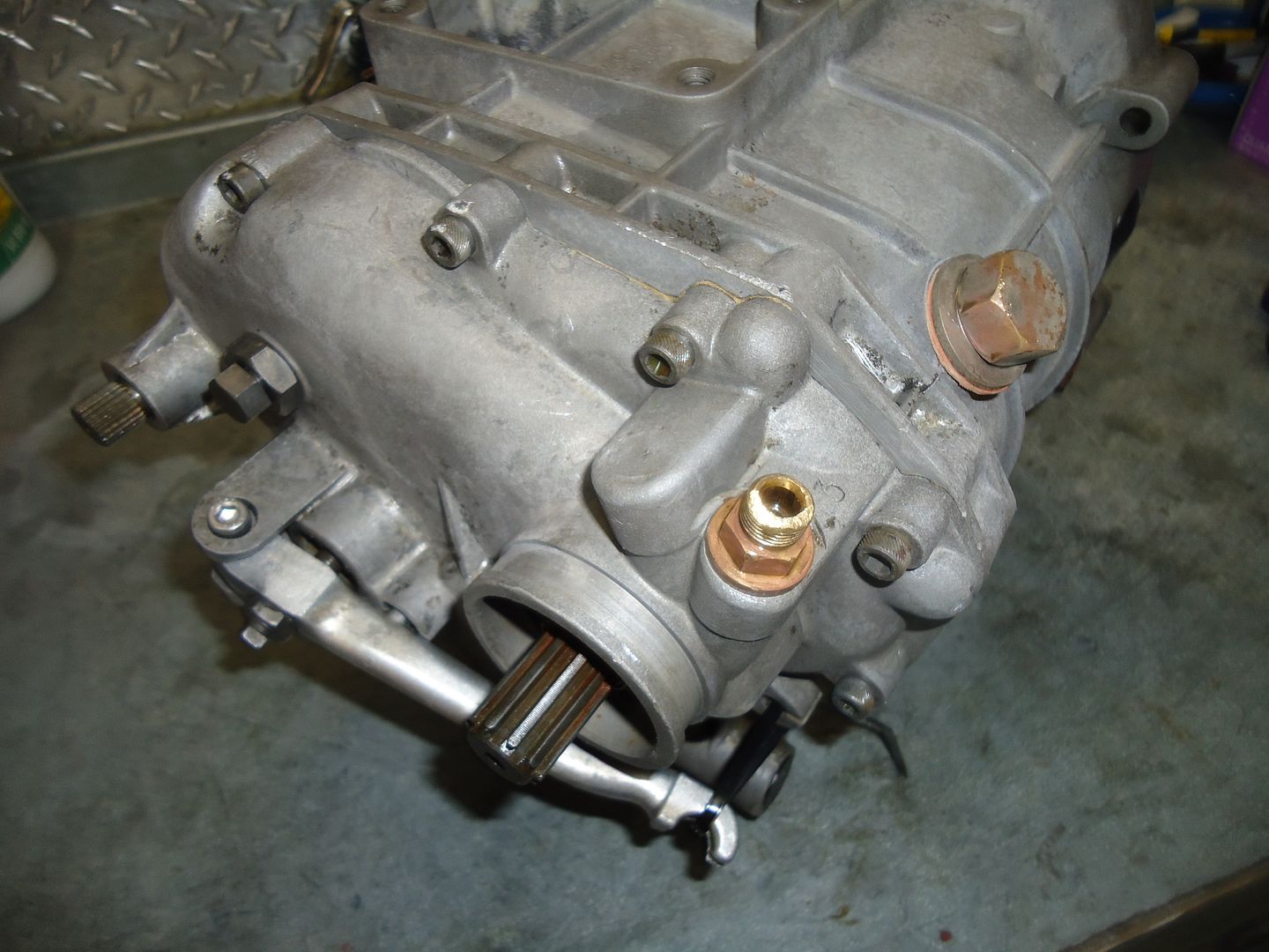

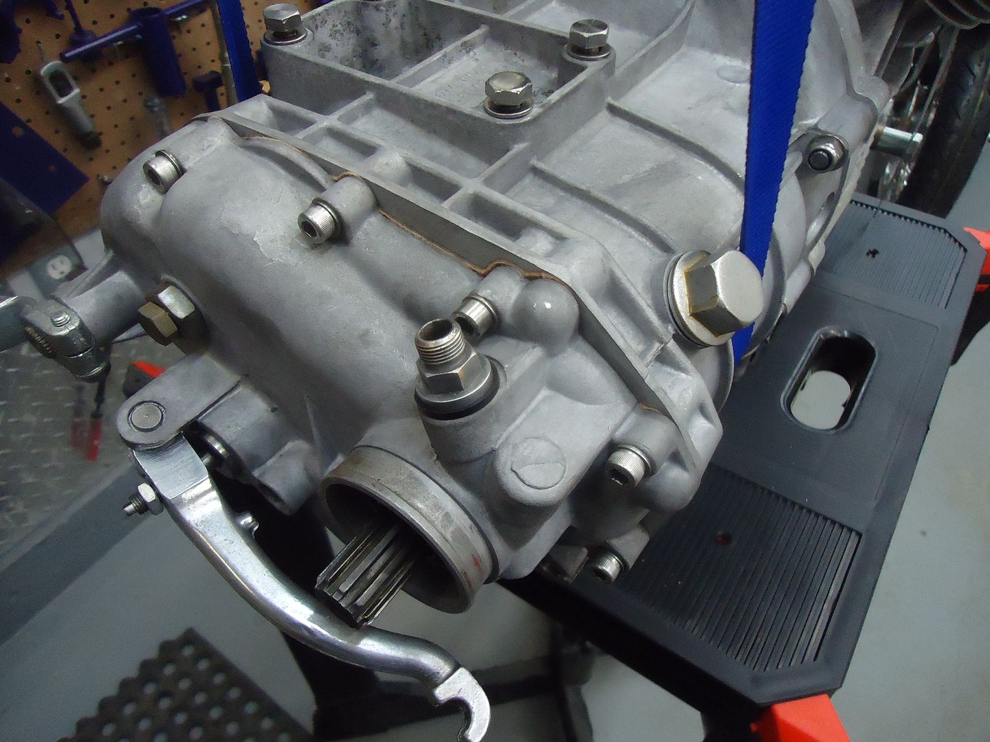

Re: T3 transmission magnet has shiny filings
« Reply #5 on: July 22, 2015, 05:13:33 PM »
The Eldo 5 speed back cover is different - the speedo cable location is rotated about the shaft position, you can swap a Tonti 5 speed cover onto an Eldo 5 speed.
Eldo
Tonti
