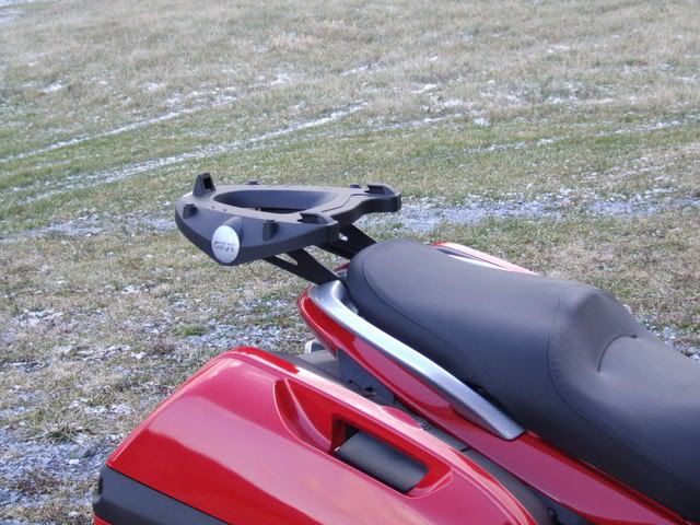

GIVI makes a dedicated rack that replaces the Norge/Stelvio "black tongue" that sticks out the back. Will hold any of their Monokey cases very well.  I have one on a Norge and on a Stelvio.
BTW, the mud flaps were hung on for a joke in that pic.  NOT part of my riding set-up!!   :grin:
