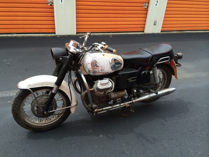

Well folks, Ive picked up a '71 Ambo barn find
One of the first issues to tackle is sourcing missing parts....  The only conspicuously missing pieces that I really lack are the foot controls. (well there is a lot missing, but most of that will be replaced with new, ie: wiring harness, cables, turn signals, etc)
I'm pretty sure this thing is a frankenbike, the frame & engine #'s dont match... I think it also has a 5spd tranny?
I am working on getting a bonded title right now.
It appears my pegs & controls were robbed to convert a floorboard bike to pegs?
I need to see pics of the foot controls off a peg Ambo to help in sourcing the parts from ebay etc...
It is hard to tell what parts are for floorbard bikes vs peg bikes....  I am not very familiar with loops, I only see one regularly, and it has floorboards.  I have only seen loops up close on 1-2 occasions and that was well before I bought mine.
If you have an Ambo with pegs, can you please post a couple close pics of the left and right side controls (pegs, brackets, brake and shift levers)
I'm sure my bike is a left side shifter, all the linkages etc are there... looks like just the levers, pegs, and brackets were removed

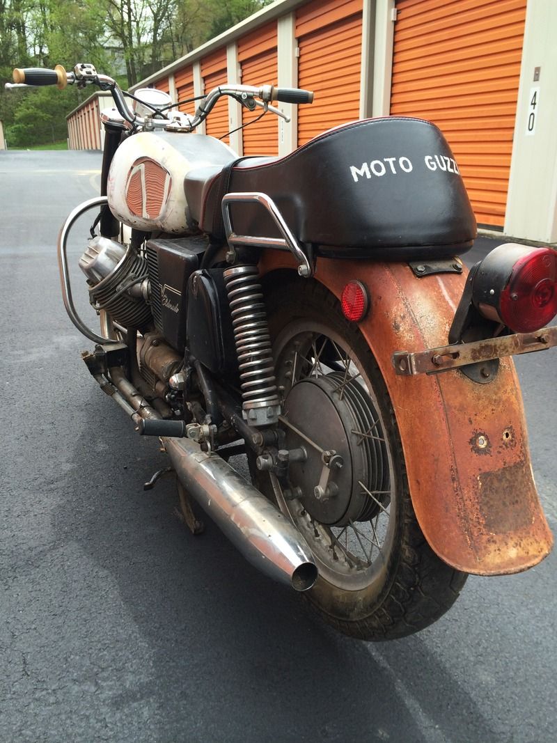

Definitely a five speed.
You don't show a clear right side view of the rear drive, but since no sump is hanging down, it's likely the correct one for an Ambassador. If it still has the Ambo 8/35 gear set in it, it will be geared too tall for use with the five-speed. Great on the highway, but horrible in town - lots of clutch slipping to get moving. It should have an 8/37 V700/Eldo/850-T rear drive to work well with the five speed.

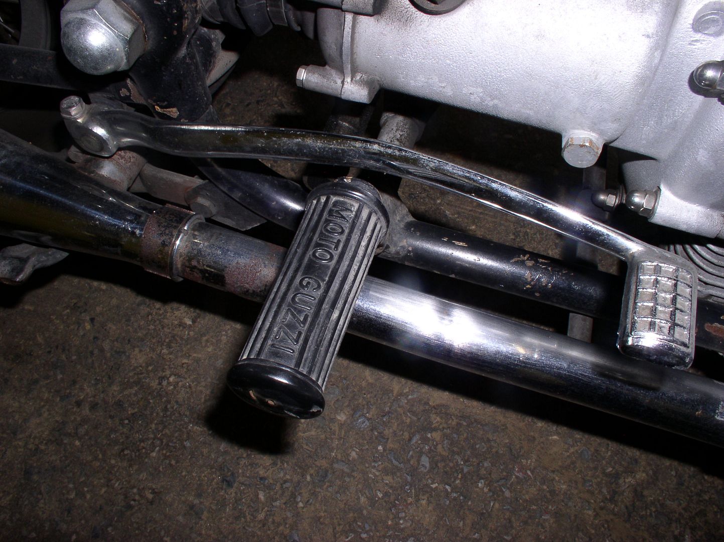

Here's what you need for the left:
Footpegs:
The brake pedal is in this photo:
The parts installed:

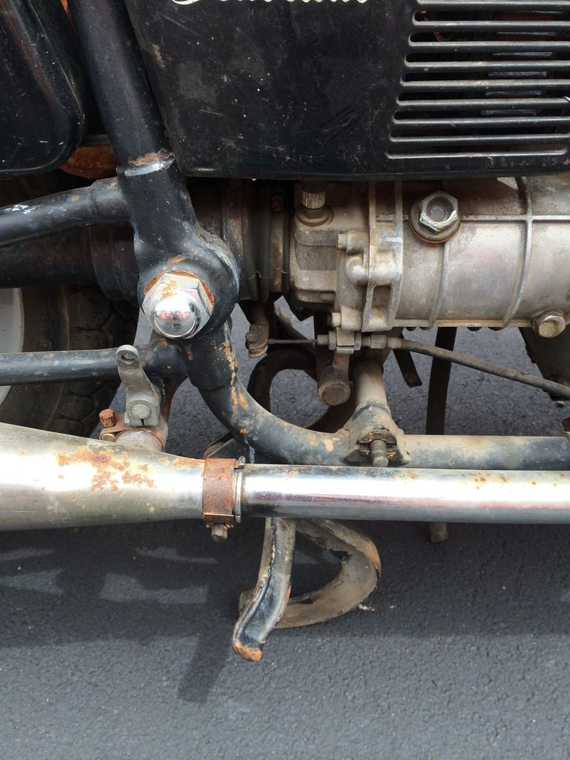

Your brake has an extra linkage, the one Charlie showed is like mine.
Before you buy a brake pedal, remove the "extra linkage" (short arm) on the brake shaft and measure the o.d. of the shaft. If the splined part of the shaft is 12 mm, it's for footboards, if it's 14 mm then it's for pegs. The brake pedal I posted photos of only works on the 14 mm splines.
The 12 mm splined shaft is valuable to anyone putting together a set of footboards. The arm is worth a few $$ no matter whether it's 12 or 14 mm.

Shift pedal:
http://www.ebay.com/itm/71-MOTO-GUZZI-AMBASSADOR-750-SHIFT-LEVER-PEDAL-/181617922062?hash=item2a4945900e&vxp=mtr
Brake pedal
http://www.ebay.com/itm/71-MOTO-GUZZI-AMBASSADOR-750-REAR-BRAKE-PEDAL-LEVER-/371217924176?hash=item566e500050&vxp=mtr
Both a bit pricey IMO. I'd check with Mark @ Moto Guzzi Classics 562-986-0070 and Harper's to see what they have before I'd buy on eBay.
The left footpeg has a two-piece plastic bushing that supports the shift shaft on the pedal end. They usually come already in the footpeg. One piece is easy to find, the other isn't.
