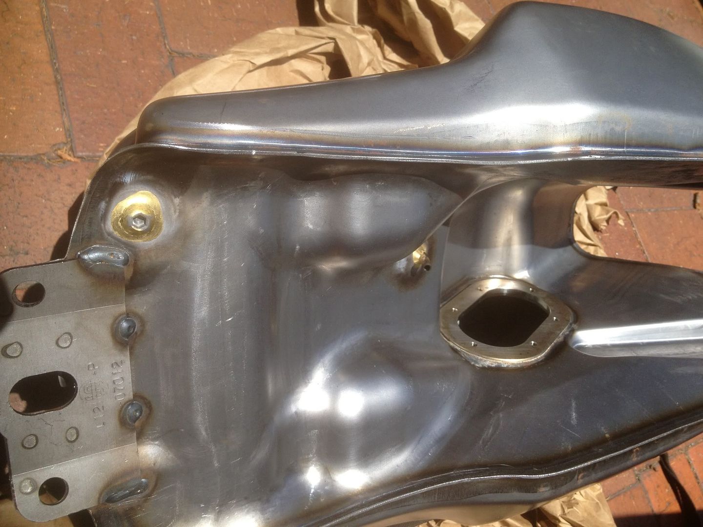

I have only just topped the 600 mile mark on my V7 Stone, and I seem to be having problems with the fuel reserve. I ride about 175 miles and the reserve light comes on. The bike has twice run out of gas at about 185 miles (the only two times it has gotten to 185 miles on a tank). I can get it going again by shaking the bike side to side and riding the bike to a gas station. The fill up both times has been 3.8 US gallons. I have been reading through old threads that 5.2 gallons should be the usable amount of fuel in the tank. Is there something stupid I like a reserve switch that I am not using? Barring that, anyone have any idea of how I get the fuel pick up out of the tank to inspect it?

Empty the fuel tank, remove it, turn it upside down & in the inside of the LHS channel facing the main frame tube is a rectangular plate bolted in. You'll find the fuel pump behind that. Others on this site have investigated this previously, with some little success, but not a definitive fix to date.

I thank "Malik" very much for the photo of the bottom of the tank. That was a huge help! I will attempt to do something about this after I return from vacation, but thank you all for your words of help.
