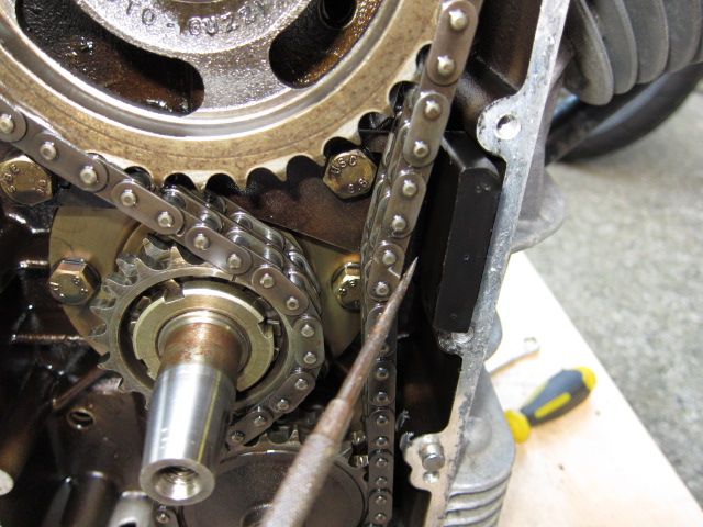

Bill, this was what my LM2 timing chain / stock tensioner looked like after 34,000 miles.
Actually to call it a tensioner is doing real ones a dis-service. It's a block of hard rubber that does not self adjust.
You can see the slack in the chain, which also can't do the ignition timing any favours.
I'm hoping Guzzi updated the tensioner before they made your bike!
If you look at the inside of the chest below the 'tensioner' you can see where the chain has caught on it and started to wear it away.
I replaced the chain and fitted a Valtek.
I used a Mercedes Benz chain, which need cutting down, and it came with a split link...no problem; and you only have to remove the oil pump sprocket if you fit the split chain rather than an endless one.
If you fit a Valtek, remove the spring while fitting the blade and support bracket and refit it after you've replaced the chain, makes life a lot easier.
the 98 EV does not use the rubbing block, it has a proper spring tensioner.
