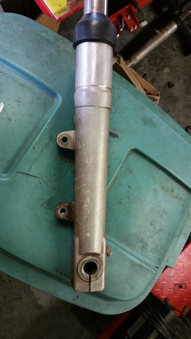

Offline EldoMike
  • Posts: 817
  • Location: Southern Illinois
Re: Fork leg differences between t3 and g5
« Reply #7 on: September 07, 2015, 01:04:29 PM »
This is a late model G5 leg ......
