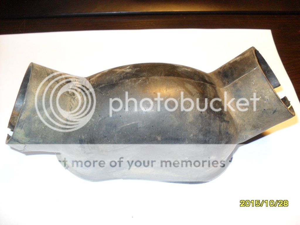

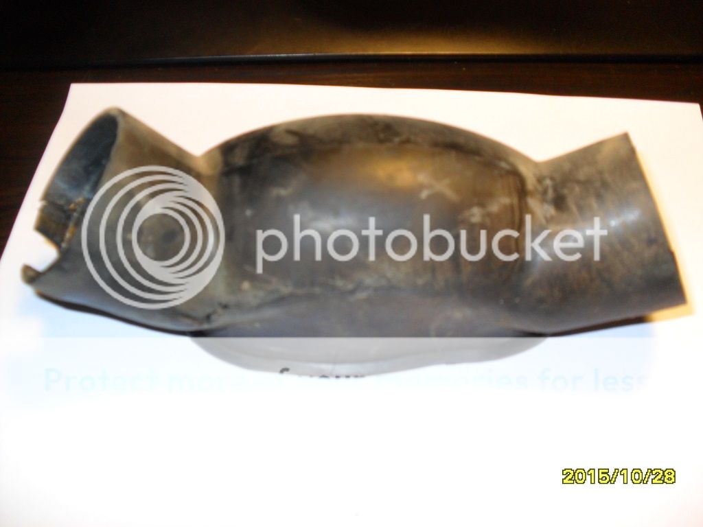

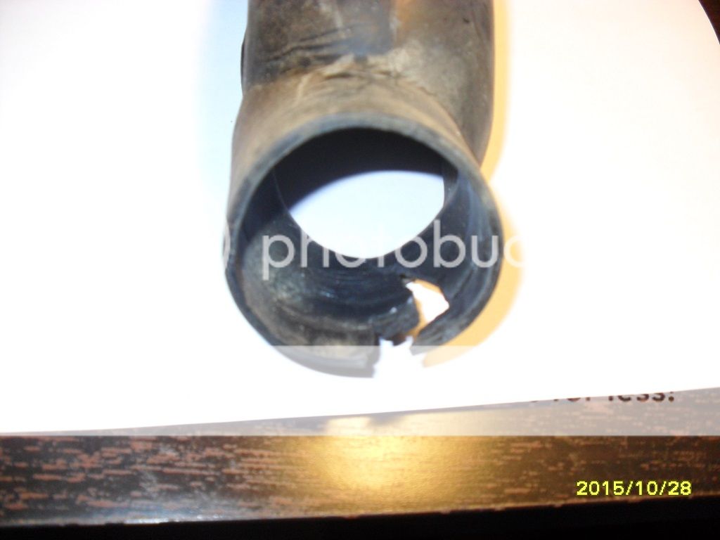

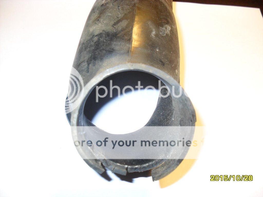

Offline smdl
  • Posts: 1345
  • Location: Courtenay, BC
Re: New Addition - Civilian Eldo
« Reply #29 on: October 29, 2015, 07:51:48 PM »
Sorry to take some time to come back on this, but Greg has indicated that he will reproduce  the Amal boot.   :cool:  I sent him pictures of mine, and he indicates that he can make it work, but it is not perfect (it has cracks in it, and one missing chunk).  So, before I send it off to him, I thought I would check and see if anyone has one that might be better.
Here is what mine looks like:
Let me know if you have something that will work better.
Cheers,
Shaun
