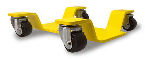

Hi, have any riders used or own a turntable capable of spinning a Norge in a cramped shed?  Tried fabricating a 18 inch lazy Susan on a thick steel plate but need something more professional.  Any tips or advice welcolme.

Haven't done it but I'd put rollers around the perimeter and a bearing in the center.

Probably need to make something like this
http://www.matturntable.com/index.html

Re: Motorcycle turntables
« Reply #7 on: November 02, 2015, 04:48:24 PM »
Save yourself a big hassle.
Go to tap plastics or Interstate Plastics, some place like that.
Have them cut you a piece of UMHW. make it 1/2" thick and long and wide enough to put your bike on it.  Where the tires rest, put a piece of 1/4" plywood, screw it on and countersink the screw heads.
Roll your bike on it. Then you can push it anywhere you want with one hand, spin it if you like. Cost you about $45.
If you always put the bike on the center stand, square of the UMHW underneath some plywood. UMHW need only be 1/8" thick. Instant turn table. If there is too much friction with the floor, some dry lube and you can spin it like a top and push it around like a toy. Cost about $15.
I have a picture of mine, if I get some time I'll find and post it. Works like a charm on concrete but would work on any solid floor, even carpeted.

Take a look at the Harbor Freight motorcycle unit. The HF device can be used to move the bike into or out of plus the bike can be be turned in it's own length.  The HF unit is about $75.00 w/coupon.
