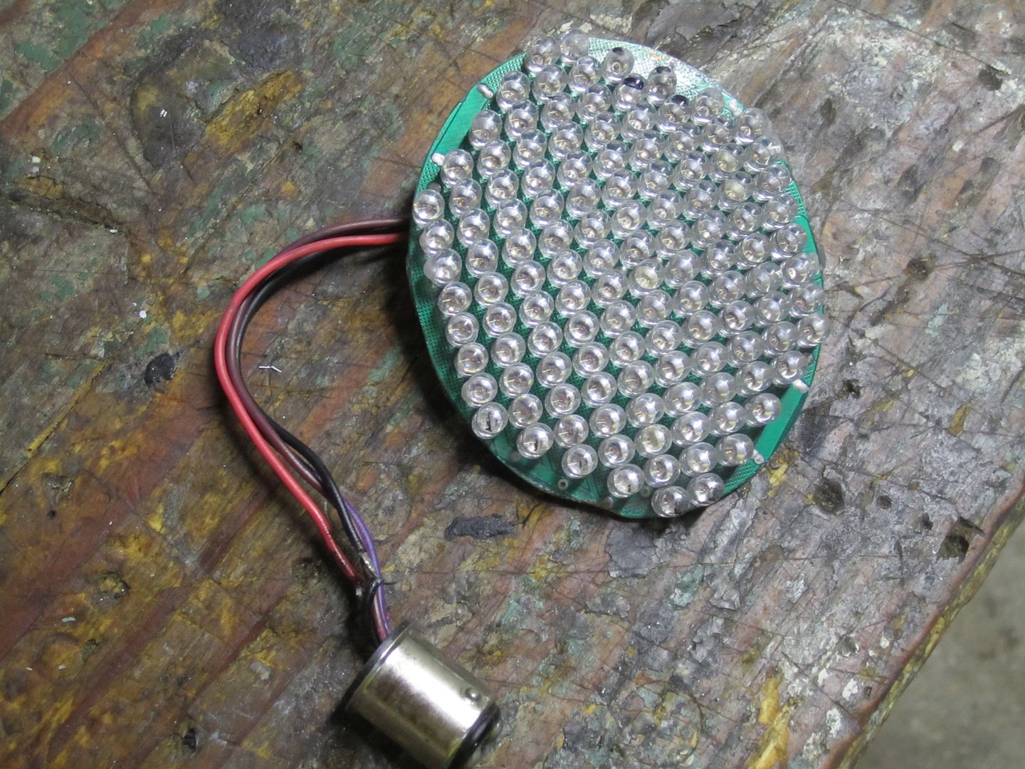

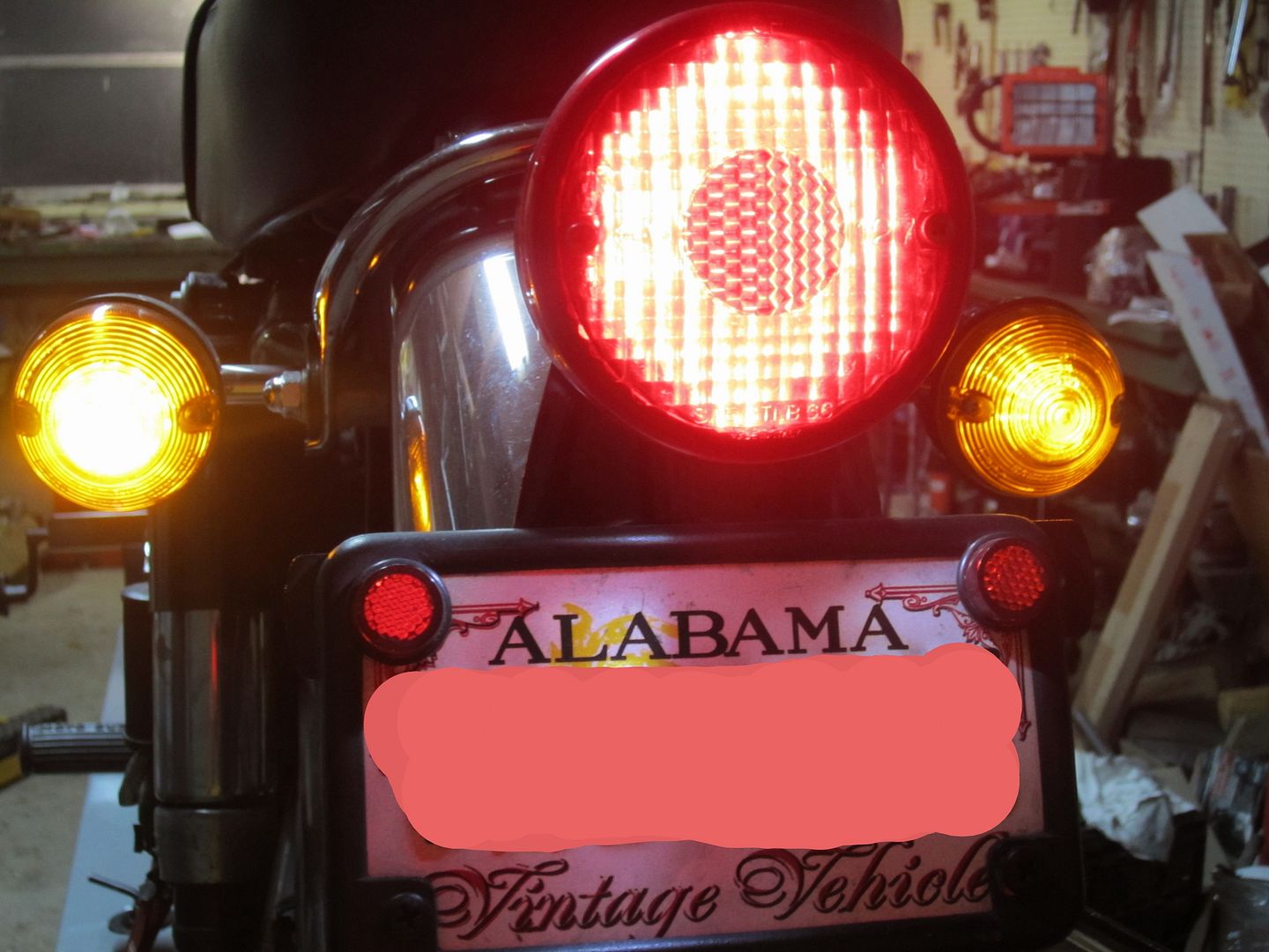

Ok boys.  I have another little upgrade that I've been running for a while.
I found an LED light board that fits nicely into the original NFalcone and other vintage Italian tail light housings. This was something I picked up from my Harley-Davidson parts snooping at Daytona Bike Week.
You can adapt a Custom Dymanics light board for the Yamaha 950 to fit inside the Italian tail lamp.  It provides much-needed brake and running light illumination to the rear of these bikes. ( I also have LED bulbs in my period-correct turn signals that I have converted to serve as running lights as well as turn signals.)
You can improvise several ways of attaching the board inside the housing. The best way I found was not rigid mounting but using three custom-bent 90 degree pieces of aluminum flat stock with double-sided sticky tape to attach to the housing inside walls.
A small LED directional pod lamp for license plate illumination can also be obtained from Custom Dynamics (and others) to wire-in the board pigtail and sticky attach to the back side of the main LED board.
Item:  GEN-YAM950-1157
Price: $119.95 ea
http://www.customdynamics.com/Yamaha_tail_retro.htm
For the tag light, use a 3 LED white Pod Light-
http://www.customdynamics.com/courtesy_lights.htm

Problem with all these LED lights is the brake light. As tail lights they may be superior. That's why I say don't change original unless have serious problem with lack of amps replace the reflector with an led reflector that looks identical to the original reflector.
Offline leafman60
  • Posts: 6814
Re: Vintage Tail Light Upgrade
« Reply #5 on: November 22, 2015, 04:26:21 PM »
The Custom Dynamics boards have a very robust stop lamp intensity.  There's a big difference between the running light and the brake light. Works great.
