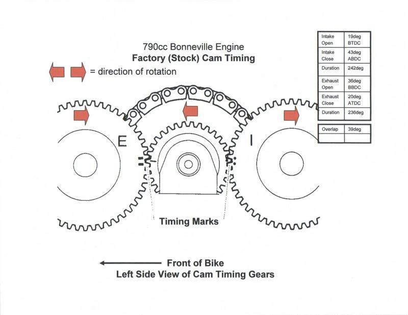

« Reply #6 on: November 24, 2015, 05:46:41 AM »
790/865 Bonneville cam actuation system.  Copy and paste with added open/close specs.  Showing cam driving gear, timing marks.
I made up several slides when I attempted to modify the cam timing of my 790 Bonnie in an attempt to move the torque band closer to that of the newer 865's.  Wasted effort, but the good news was, I didn't break anything!
It was unfortunate (for home mechanics) that Triumph didn't make all 8 valve shims accessible without the need to remove the camshafts.  Unfortunately, one or two of them couldn't be reached without popping the cams out.  The strangest thing was removing the torx bolts holding the cam caps ... though they were torqued very low, the damned things required me to use an impact hammer to break them loose, first time anyway.  Other guys borrowed a second set of hands.  While one person put all his weight on the torx driver, the other turned the driver with a wrench.

Actually that looks like a nice system, relatively easy to service.

Pretty easy to service, actually.  I found from the TriumphRat forum that shims from several Japanese bikes would work, and knew a dealer that would swap shims at no charge with me.  Nice folks.
Here's a brief quote from "Motorcyclist."
....... and a hybrid cam drive with a central chain running up to idler gear(s) which then drive the twin cams.  While the engine qualifies as 'all new' it's a familiar kind of new.
I'll take that as gospel when I see a service manual with some drawings.
