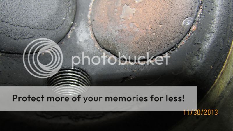

In one of the heads on my 750 motor, the exhaust valve has seen better days.  I haven't pulled the valve yet to see what condition the seat is in but I thought I would see what the more experienced member here think I am looking at.
I have picked up a new valve a while back but am now getting back to the project.  From experience - what do you think -  will I be able to lap a new valve in or will this need a new valve seat?  What else should I be looking at in doing these heads for a rebuild?  How about guides - are they problematic on these motors?

     Looks like you had a feather edge with a glowing valve and detonation. Even looks like you may have a crack in the head between the sparkplug hole and the valve. Seen that before, but not on a Guzzi. Just take it apart and clean it up a bit and use a magnifying glass- Hopefully I am wrong.

No way will a new valve lap in. Just do the right thing and get the heads serviced. New valves, K-lines and a proper three angle cut on a SERDI bench and you'll be right for another thirty years.

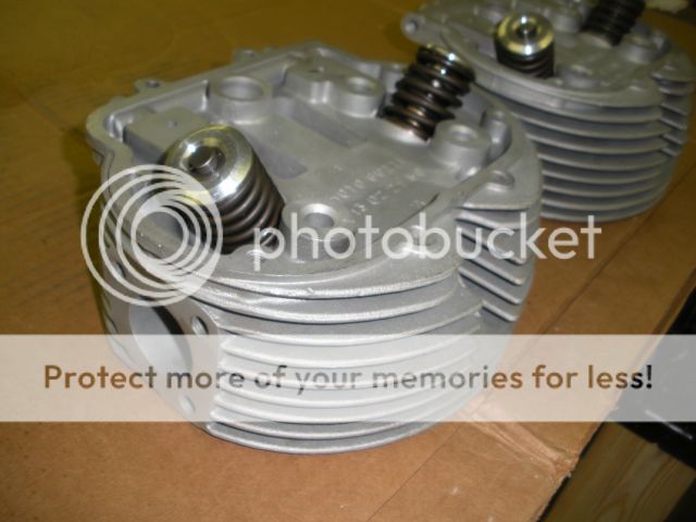

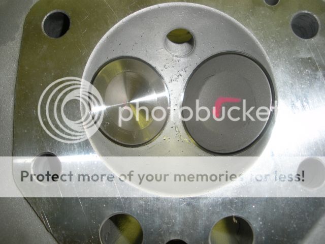

Picked up my heads, motor and other bits from Flap Jack at Automotive Machine in Franklin Mi today.  Thanks for the introduction Dusty.  Jack and his son did nice work on my Guzzi parts and I enjoyed seeing some of the bikes he has around his shop.  Here are some of the results...

glad it worked out.  Did they magna flux both heads?  (Easy way to show cracks)

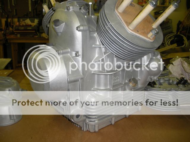

Some before and after pics...  nothing like 'new' clean parts...
Once again - good work by Flap Jack and his guys at Automotive Machine.
I ended up having the engine bead blasted.  Question to the group - is any treatment of the aluminum warranted or just let it age in the natural state?
Before:
After:
More after:

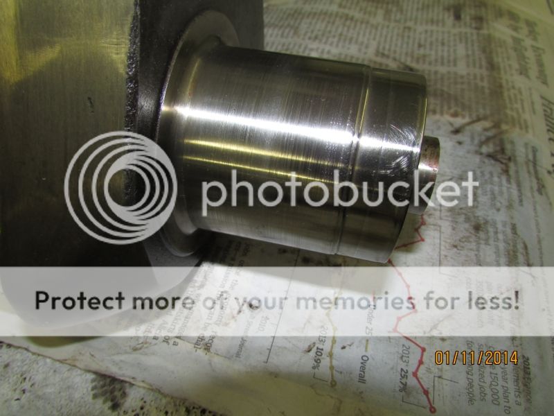

The mains were not bad but on the low end of spec so decided to clean it up and get new bearing throughout...
Before:
After:
An after a fine grind...
