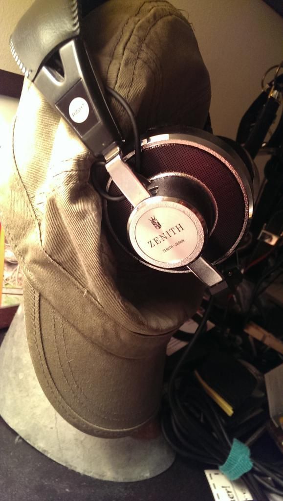

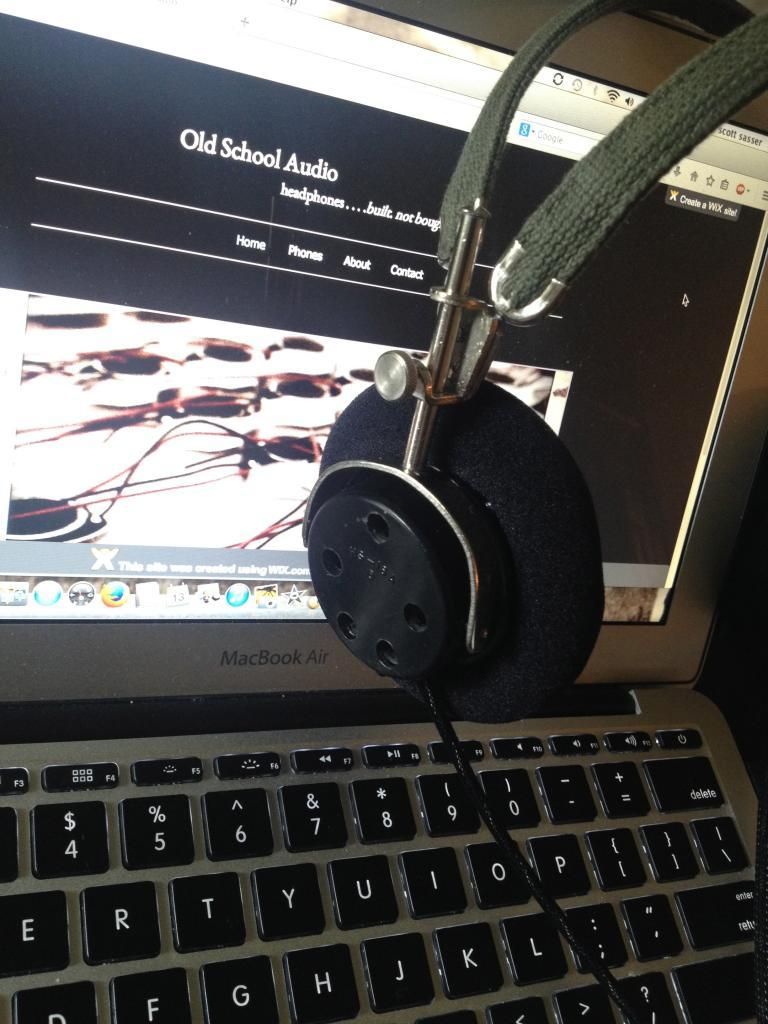

I love tinkering with old phones- that's my hobby when the weather's crappy.  I've really enjoyed restoring some older phones for acquaintances in addition to the ones I build as "Old School Audio".  There's plenty of inexpensive (Guzzi Content) little amps to play with, or you can spend mad dollars if you're so inclined.  A nifty one is by Bravo: http://www.parts-express.com/bravo-audio-v1-mini-valve-deluxe-class-a-tube-headphone-amplifier--310-354
Here's some 70's Zenith phones:

Set of Old School phones:
Old School Audio:
