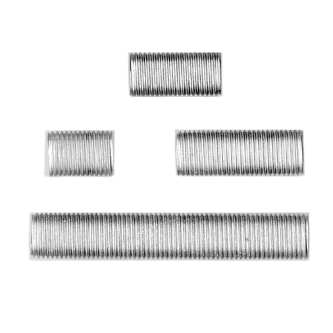

I just fix the OEM stalks. Get a length of threaded rod (lamp hardware from any Mom&Pop hardware store) and run it inside stalk. Cut to length, washer and nut inside light fixture and another washer and nut inside where you mount it. Run/Connect wires and it's done. Easy-peasy, still looks OEM and very low cost.
Excellent!
Good idea just remember to have the threaded nut on the rod before you take the hacksaw to it. :wink:
