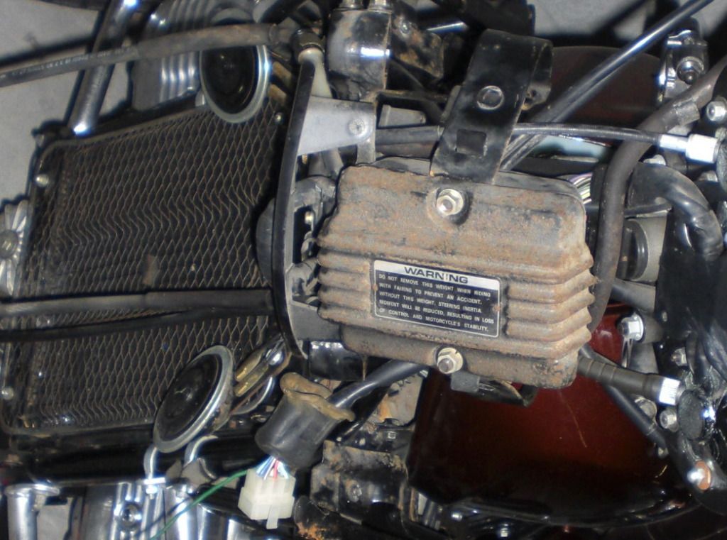

I had a low mileage Goldwing almost throw me off at about 90, I put it down to the screen vortex shedding.
The Goldwings had a heavy weight fitted to the steering column behind the headlight, I think it was to avoid tank slap
Ray B,
         Yes I did a few times but I was always nervous about it.
The bike was practically new when I sold it, about 4K miles
I found a picture of the weight, lets see if I can't post it.
Note the warning notice which says
WARNING
Do not remove this weight when riding with faring to prevent an accident
Without this weigh steering inertia moment will be reduced resulting in
loss of control and motorcycle stability
IMHO the California II of the same year is light years ahead of the Honda in the handling department.
The Honda on a bumpy sweeper was like riding a garden gate against the Guzzi riding on rails.
