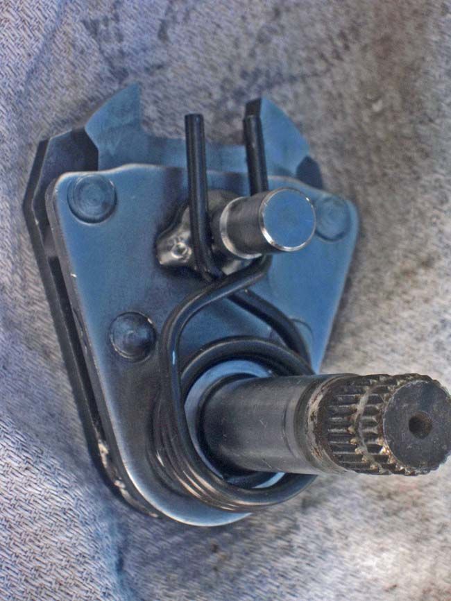

Online pehayes
  • Posts: 4746
    • Falcone Touring
Re: 1999 Moto Guzzi Bassa V11 shifter issues
« Reply #12 on: February 02, 2016, 12:53:41 PM »
This is your shift return spring installed onto the pre-selector.  One of the two 'arms' has snapped off about an inch or so and the piece is now laying in the bottom of your transmission.

Offline twhitaker
  • Posts: 8323
« Reply #13 on: February 02, 2016, 01:20:21 PM »
Some work involved getting to the rascal.

Offline normzone
  • Posts: 3150
  • Location: San Diego CA
« Reply #14 on: February 02, 2016, 01:28:57 PM »
Wow, I recognize that spring from my Eldo days.
